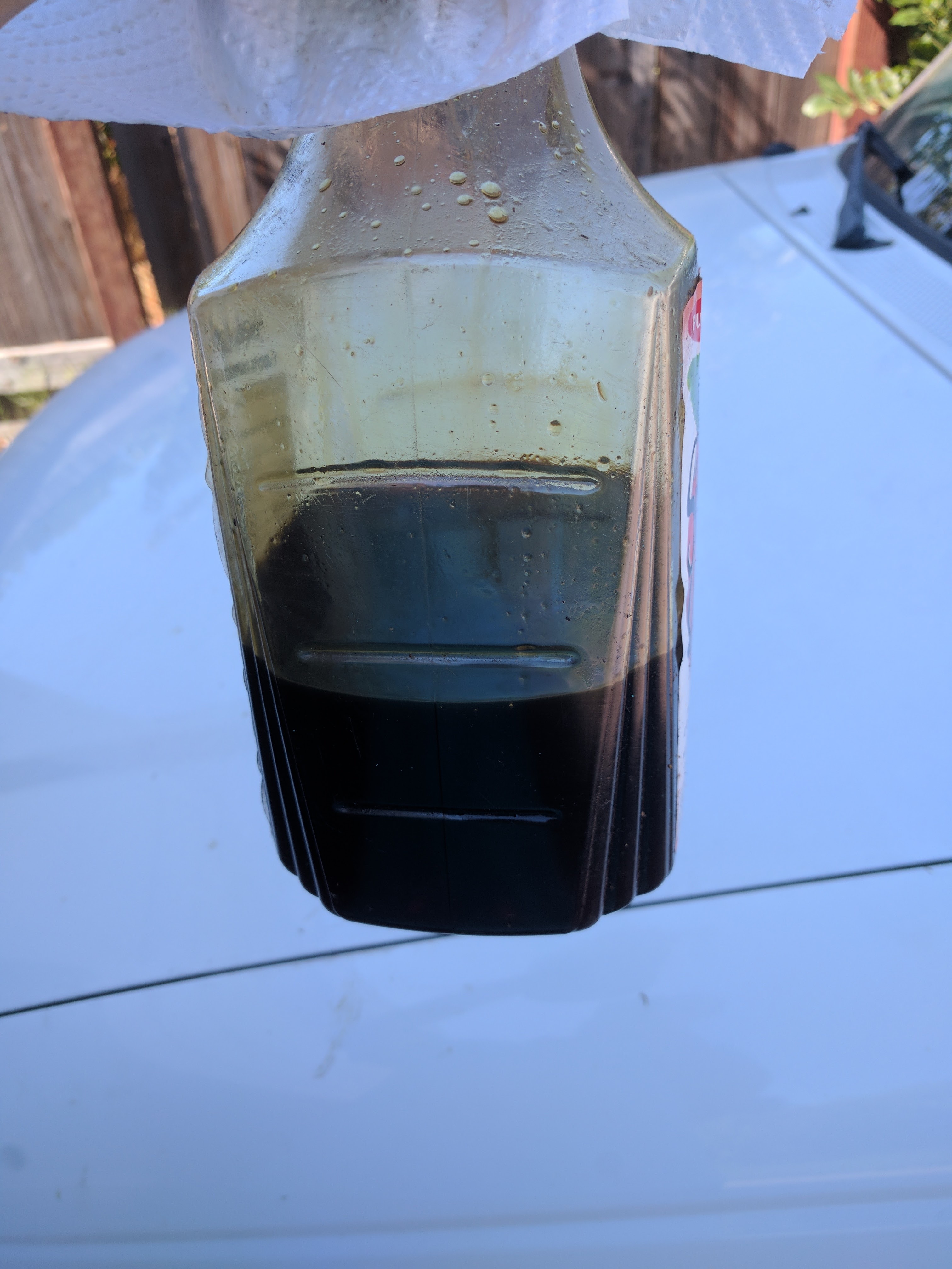

Flushed the brake fluid. Took almost 1 quart to get it all clean. Nasty stuff. See photo.
But alas no difference. There is nothing happening on the left side. The pressure is just sufficient to take the light surface rust off but nothing more than that.
