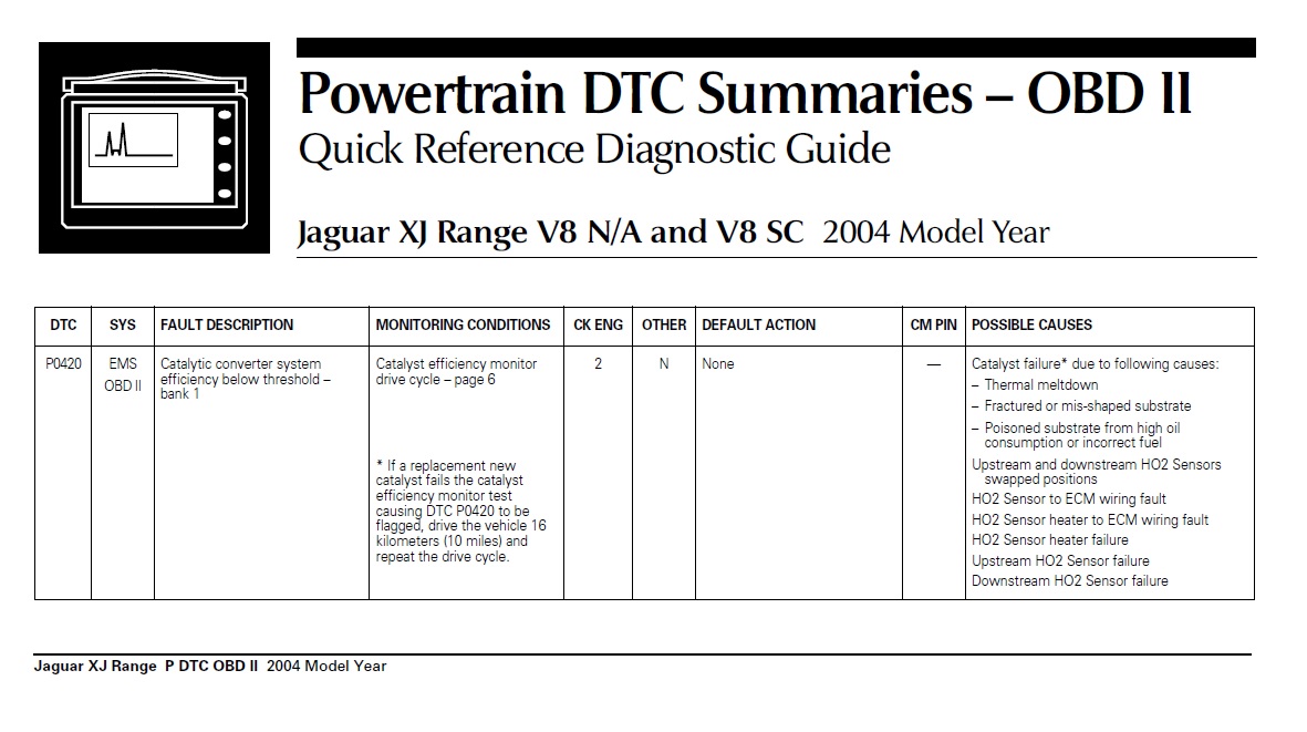

Unless the catalytic converter has had physical damage or contamination, it should easily outlast the HO2 sensors.
Here is the full extract from the Jaguar DTC listing for P0420:
The 'possible causes' are more likely to occur in reverse of the order shown.
With any emissions related error code, clearing and seeing if they repeat should be the initial approach before assuming the worst and immediately replacing parts. After all, the MIL is triggered by an out-of-range signal and this may just have peaked momentarily rather than being permanent.
After clearing P0420, the Efficiency Monitor Drive Cycle is the quickest way to check for a code repetition:
CATALYST EFFICIENCY MONITOR DRIVE CYCLE
1. Start engine and bring to normal operating temperature > 167 °F.
2. With the gear selector in Park or Neutral, hold the engine speed at 2500 rpm for 5 minutes.
3. Drive vehicle ensuring that vehicle speed exceeds 10 mph and engine speed exceeds 1500 rpm.
4. Stop the vehicle and check for any temporary DTCs.
At the end of this you could still have a permanent P0420 but will at least have satisfied yourself that expenditure on parts is absolutely necessary.
