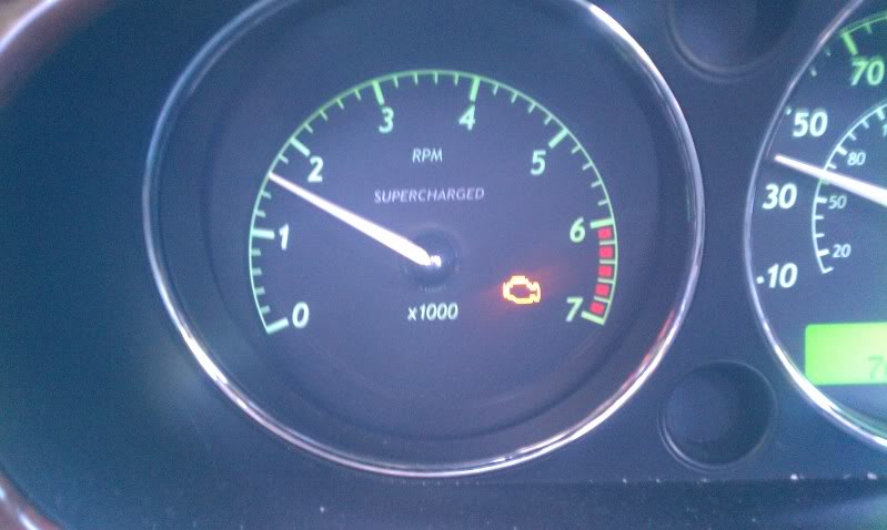

I was driving my 04 XJR saturday when I got a warning (red light) "coolant low".. I was hoping it was just a fluke from driving through the terrain I was going through (very winded roads) but I kept my eye on the temp gauge and about 4-5 mins later it worked it's way to H. I immediately pulled over and turned the car off. Luckily I was following a car full of friends so they let me jump in with them while we went to our destination. I returned and put water in the reservoir and drove it home.. just before I got home the coolant low light came on again! So I've got a leak somewhere. Well today I filled the reservoir again so I could drive it in for repairs. I noticed after filling the reservoir that it was leaking from somewhere immediately and this was with the car off so hoping this is a good sign that there is not a problem with the engine but with something else. I had filled up enough water that it lasted until right before the repair shop before the coolant low light came on so I made it just in time. Along the way however I noticed a warning light I had not seen on the other day when it overheated. Anybody know what this light means? And should I be worried that something else has been damaged by driving to the repair shop with just water in the radiator/reservoir?

That is the "check engine" light and lights up for a multiple of reasons. Reading codes should sort out what caused it. Probably isn't a problem as you allowed that engine to cool between drives.

Interesting you took the picture while driving! Lol.
Hahaha, I was wondering why your idle was so high, but then I saw your speedo was also at 30 mph!
