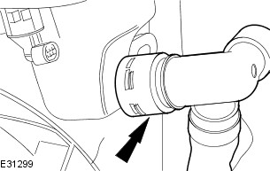

The O ring probably comes with the connector and I am guessing the connector comes with the
hose.The O ring may be missing on your jag.

Hi Mark

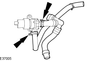

I'm assuming that you mean the lower hose pictured below? There are 2 O-rings inside this end where it connects to the tank. You can't get them separately from Jaguar, you would have to source them locally.
This hose connects to the Auxiliary coolant pump. Only other option would be to replace the hose pictured below. The one the top arrow is pointing.
