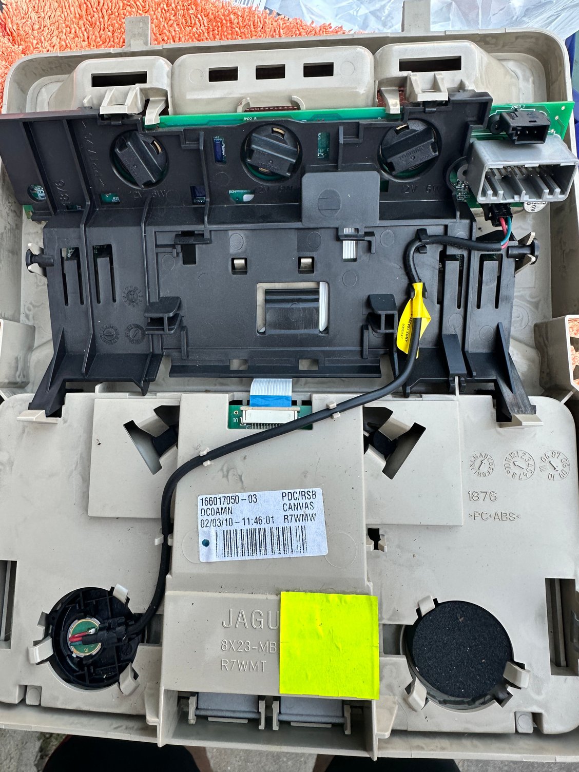

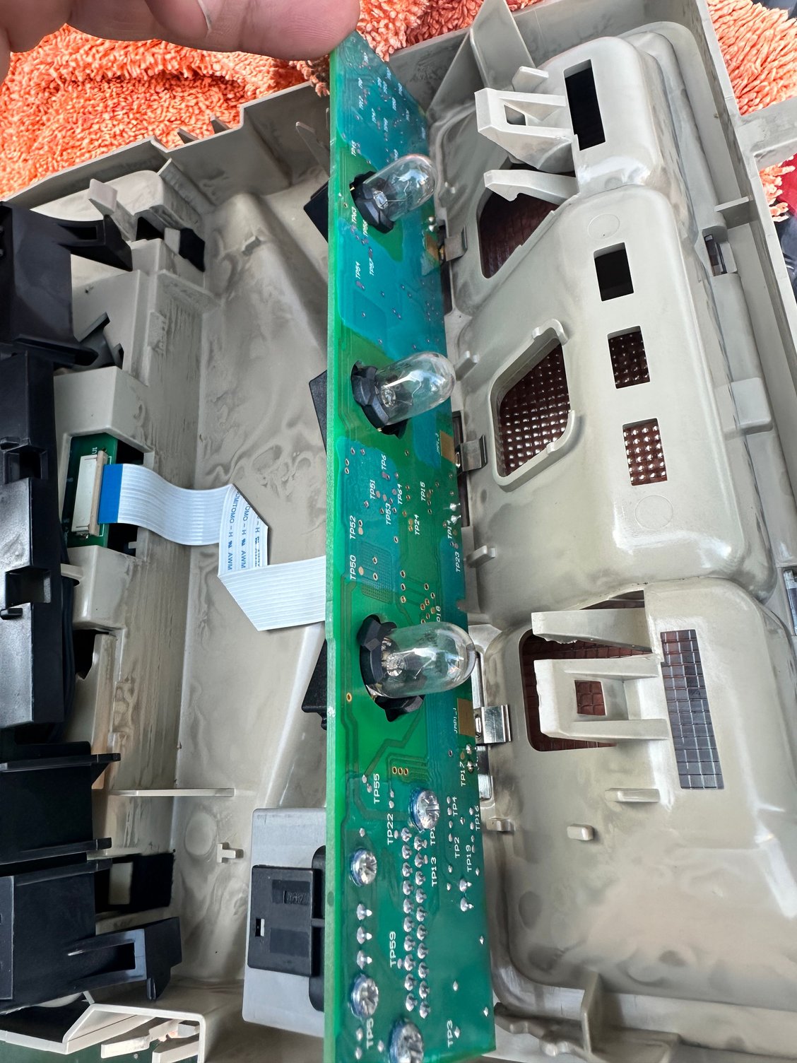

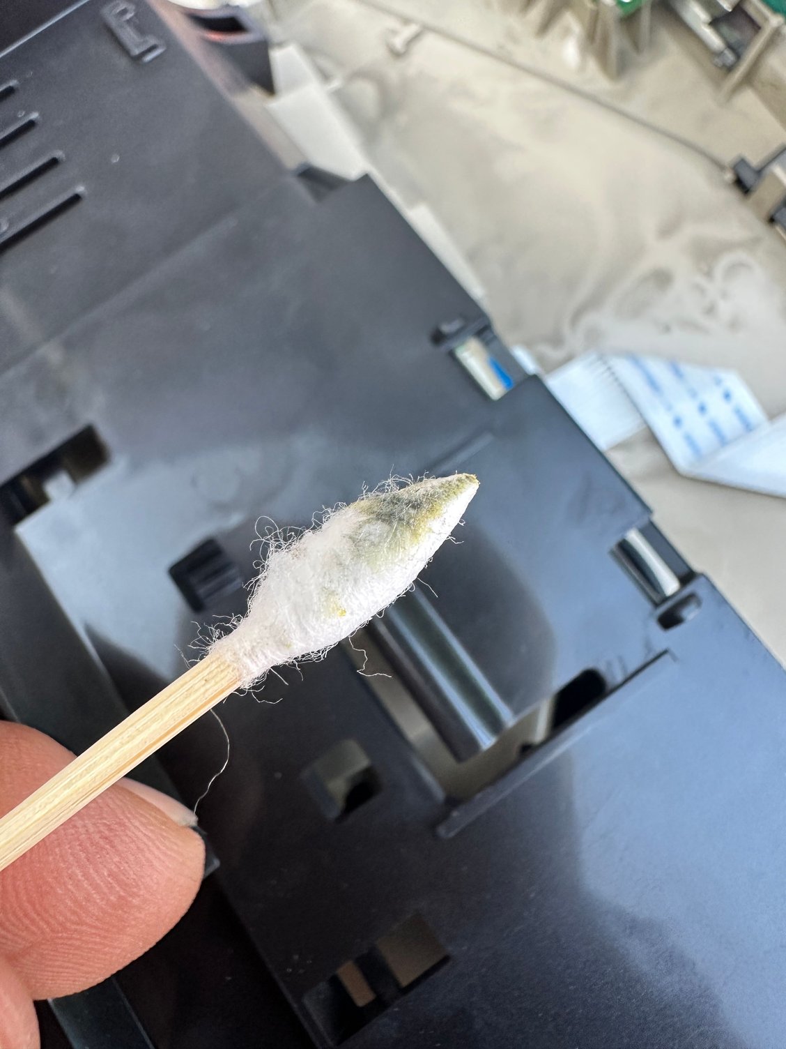

I have x351
Did the interior light clean up and copper paste
Tobe precise, on my x351, the interior light and footwell and trunk ware flickering randomly.
ALSO, they ware turning randomly auto on, of interior lights!
Just.… randomly, stationary but the car was awake, in iddle, during driveing day and night!
Successive flickers…..! Any idea what to check more? And where? I also cleaned the connecting plug for the roof unit control. Une plug, contact cleaner on both ends!
I suppose, that because it not only started the light but also turned on and off the auto lights, it was that master switch in the front of the car. But.… could be something else?
