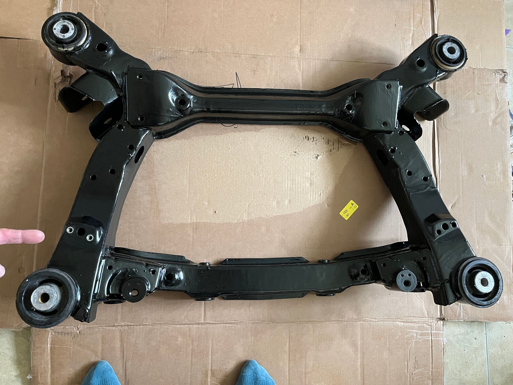

Just for the record in case anyone else has the same issue I chose to buy one on Ebay from Nomaautoparts based in Texas having had previous good experience of dry state cars and parts. It was for a 4.2 supercharged model but I reasoned the block is the same as my 4.2 NA. The cost was $250 and shipping $300. It was shipped in a custom box by Fedex and arrived in 4 days which I thought stunning ( despite weighing 25Kg flown to Stansted from their US shipping depot) VAT, duty and handling was then a separate £92* or so billed by Fedex directly. Expecting it to be a bit oily and showing some signs of age I was astonished to find an effectively new item. Fully degreased and with original paint intact on all but a few edges it was all I could have hoped for and more. Sandblasting therefore seemed unnecessary but I wiped a gain rather unnecessarily firstly with ethanol and then naphtha.
Rather than repaint or powdercoat I used Rustbuster's Armaguard Epoxy Mastic on recommendation, I simply abraded the existing paint with sandpaper and brushed on. I'm delighted with the result. The paint is astonishing, curing overnight to a very good ( robust not necessarily concours) dry-to-the-touch finish and then hardening further for 4 days thereafter. My purchase of a I litre kit was ideal. I didnt bother changing the bushes as they looked fine - probably a bit stiffer than new but certainly not oil-rotted.
I'll be back to Noma replace the rear one in due course and I suspect those on my X150 too.
Peter's points above about centering and the purchase of new "one time use" stretch bolts are of course well made
*At the time of writing Trump's subsequent tariffs might have changed some of that but probably not materially.
The painted item.  Note rivets on the one side not the other
