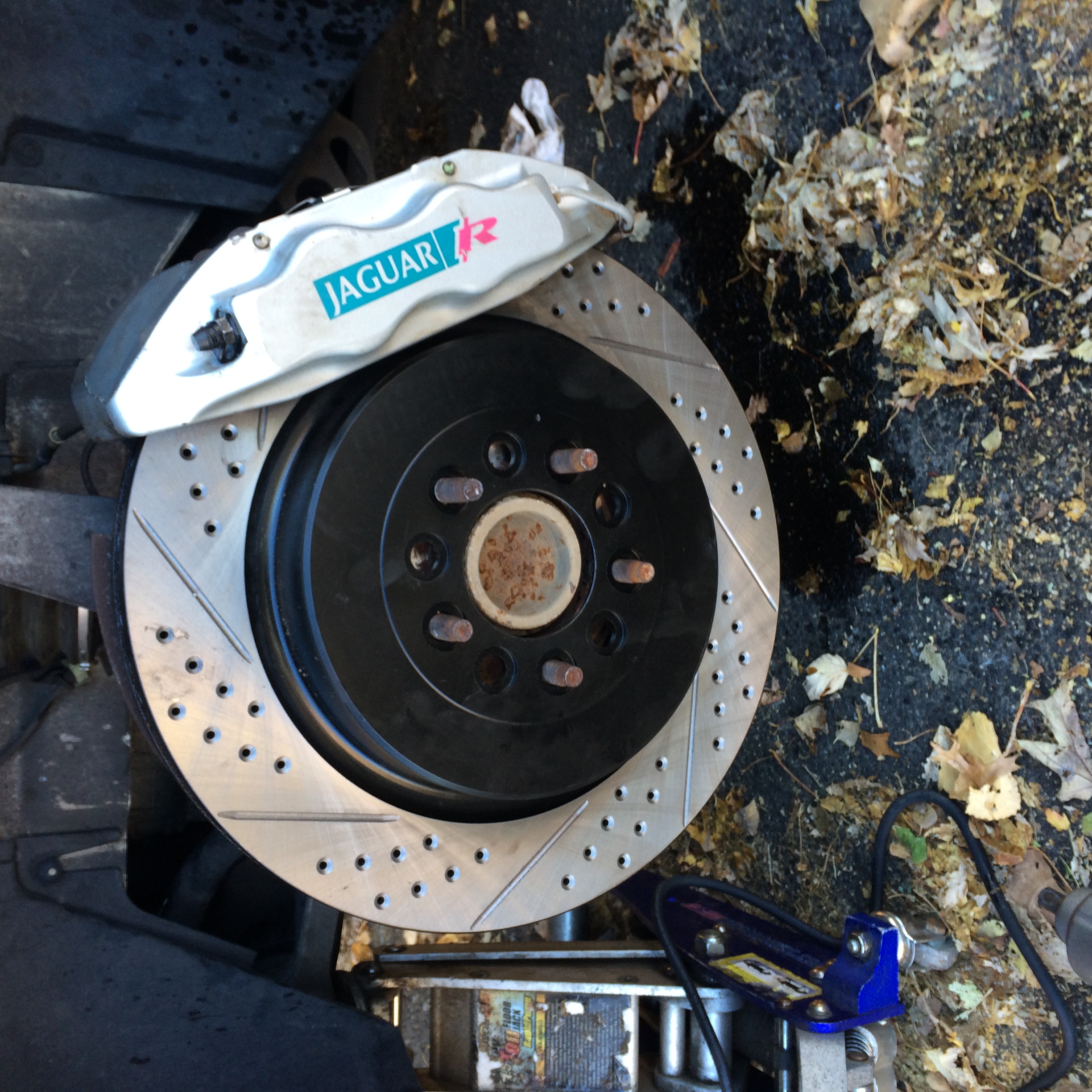

Wellllllllllllllllllllllllllllllllllllllllllllllll lllllll I'll likely make another post however.......See anything interesting!!!!!
