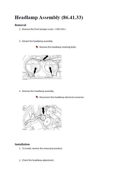

Tomorrow i have somebody change my complete headlight on the Driver side of my late X350 {he is not known with Jags }
Anybody did this ? does he have to remove the front bumper ,and more things to look at
any step by step or info is welcome

According to the Workshop Manual section on headlamp removal, the front bumper cover has to be removed.
Procedure for bumper cover removal vary with VIN range. Before or after H18680.

The frontbumper cover has to be removed with my car ,that was the thing that nothing breaks and how to remove the frontbumper cover
thanks
