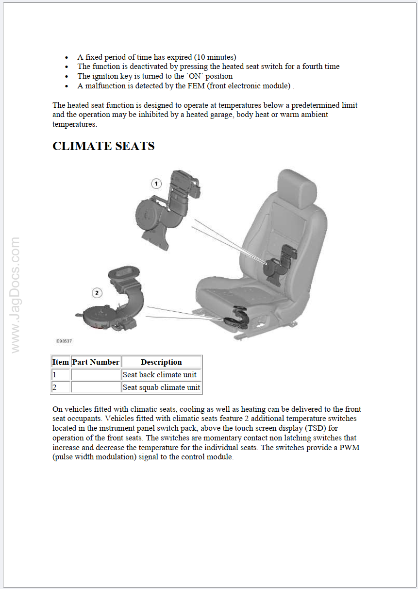

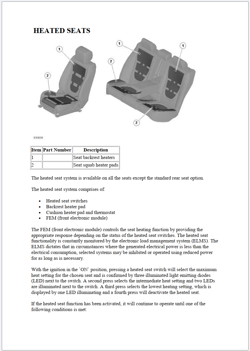

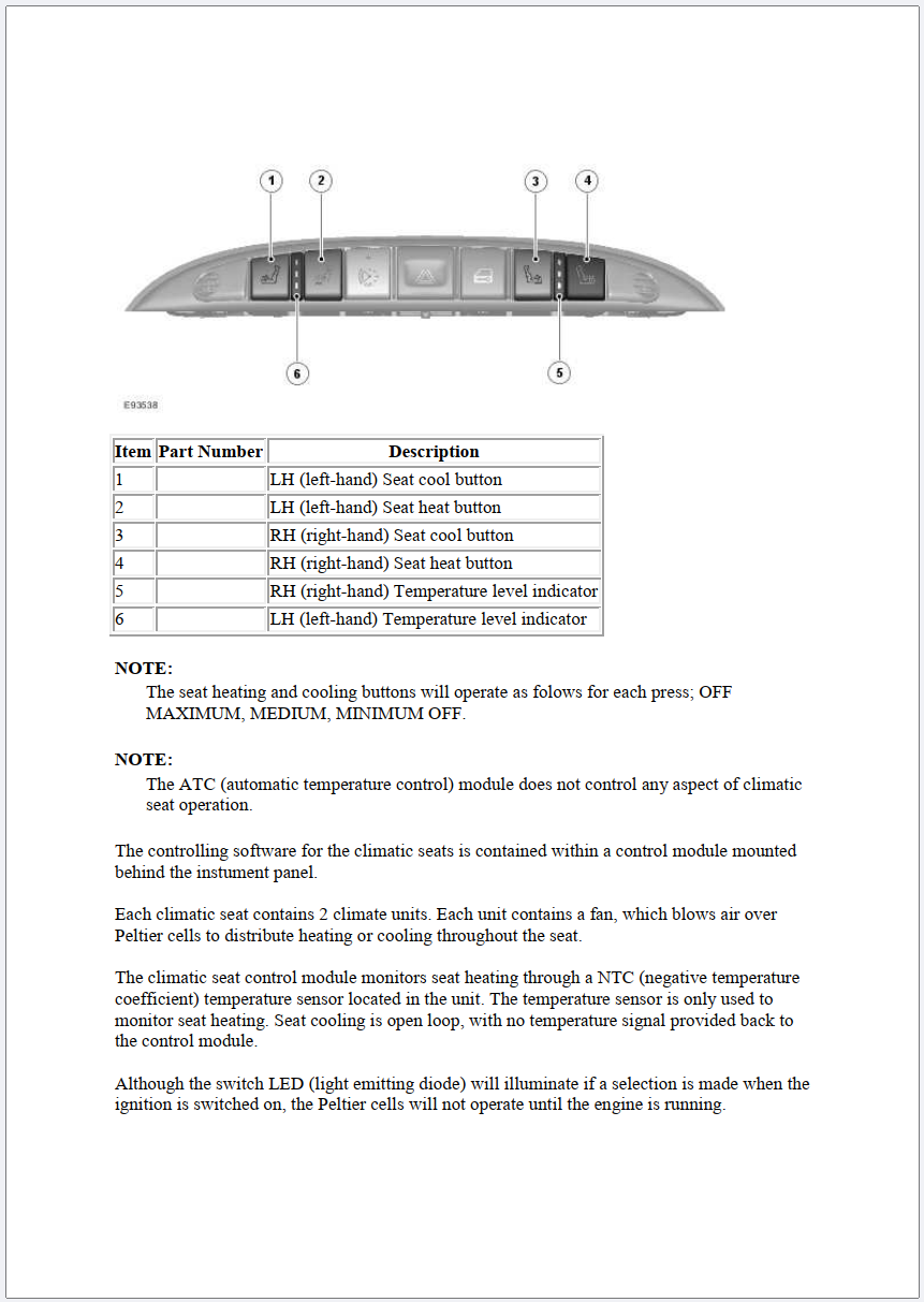

When your a car does have the "Climate seats" does it still have the "Heated seats?"
I've assumed so, but now I realized the heating pads would be kinda redundant:
Each climatic seat contains 2 climate units. Each unit contains a fan, which blows air over Peltier cells to distribute heating or cooling throughout the seat.

I wouod say that you have already answered your question by yourself...

I have climate seats, and always thought they were cooling only. I learned something new today.
