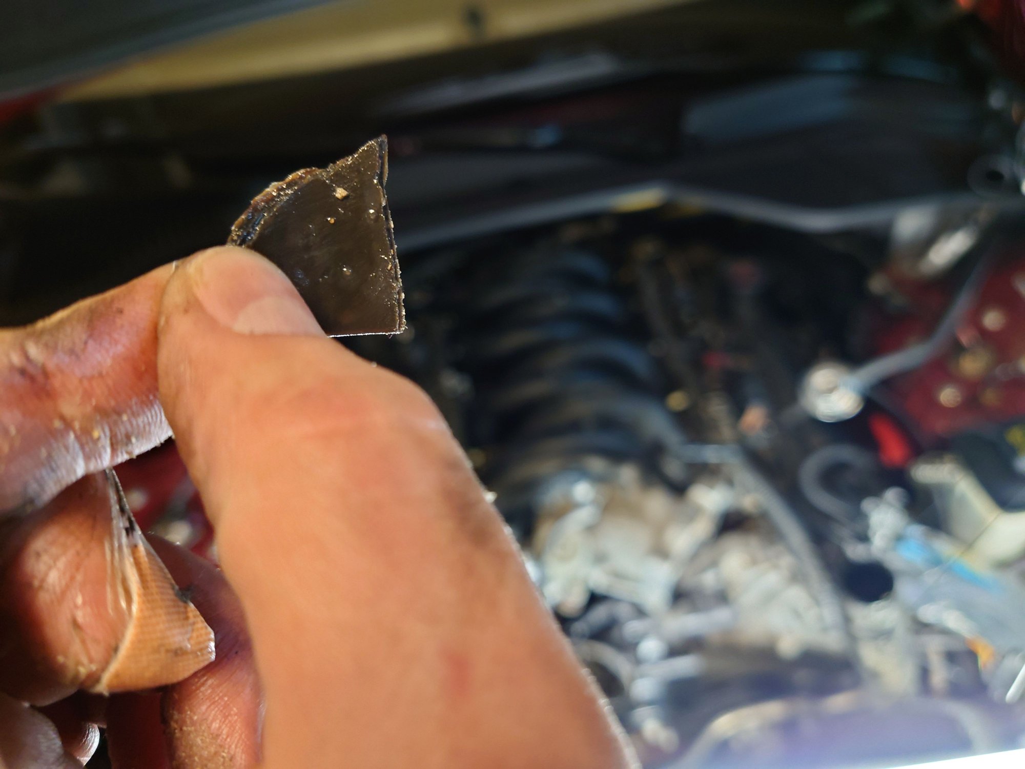

Thanks for all the feedback guys, sorry I have been silent been waiting on parts!
So here is the lowdown....ALL FIXED!!!
The heating issue was 100% a craked crappy thermostat housing....What a pain to get off and on again...Anyway 5 hours and some scraped knuckles later, I replaced the whole plastic assembly that houses the thermostat and also the water pump while I was in there. Just took it for a good run and no overheating whatsoever, for sure it was a piece of plastic interfearing with the thermostat.
Piece of the broken pipe inside the thermostat housing

Congrats on getting her back on the road. I had to do the same repair on my 2004 X350 over the weekend. It has 137K miles on it and it's owner had died and been sitting for a while. I bought it this past November and slowly working out the gremlins.

Wow Gregory! Sounds exactly like mine, bought it off of a widdow! Mine only has 108k Kilometers (67000 miles).
