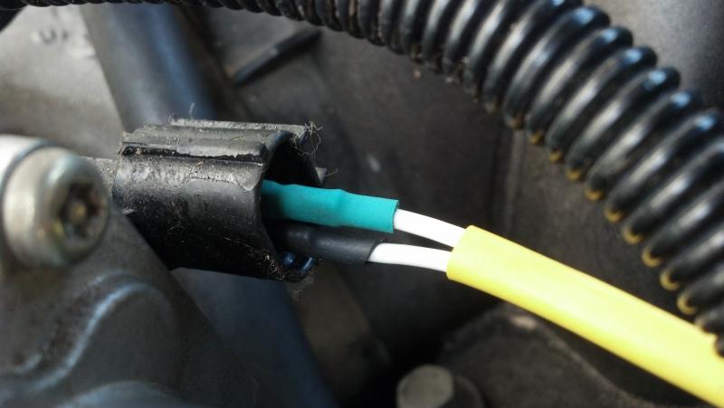

Here is the new wiring. (attached photos)
Tell me what ya'll think.
There is one thing I know I need to do. I need to make something to protect the connection at the throttle body, where the green and black connectors are, to protect against moisture and corrosion.
Besides that one last mod, that is my custom harness/wiring.
As you can see, I cut the old wires off where the Throttle body wires meet at the large conduit at the engine wiring harness.
I used 9" of silver wire. Its just copper wire plated in silver.
That wire has Teflon insulation, figuring it will protect my wiring from all the heat.
The female pins I used are gold plated. k-s 5 16-14 gauge female connector.
I soldered the wires to the connectors, NOT CRIMPED (Important)
The heat shrink is generic.
Then, I soldered the wires to the wiring harness, each wire soldered side by side, NO SPLICING OR BUTT CONNECTOR.
Using butt connectors, splicing, and crimping all adds resistance. I engineered these wires, researching and using the best materials, to ensure the least bit of resistance, and best connectivity.

wiring and text look good to me

Understand that condensation is an issue and positive connection is critical. Think about the cannon plugs used on aircraft they are sealed with an “O” ring, fitted tightly and locked into place with safety wire. You may have solved your problem for now but if it comes back you know where to look.

I hear ya. On the corrosion thing, being that those connectors are exposed,
they are gold plated. They will resist some corrosion for a little while. I am probably going to use a series of shrink wrap, build the layers up, making a rubber gasket.
Then, I will probably use a larger piece of wrap and shrink it around the connector on the TB itself. This will work, it will just make it difficult to remove and re-connect the wires if need-be.

That sounds good. As a side note see if you can track down a power company employee and see if he has a short roll of Scotch 130C tape that is used on underground cable that he can give to you. That tape once it is stretched a little it will bond each layer to itself resulting in a water proof connection/area. Cover it with a little electrical tape and you are good to go.

Cool Day 3
Today is day 3, post wiring repair.
Me and the Jag went for a ride today. All was well.
Very responsive.
Running great.
I was filling a little shimmy in idle from the engine. Maybe related to the fact that I accidentally ripped of the resonator on my intake hose and sealed the hole for it. So, the airflow through the intake is uninterrupted. I will fix the resonator when time permits.
Just reporting that the Ole Jag is doing fine after her operation.
