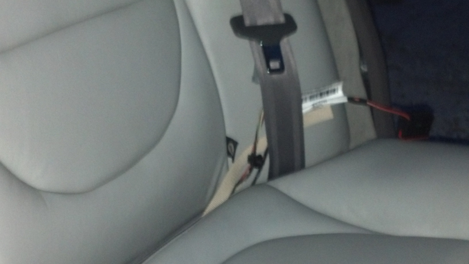

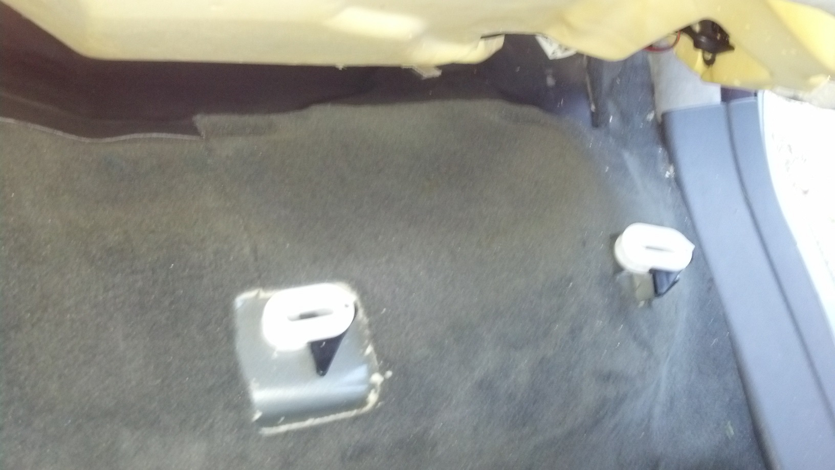

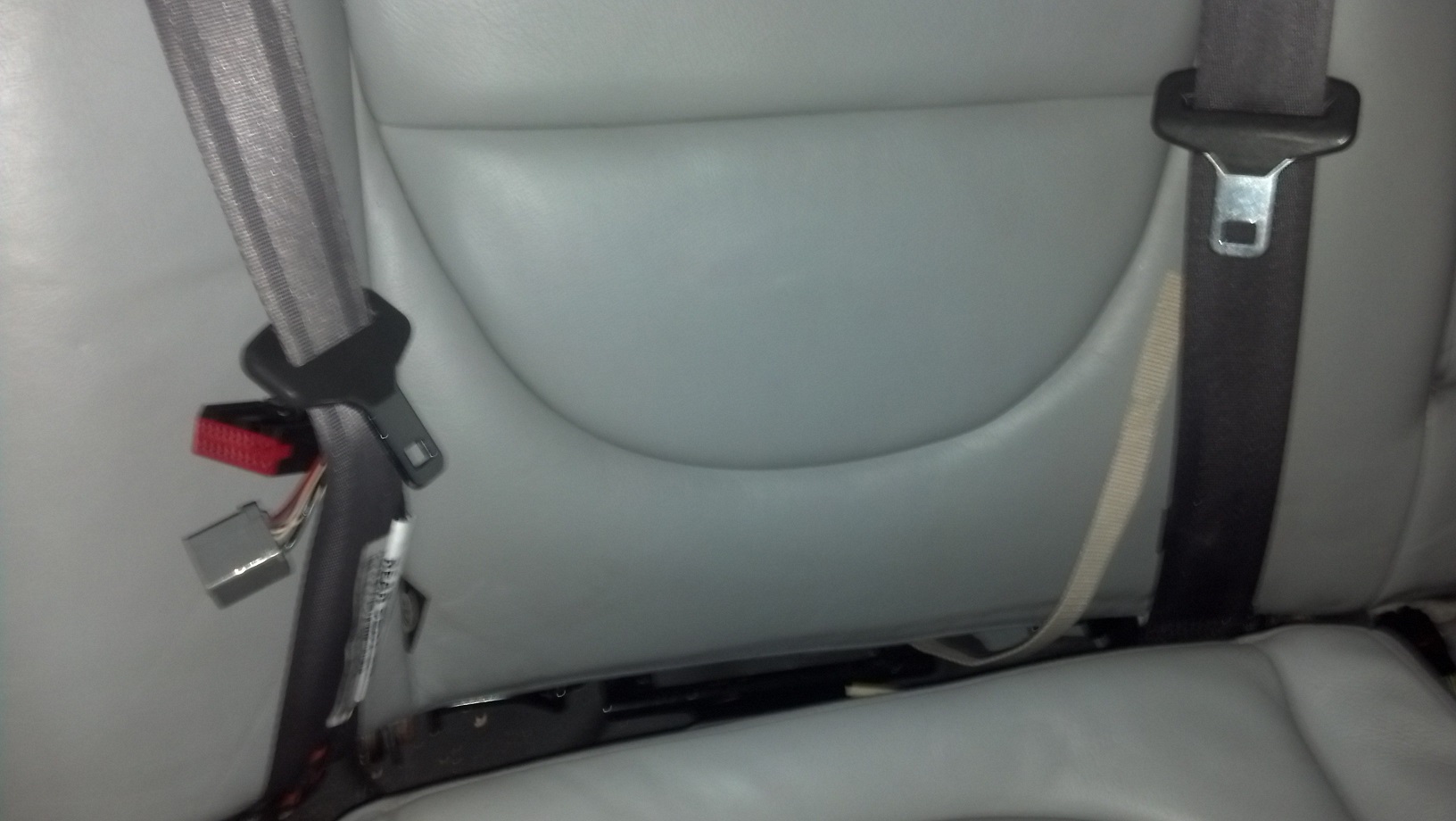

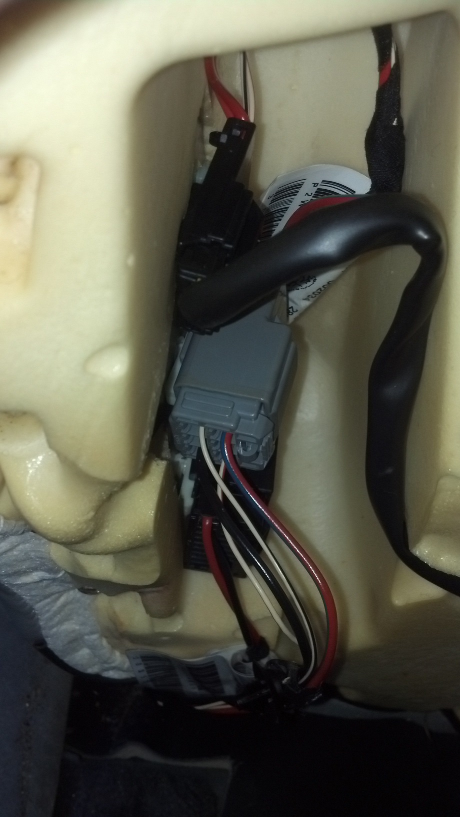

A few pics with arrows would be handy. I am about to tackle this. If I can, I will try to provide those as well. Thanks for the info!
Just finished. Here's some pics. A couple are a little blurry, but I was getting tired and my phone was wobbling., the moon was in my eyes, etc... lol I added a couple of the wires and straps being retained by the seat belts when I was reassembling. Some are of the bottom of the seat and the wiring harnesses that need to be disconnected from each side on the seat bottom. Anyway, here they are...

Another Tip for the seat base removal
Start with one side and do the outer catch first
Do this standing outside the car!!!
When you release the first clip put the handle on a screwdriver under the seat base to stop it re-latching
Now do the next one working you way toward the other side
Have done mine now too many times and once you get the hange of it you can have the seat base and back out in a few minutes

EXCELLENT point. I tried that too, but it seemed like it was still relatchng over and over again. So, I decided to take a different route. I moved the front seats all the way forward and used one knee to keep the first side propped up a little bit so it didn't relatch while I worked on the other side. Just another way.
