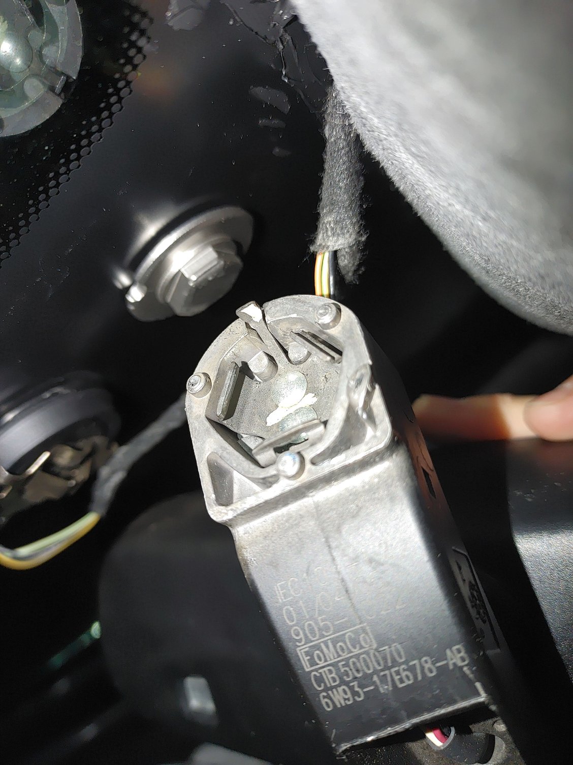

I just did this job last night. You don't need to push or pry on anything, just twisting. To remove the mirror, remove the plastic cover, then rotate the base ~45 degrees counter-clockwise.
To re-install, slot the mirror over the hex nut ~45 degrees to the left, then rotate clockwise ~45 degrees to lock the base on.
I was confused for a bit, but how it goes on/off makes sense once you see a picture of the lock and nut assembly.
