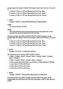

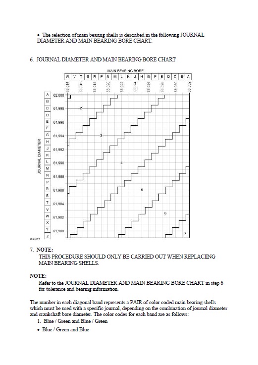

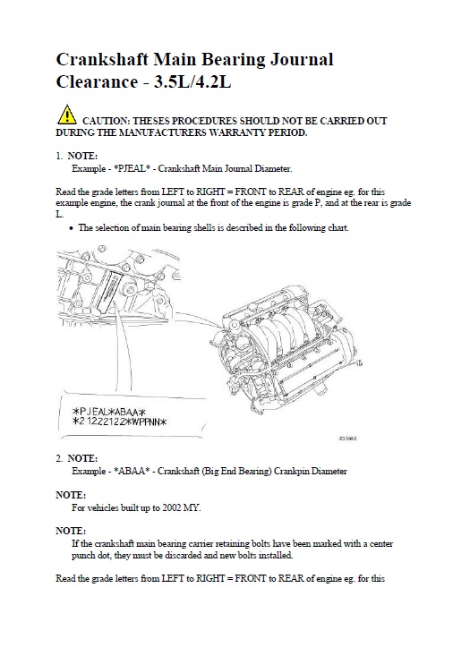

This extract from the X350 Workshop Manual may help explain the coding and bearing colour selection:
(click on the images to enlarge them)
You didn't mention Model Year or engine size so I've had to make some assumptions.
