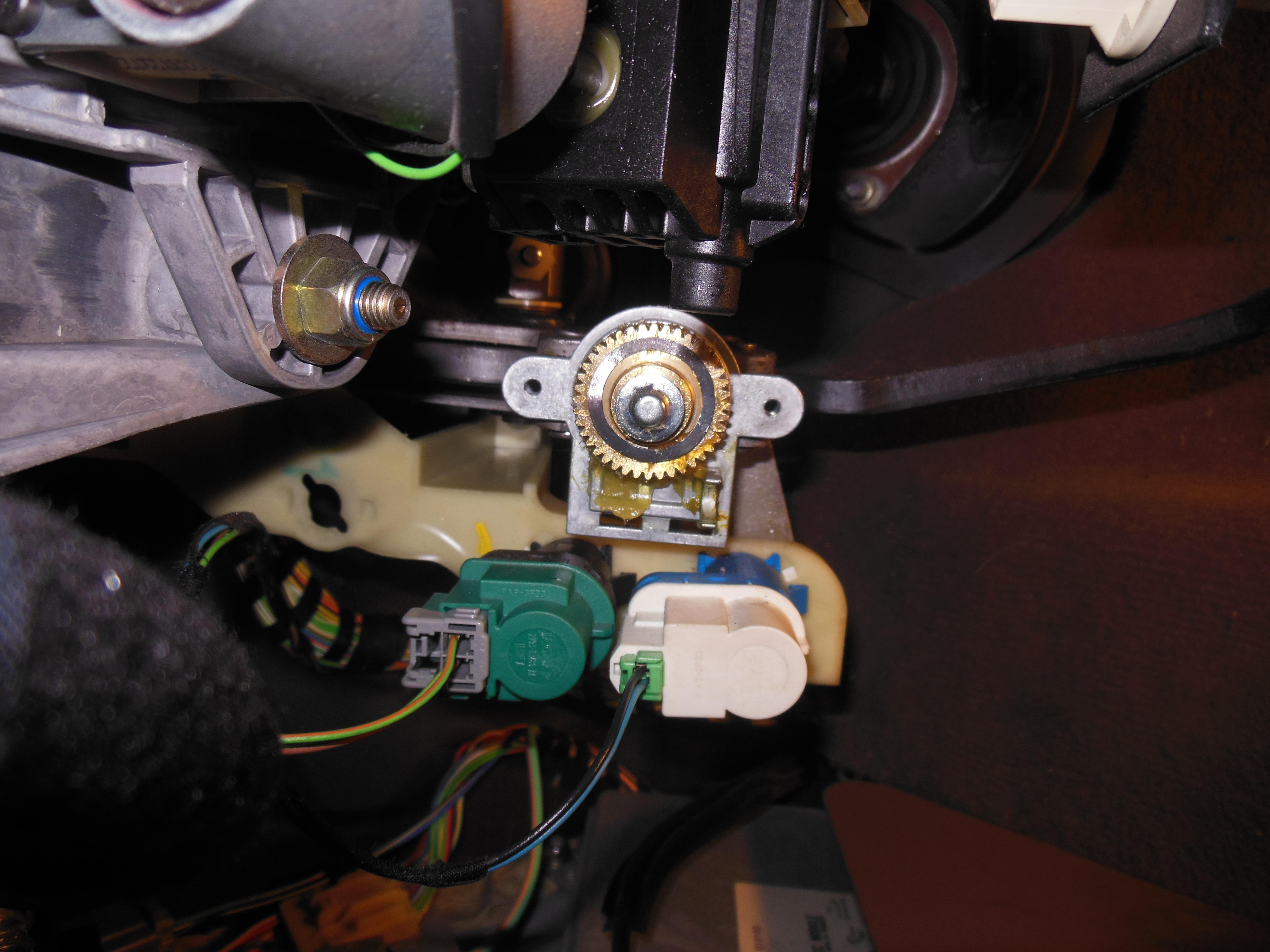

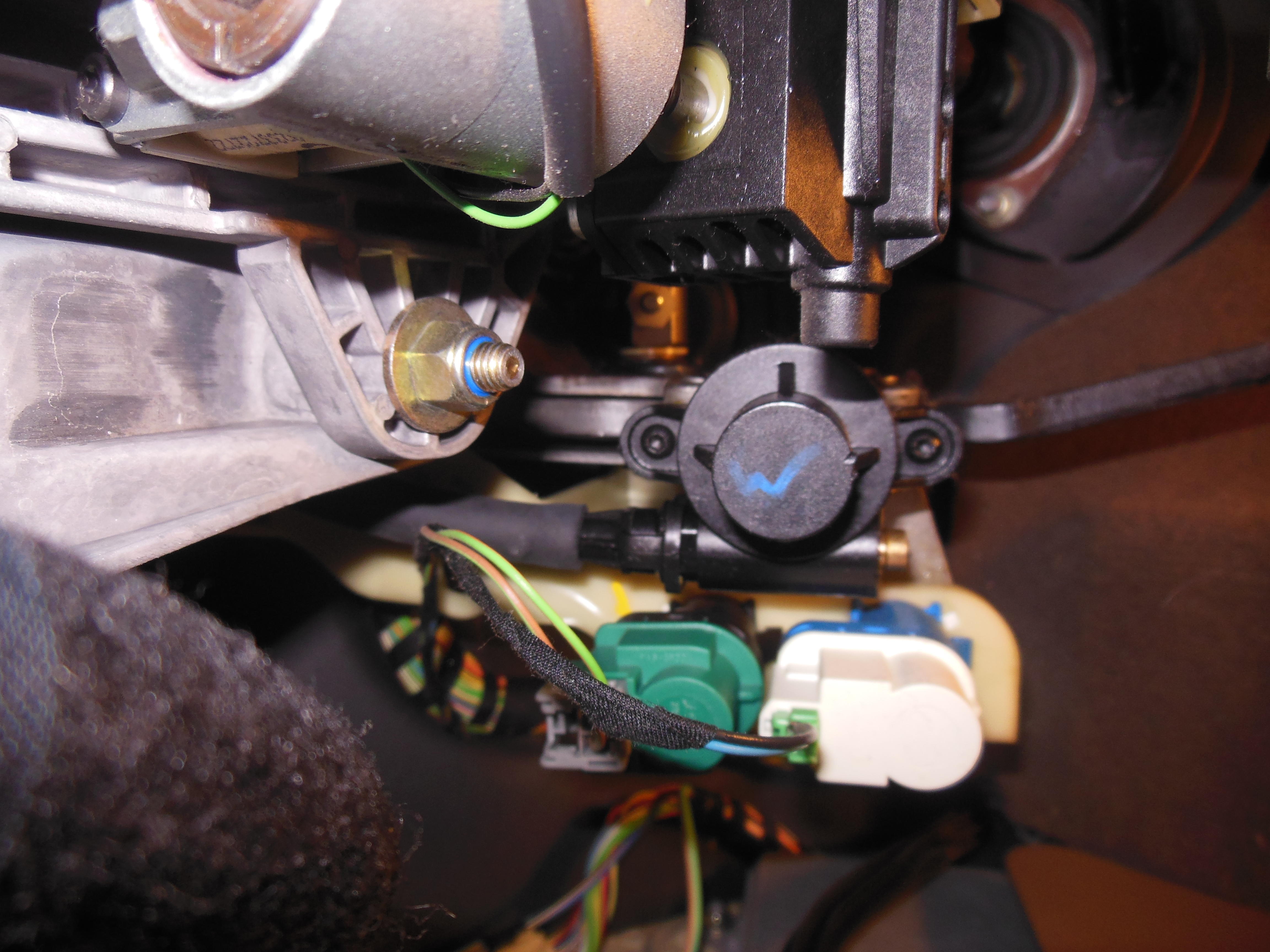

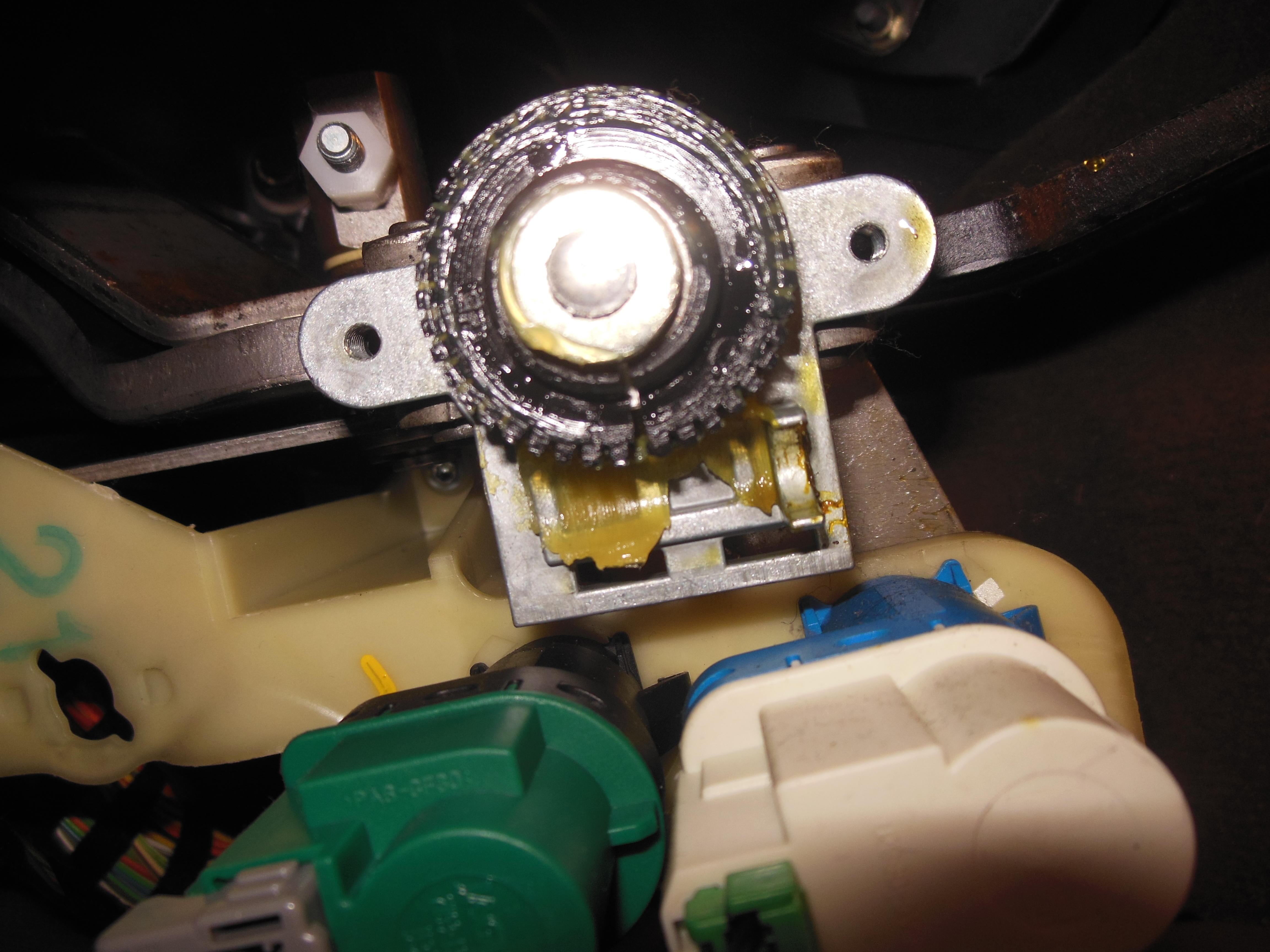

Default Instructions on how to repair your adjustable pedalsHad a chance to install a new gear on an XJ8 so I thought I'd write up how to do it.
1. remove the cover under the dash that covers the pedals up. (this car had it removed already)
2. Remove the four bolts holding the steering column cover on.
3. Remove the two T-20 Torx bolts that hold the black cover on the brake pedal assembly.
4. Grasp the cover, gently pull it off revealing the gears inside. There is a black wave washer that may or may not fall off. Save this washer as it will be used later.
5. The center of the shaft has a small nub on it that secures the washer in front of the gear. This nub must be ground off in order to remove the gear. You can use a file or a rotary grinder to remove just enough metal to expose the washer and center shaft.
6. Grab the gear and twist it counter clockwise, as it pushes against the washer it will tighten up, you may wish to use a rag to keep your hand from getting sore but keep twisting the gear it will push the washer off and then you can remove the gear.
7. Put a dab of grease on the inside and outside of the gear, install the gear onto the shaft.
8. Set the steel cap (provided with the gear) onto the end of the shaft, smack it with a hammer to install it.
9. Smear some grease onto the flat face of the gear, then place the wave washer from earlier into grease.
10. Now snap the black plastic cover back onto the assembly.
11. Re install the two T-20 bolts
12. Re install the steering column cover and the dust shield from below.
