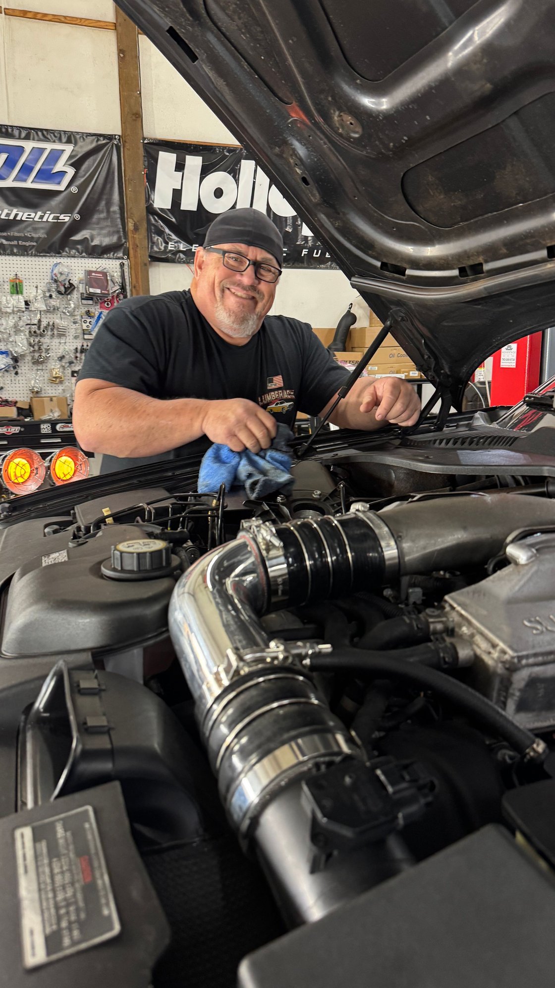

I most definitely removed the garbage plastic atrocity air intake, sourcing some 3" mandrel bent aluminum polished tube on Amazon for $15 and a 3/8" aluminum weld-on bung for $2.00 with a pair of Diesel Truck Silicon 3.15" hose couplers with the clamps for another $20 Amazon... to make a really sweet looking Air intake!!

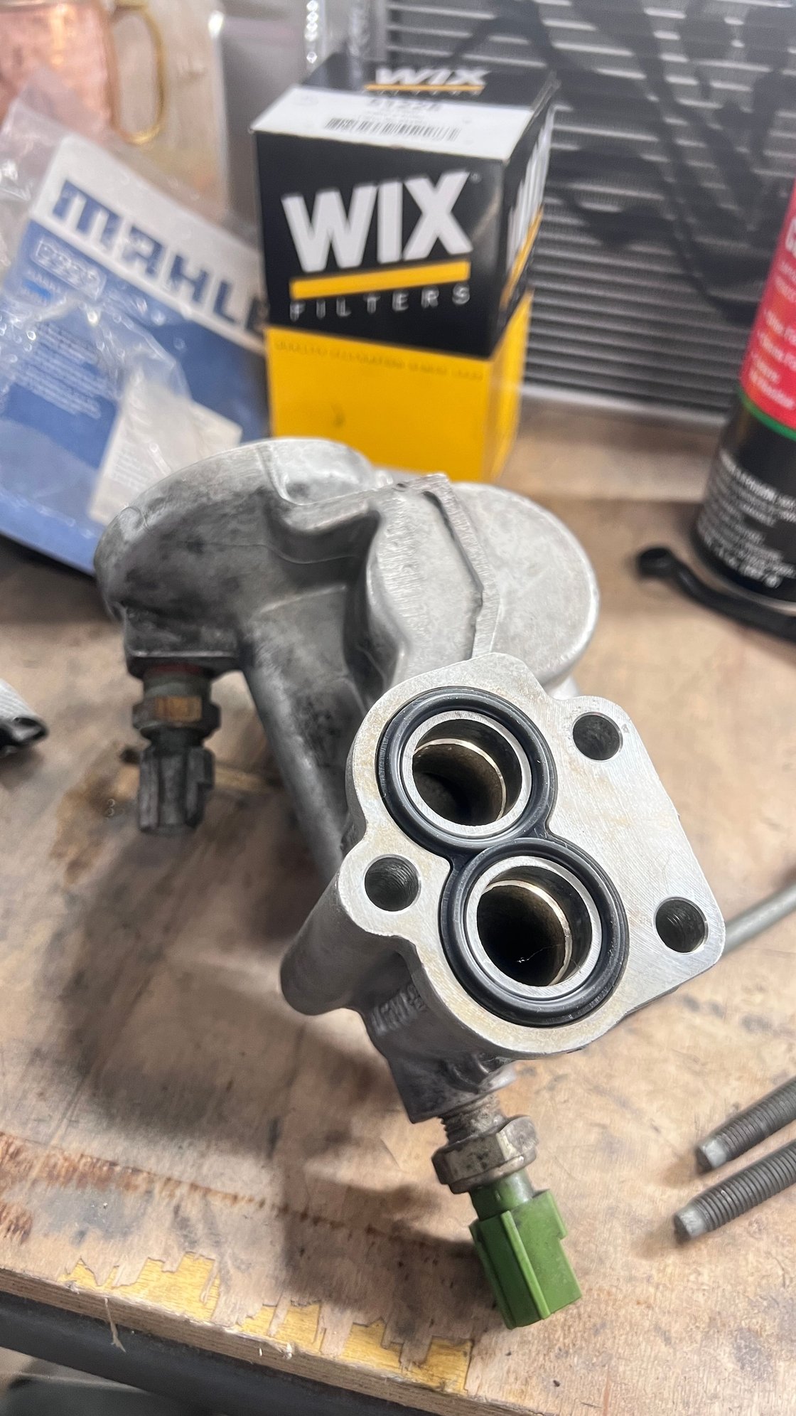

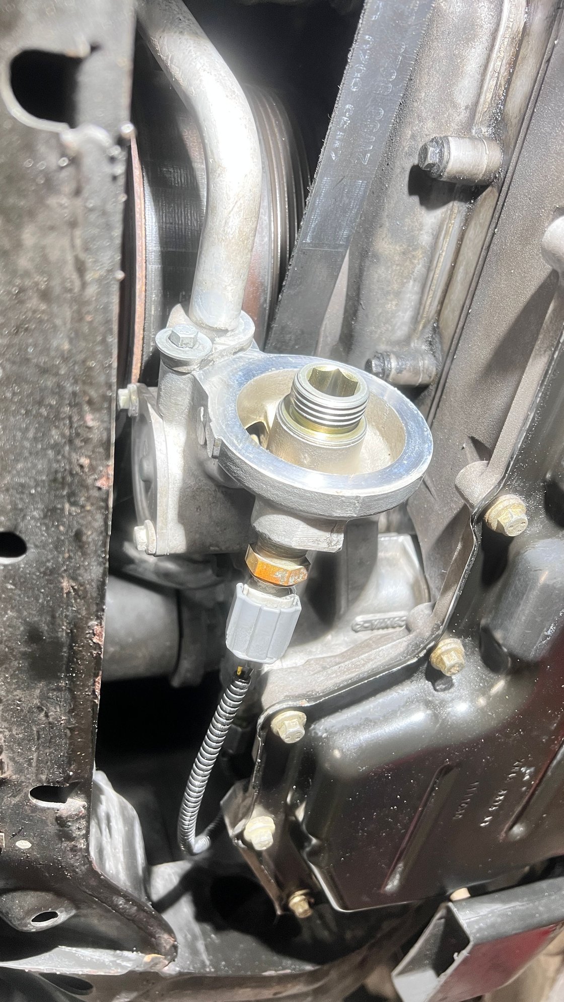

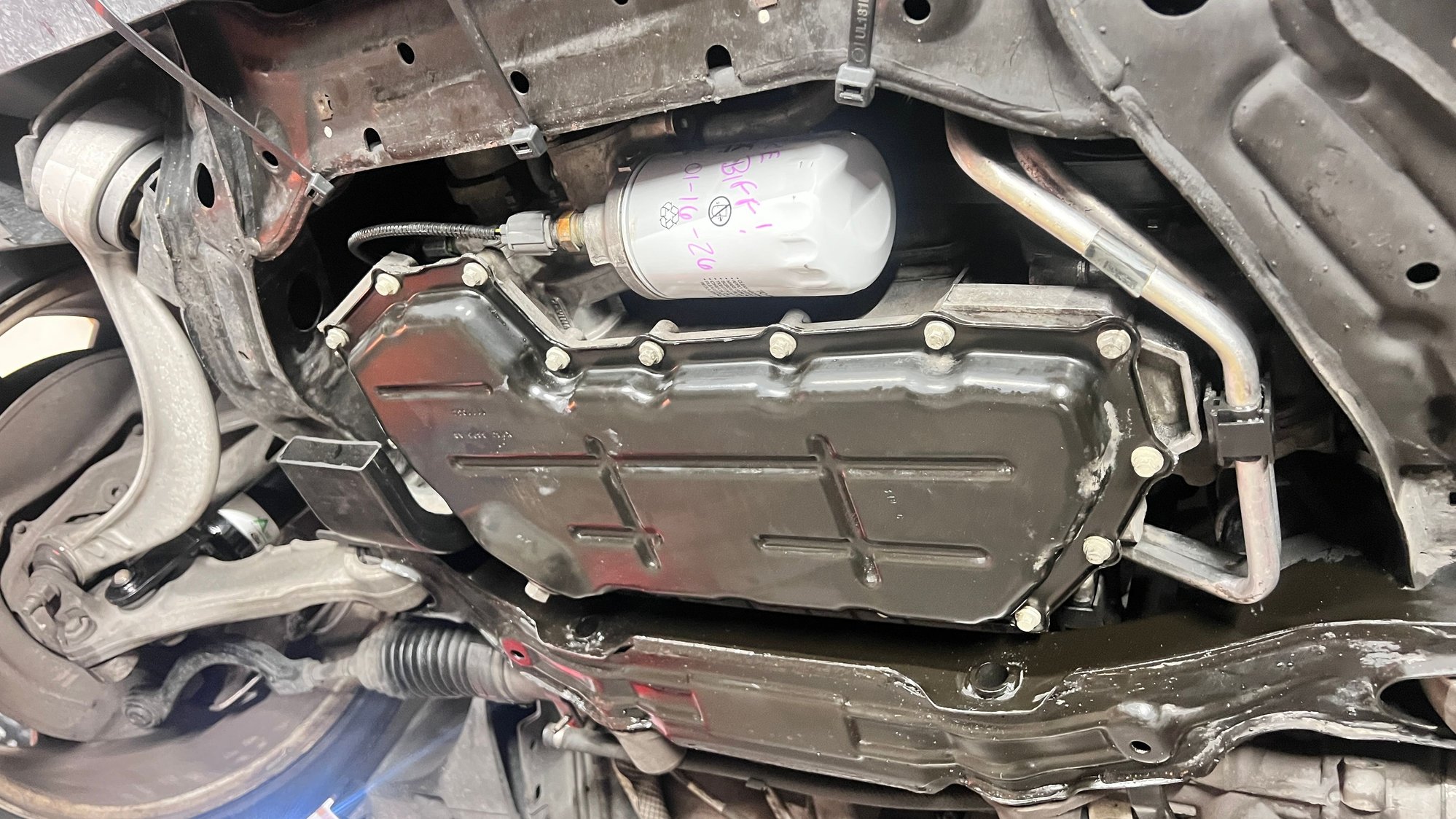

Oh but the oil leak!! Thanks again for this Forum to share a $6.00 part I can find at www.Autohauz.com along with the proper Oil Pan Gasket has me leak free!!! I apologize for not making a video about the true trick to getting these parts removed, but I promise you having a flexible head ratcheting wrench is the key!! I only needed to remove the lower panel and take the time to make it all clean before reinstalling.

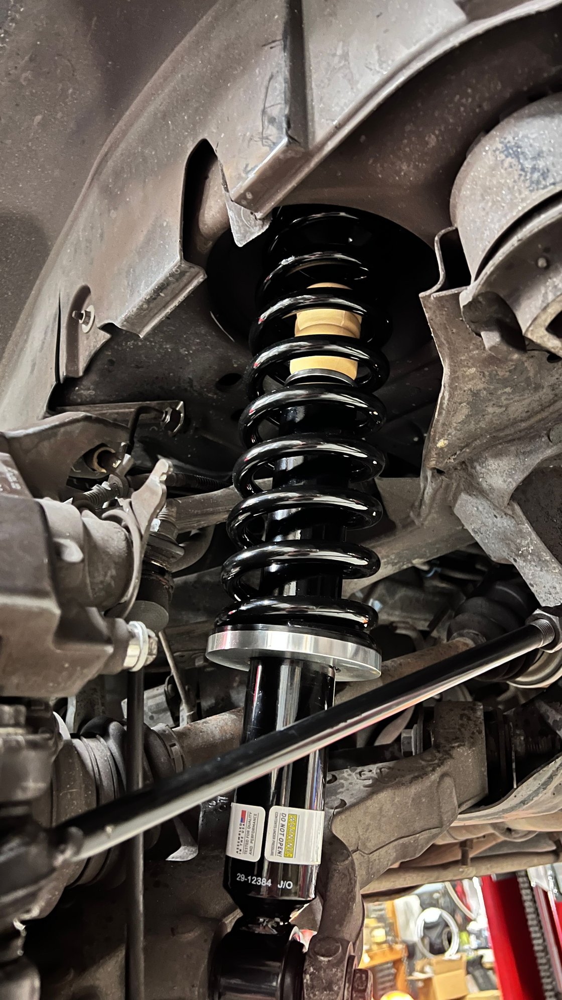

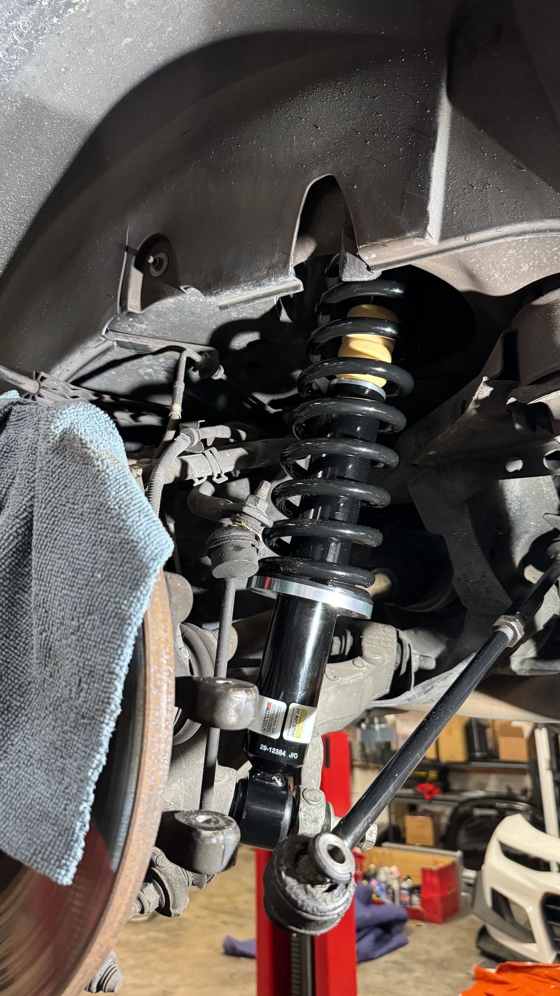

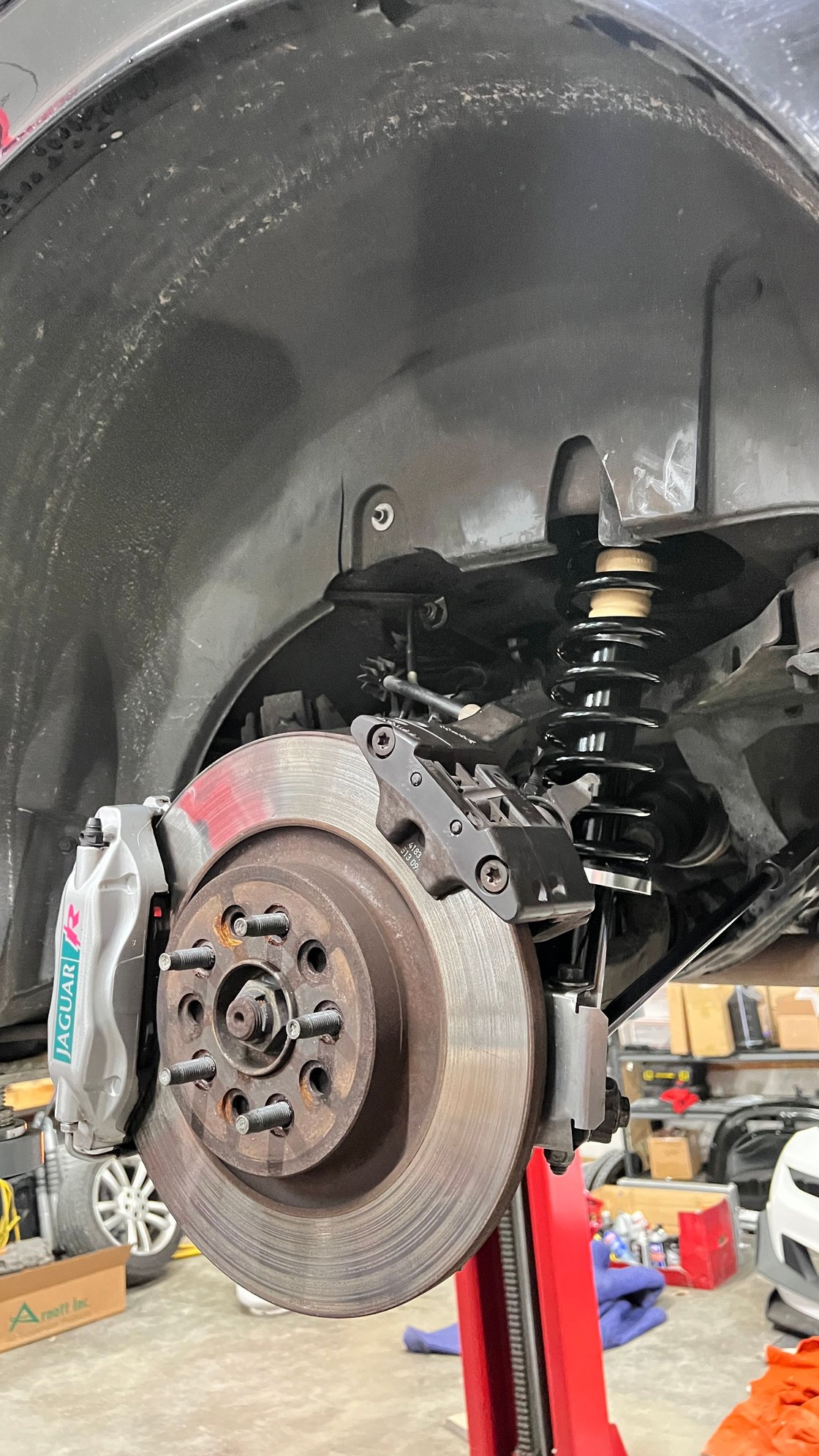

Lets get to the air ride... UGH!! When I first saw the Coilovers, being a racer and car builder and noting they were built with Eibach springs I'll admit ai was a little excited to put them on the car. This is where I found that all the previous suspension replacement parts dating as recent as 2017 for the front control arms were torqued by a Toddler. The brand new Brembo branded brake pads were placed into calipers that were literally finger tight. So... into the removal of the air suspension I commenced action. The instructions for the removal of the rear seat were a joke... thanks to my being a YouTube Certified Master Technician in both Diesel and Gas vehicles, the rear seat came out with no further issues! The wire taps for the air suspension controller snapped as should and I never saw any failure of the CATS system on the info screen.
WELL... it sucks! Wait.... a sec. Why do we refer to things that SUCK as being something bad...? Why is that? If my vacuum doesn't suck, its broken... right???
I was looking forward to a more firm, controlled ride and unfortunately for my taste of canyon-carving locked on slot-car rails kinda driving, these shocks are NOT IT!! I can see myself finding a set of double adjustable coilovers and building something entirely better than this. Being that Arnott is based nearby the Kennedy Space Center and a Marina I frequent, I plan to make a stop there this next week while I am in their area to drop off their "Lifetime Warranty" Air Shocks and see if they will honor such. I may just put them back on if they do.

Here is my cheapo Amazon intake
Just my smiling Mug and new intake tube!
OEM seal was toast!!
Should have known to replace these seals... but luckily they did not leak.
All Done
All Done

Right now I am just going to focus on fixing what is not working like my Adaptive Cruise control, sorting out the suspension as these "comfort" shocks are like driving a waterbed on the road... so, I'm probably going with a fully adjustable coilover setup and selling these as well as the air systems. I bet Airlift Performance could build a better system as I have their Wireless-One system on my truck! Their system has wireless/auto leveling and ride control with a coilover offering 3" of adjustment.

Glad to have you on board. You might look into BC Racing BR series coilovers. Adjustable dampers and they make these for the XJR. I have looking a these coilovers because I like the adjustable dampers.
