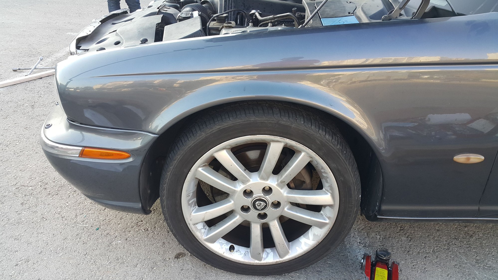

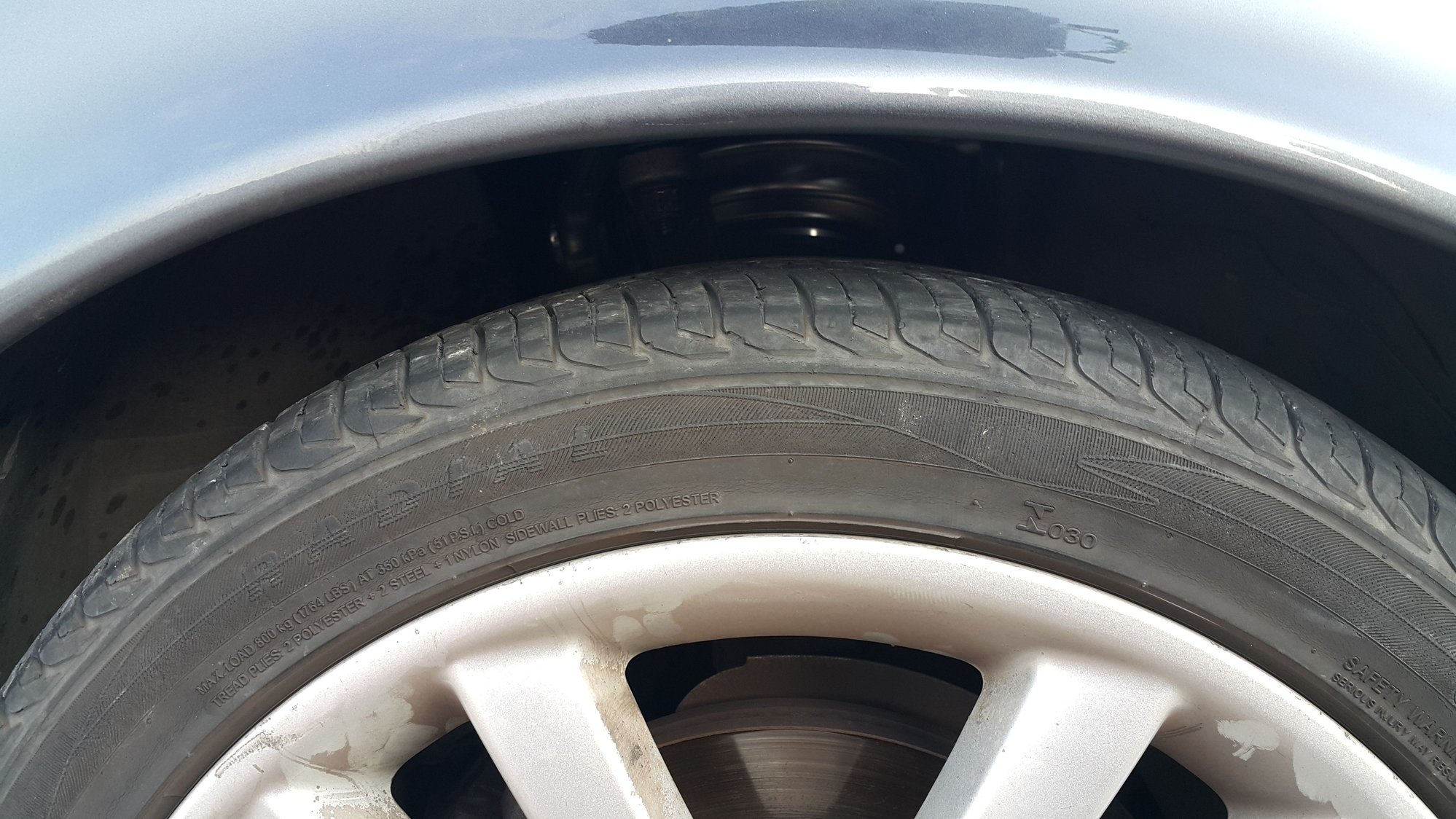

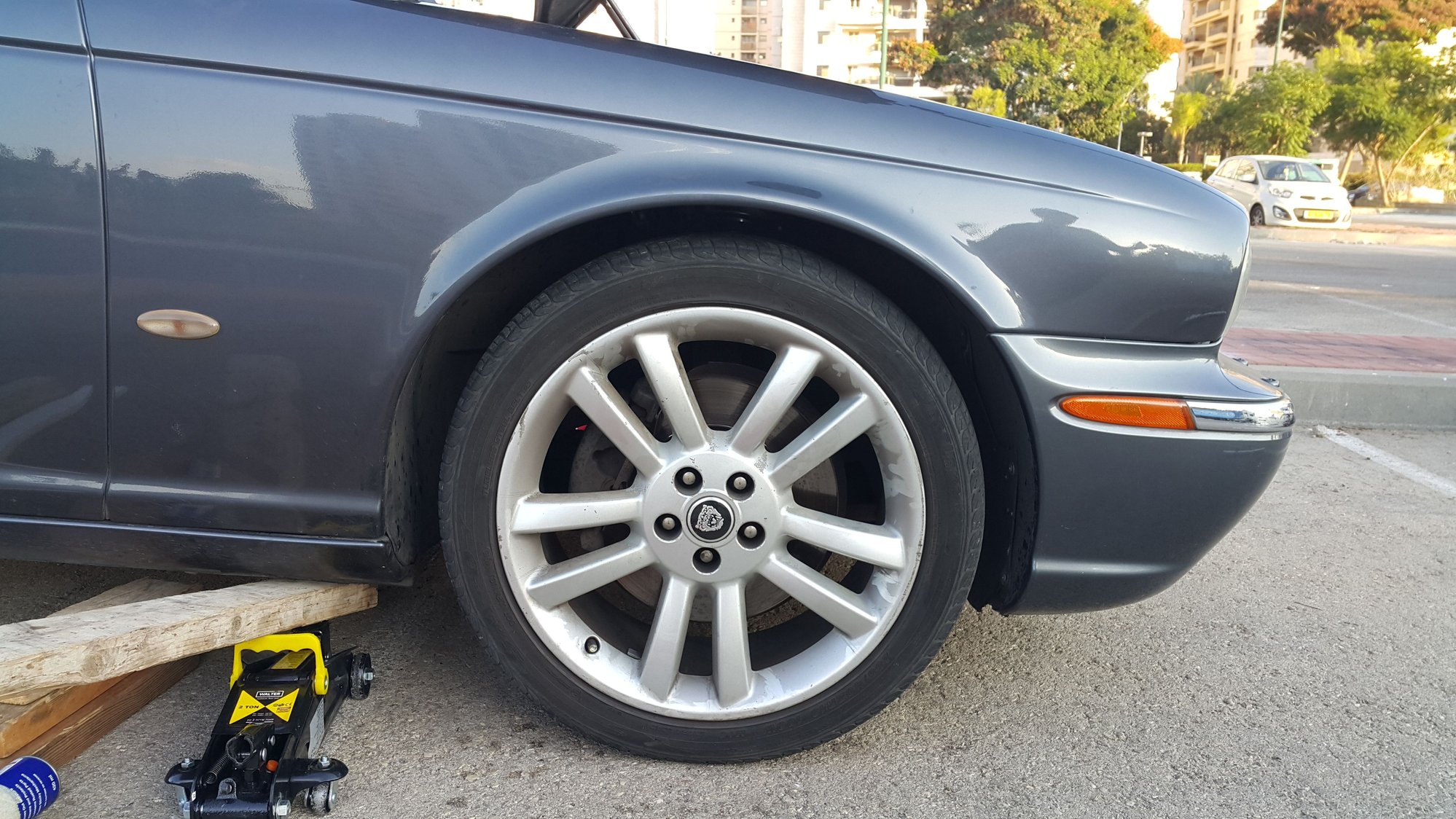

Hello goldgun,
Glad for you,
I did my own job recently for 2 front air suspension and rear right w/"Bilstein" original struts
just in order not to have all errors from cat's computers as it's not a genuine struts, from one hand, and
to keep and enjoy the air suspension as BMW, MERC., BENTLEY, ROLLS etc. from the other.
(https://www.jaguarforums.com/forum/x...-122199/page5/)
You can also follow the photos attached...

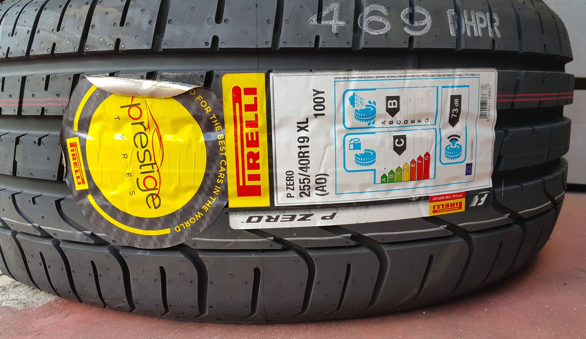

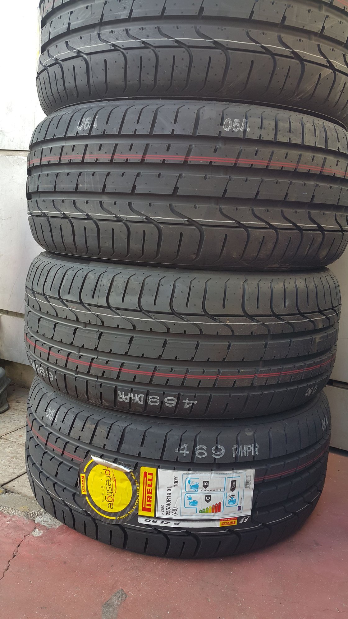

And... a week ago I completed the 4 yrs necessary action and place 4 x Pirelli" P-ZERO 255/40R19 AO XL 100Y
and now I can definitely tell you that heaven is right here !!!
And :
Happy Friday the 13th all...
