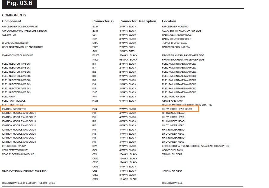

Haven't physically looked for the ignition capacitor myself yet, but from the electrical schematic location description (mine is a NA XJ8 so I can't give you a direct comparison).......it likely has a mounting tab on it to secure it under a screw or bolt to the cylinder head or another larger bracket.

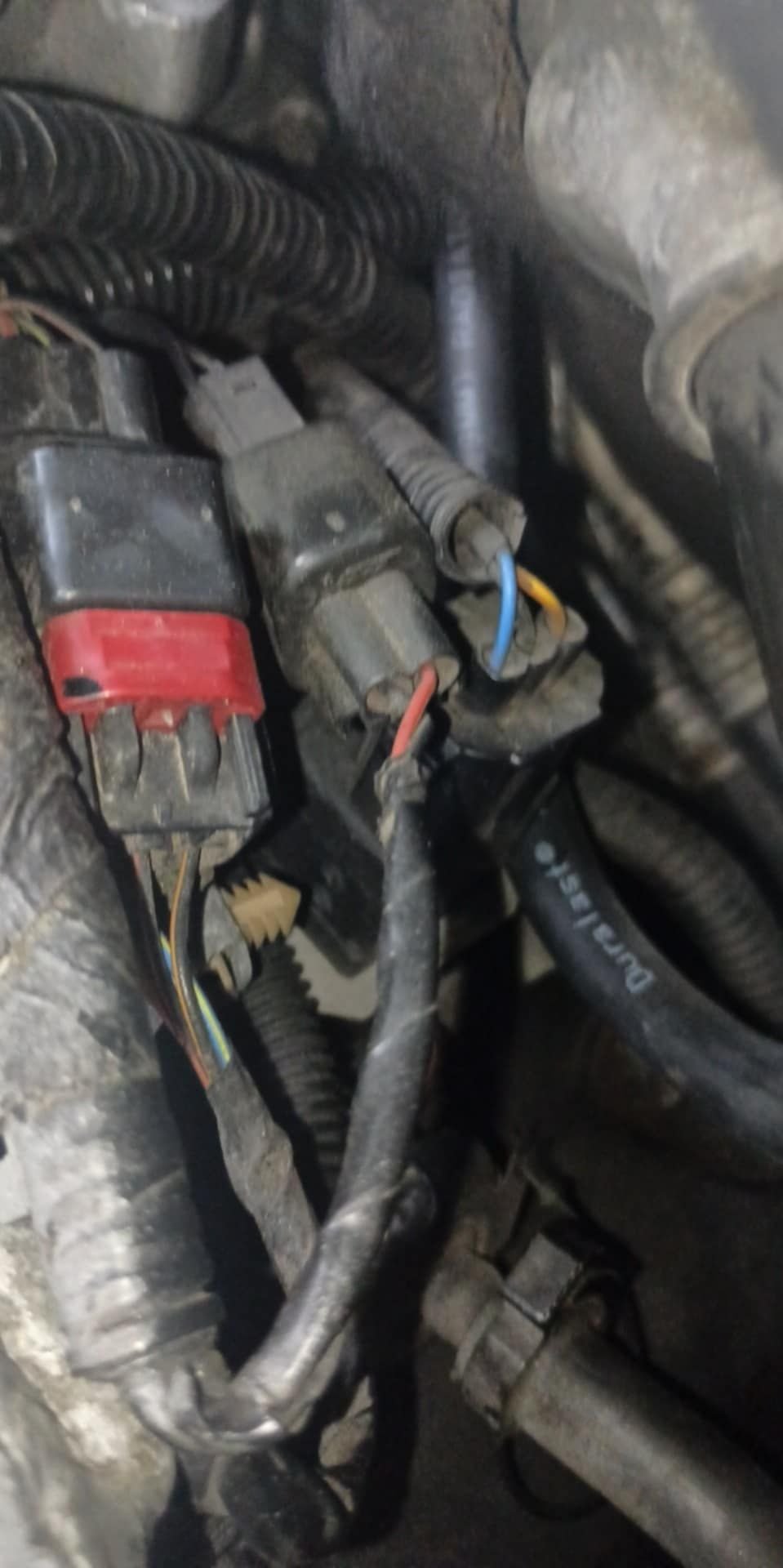

This is all the 2 wire ones i can see rt behind the intercooler. BUT
why would it ONLY act up 2-3 high rpms?

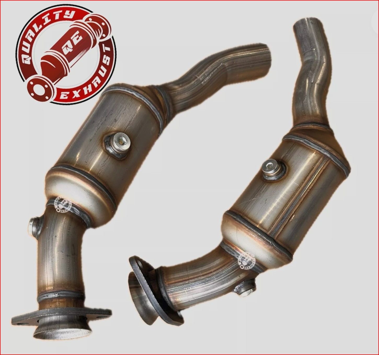

THANK YOU!! I ordered cats off Ebay cannot wait.

cats fall apart on the 04-05s pretty often, dead giveaway is pinging and full bank miss. ebay ones and cheapo high flows are gonna melt quick fyi.

I have used the same co's cats MANY x and never had an issue, it is a "purists" thing where some one would rather spend 2k on oem cats vs $132 shipped just because it doesn't say Jaguar lol. I have 6k total into this car It is getting EBay cats Ill survive.
I'll be putting these in this Friday Night. Ill report back and HOPE this was the issue.

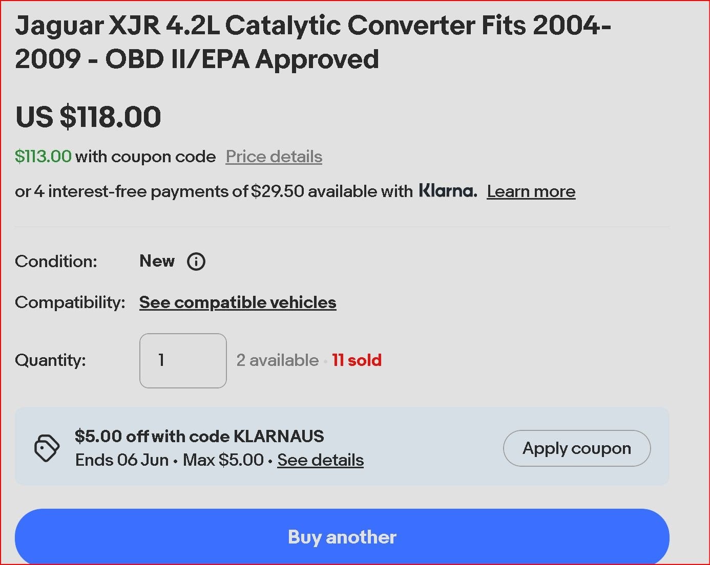

Did this guys cats on an SRT Jeep 2009 about 4 years ago still going strong. https://www.ebay.com/itm/166942047879

Anything EPA/OBII Approved will work fine. I got these. https://www.ebay.com/itm/166942047879
