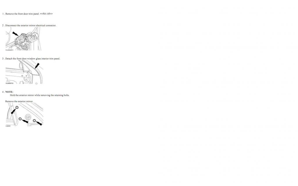

Hey Everyone,
Unfortunately my passenger door assembly has completely broken and I need to replace it. I ended up ordering a perfectly good assembly off of a wrecked 04 XJ. How do I go about removing the entire mirror assembly? I imagine that I have to remove the interior door panel but I don't really know what to do after that, I would really appreciate any help that I can get with this.
P.S I searched the forum but couldn't find any info on removing the whole assembly
Thank you in advance
Mathew

Mathew, the attached should help.
Regards
Richard

Thanks for the prompt replies everyone, I had removed most of the trim on the door but I couldn't figure out how to get the trim that goes near the mirror out. How do I go about that?
Thank you,
Mathew

Thank you for the links,
Richard,
You wouldn't happen to have a higher resolution version of that picture? I'm having a hard time reading it.
Thank you,
Mathew
Sorry, I assumed it would download at a reasonable resolution but I have just tried and it is tiny! I have attached a PDF of the same info.
File Type: pdf
