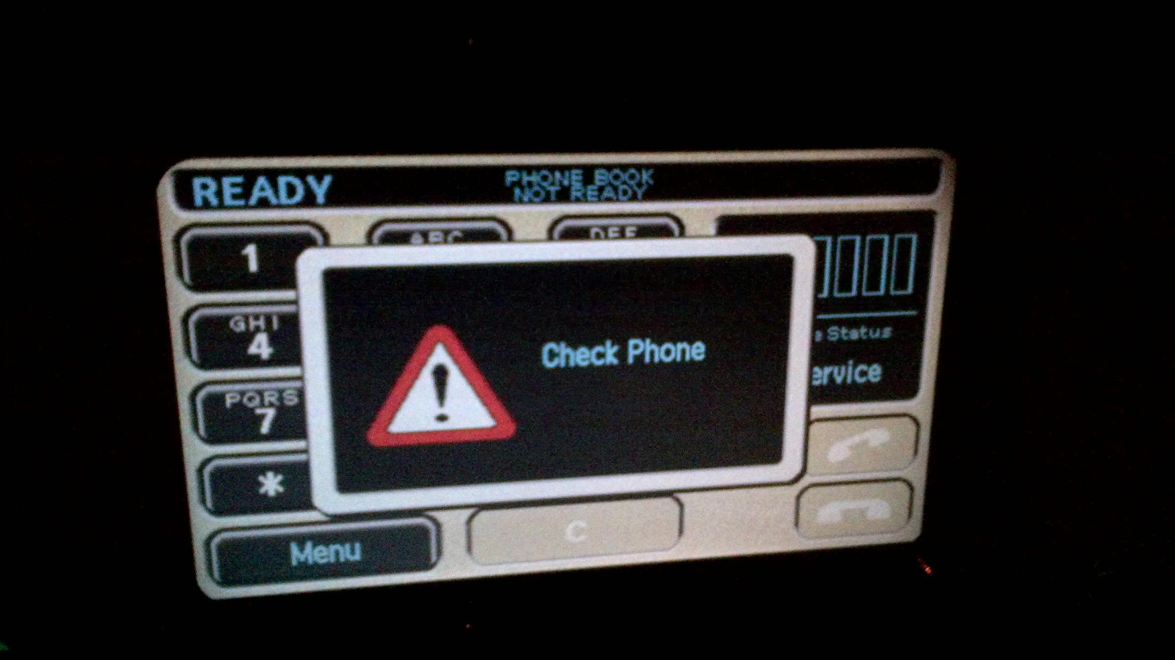

Old Mar 16, 2013 | 03:21 PM
greg-05vdp's Avatar
Joined: Mar 2013
Posts: 76
Likes: 6
From: Belvidere, IL
Received a tip that allowed me to get to the keypad. Went to User Settings and switched from English(US) to English(UK) and then back. Hit the Phone button and got the keypad (strange). Posted the next steps below since I am still unable to pair my phone (and yes, have checked the compatability on Jaguar's Jaguar UK - Bluetooth Connectivity ).
- Entered **3*#* (also tried ##3#*# and ##1#*#)
- Did not receive any message so hit the green phone button
- Received a "Check Phone" error msg (was expecting to see "Discover me")
What's also strange is that after I turned the key off, then back on to Ignition II, I get the HANDSET IN USE msg again and have to change the User Settings to clear it.
Any ideas as to next steps? May have to have the dealer diagnose at this point, but it feels like I'm close.
