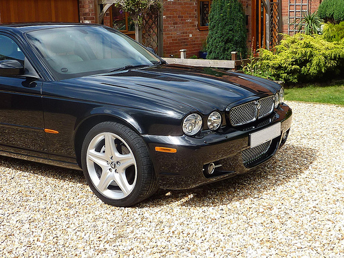

After an exhaustive search i've found this...
Facelift Bumper Conversion - Page 7
(see last car on the page) Here's the pic
350 wings with a 358 bumper... Looks good enough to me, especially as eyes will be drawn to my gleaming portfolio vents ;-) and my newly purchased Callisto alloys - purchased for..... £150!
