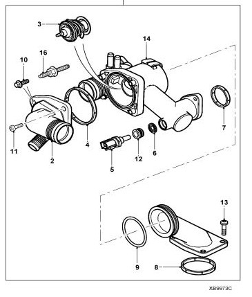

My guess is the thermostat is the trouble. There is a possibility the outlet pipe [what some folks call the crossover pipe] has suffered an internal fracture or breakage. It will be interesting to see what if any faults you logged during your trip. That may tell us something, or confirm a suspicion. Let's see if a P0128, P0116, P0117 or P0118 shows up. A P0118 for instance would confirm a true engine overheat, for instance. So let's see what's there and then assess.
That thermostat is an odd jigsaw puzzle affair that has been known to be somewhat flaky at times, so I'd prepare to get myself one to replace the current one.

Originally Posted by XK8+XJ8L
Thanks, Steve. Your input seems to lead down the same path that Jeff has been illuminating for me. I'll pull the codes as soon as I get done with my Income Taxes.
Should I plan on replacing the thermostat housing as well? Is that where the outlet pipe is located??
Thanks again.
Considering the material they are made out of, that may not be a bad course of action. Here is a picture of the exploded outlet pipe setup. It's a little misleading in that the thermostat, [puzzle, as I called it] fits into the cover [#2], not the pipe itself as the graphic seems to show. If you get the pipe, you get everything you see in the graphic, pipes, thermostat, sensor, all of it, seals and all. I don't know your VIN# so I can't give you a part number, but there you have it.
Still, it will be interesting to see if any faults were recorded or not, and what condition the interior of the pipe is in. If you see much of the material turning from black to a brownish color, junk it.
Good luck.

Here is the whole assembly, for a hundred bucks, I wouldn't even mess with just the thermostat. Part number AJ89485 for your VIN#.
The little yellow clip is only there to hold things together 'til it's installed, then discard.
Man, I hear you on that one. So, if you buy the assembly, all the puzzle pieces are already assembled. Sounds like a sure winner to me.
It does look like it's not made of metal, though. Is that asking for trouble??
Thanks.
Thanks.
I haven't heard of anyone making one of these contraptions out of metal like they have the small one on the 4.0L. So I don't think it's an issue.
I forgot to mention too, that all the seals necessary to install the thing are already on the part. Huh, forethought, can you believe it??
