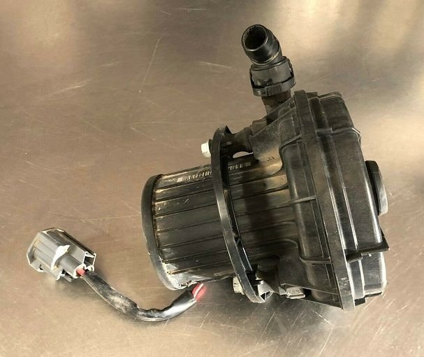

From what you describe this is indeed the Secondary Air Pump. This is what it looks like (photo from an eBay auction):
Unfortunately pulling the plug/fuse/relay will cause the ECM to set some codes. It monitors the AIR system on startup to see that it is performing correctly and that the valves are opening at the appropriates times. If your pump was running continuously past approx 30 seconds on a cold start, then I would also suspect a stuck relay. These pumps are not meant to operate continuously.
