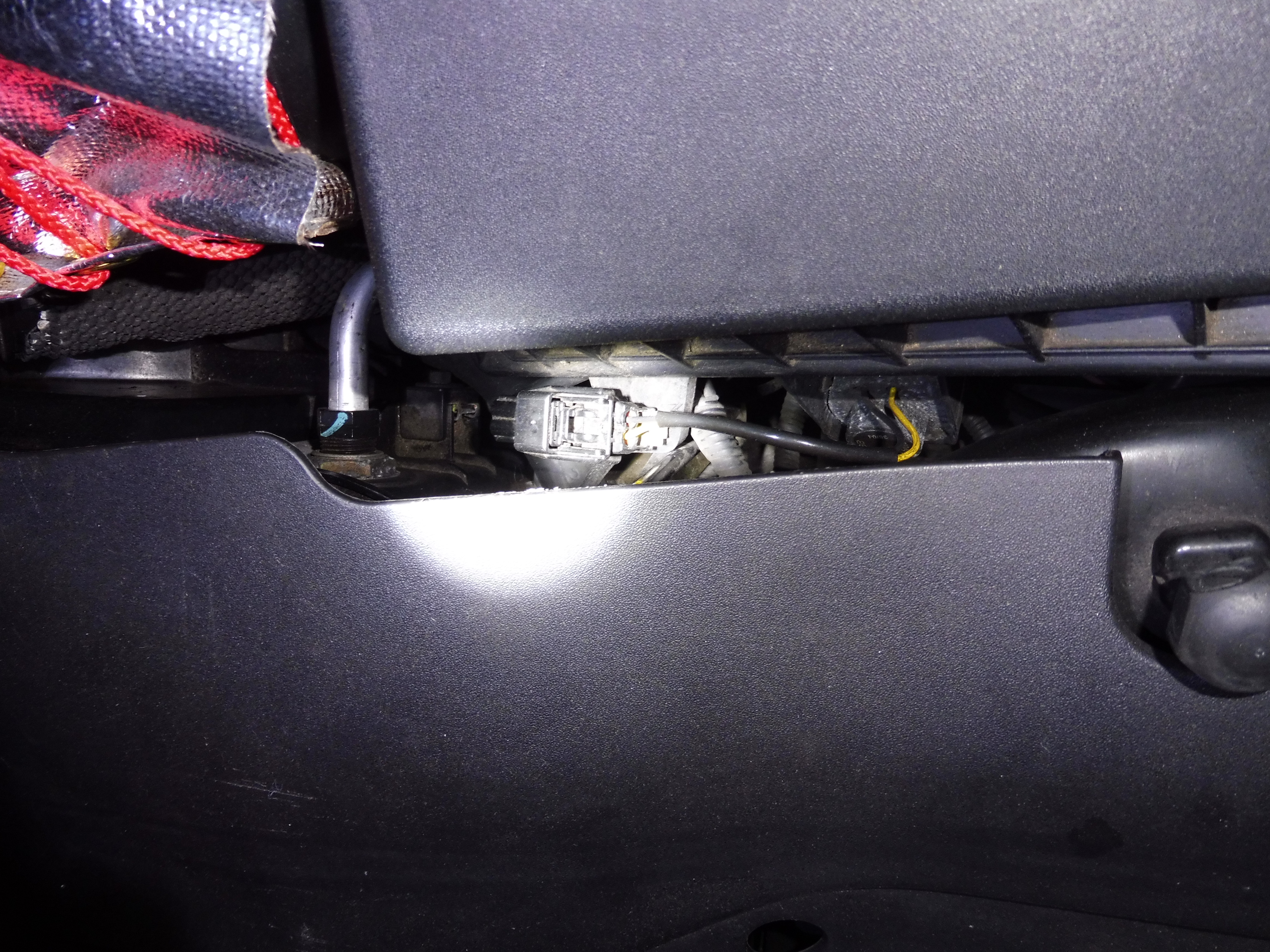

i recently replaced all the hoses, and thermostat housing, I've put everything back together and for the life of me I can't find the wire that hooks to a sensor on the box where the air filter is.

This is what mine looks like.

Those two green circle dot things show you that nothing should be connected there. That's where two wires would go if it was used.

So only the SC model has that flap into the airbox that opens under acceleration?
I have removed mine as others have done.

There is a plug that goes in there on NA models, even though it is not used. The wires and connector should be under the air box or behind the headlight somewhere. You may need to pull the cowl cover to find it.
