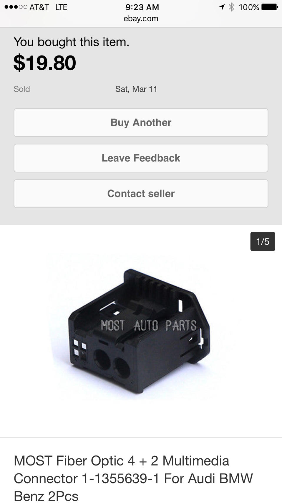

Originally Posted by veffremov
You need a housing like this one:
MOST Fiber Optic 4 + 2 Multimedia Connector 1-1355639-1 For Audi BMW Benz 2Pcs | eBay
Move the fiber optic pins to the new housing and use regular dupont pins for the 4 electrical connectors.
A little cheaper on aliexpress 2 for $17,
https://goo.gl/yFPDq9
The connectors are on the way.
Thanks.
Mag
