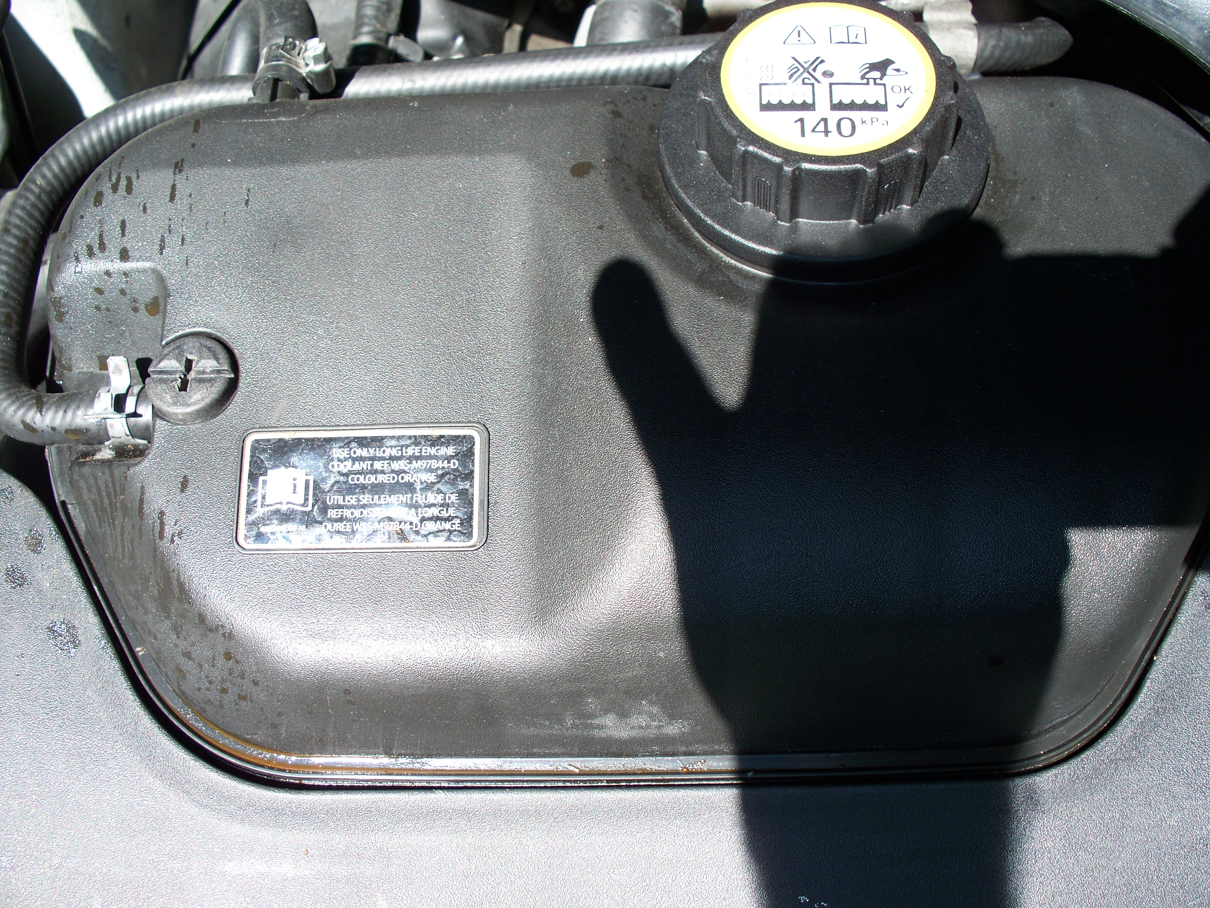

After replacing Pressure cap and the top radiator hose assembly including the lower heater pipe hose and connector and checking the top heater pipe connector, I still have a coolant loss. On a 330 mile drive yesterday the car was great with no messages or codes, but when I checked the coolant this morning, although there was still residual pressure in the expansion tank when I loosened the cap, there was coolant in the front tank seam and drops on the right side of the tank like coolant had been blown back there and it was a cup low. I didn't see any coolant at the top radiator hose or the heater pipe connectors.
I'm not sure where to look next. Maybe a sniffer to see if the system is being over pressurized by a head leak? Can the expansion tank leak at a seam and still hold pressure all night?

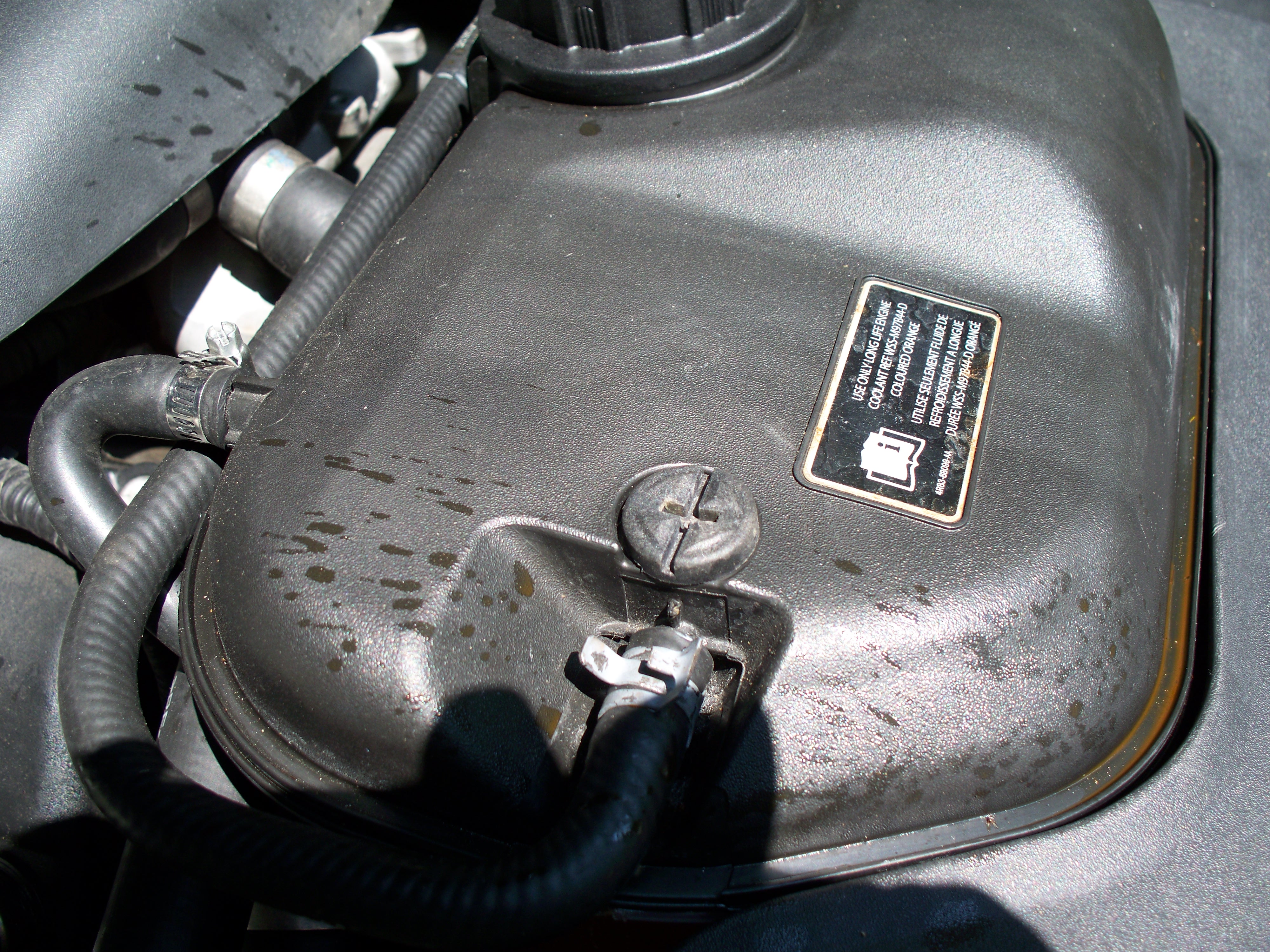

The nipple where that small-diameter hose fits at the top of the header tank tends to crack until it eventually falls off, but well before that the coolant loss is noticed. Remove the hose and check it out. It is quite a common problem unfortunately.
In the second picture, where the small bleeder hose goes in, as Fraser said this is a very common ( if not the most ) place to leak. However, where the plastic bleed screw is just above this, there is an o-ring on it, have seen these leak ( o-ring). I have also seen the bleed screw leak itself as well. However I have never seen the "seam" leak on one yet, but doesn't mean it couldn't happen.

Thanks for the replies, Guys,
I had the pressure tank off when I recently replaced the top radiator hose and the nipple looked and felt OK. I’ll check the bleed screw O ring again, although it does hold residual pressure. I do have dye in the coolant so I’ll check the lower hoses in the dark again too. The flow of drops looked like they blew across the small hose rather than from it, so I’ll pull the cover and check under there again too.
Has anyone had the radiator leak at the top under operating pressure but still hold residual pressure? The drops looked like they might have come from under the cover or from the tank seam

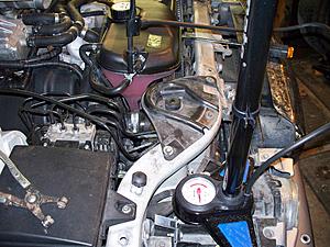

I previously pressure tested at a T between the hose and the nipple at the expansion tank. I assumed this would pressurize the radiator too. Reasonable assumption or not?

I had a similar situation a while back and decided it was the seam. Cleaned it with alcohol and put a bead of High Temp silicone around the tank, no more coolant on the tank lip. Been several months now.
