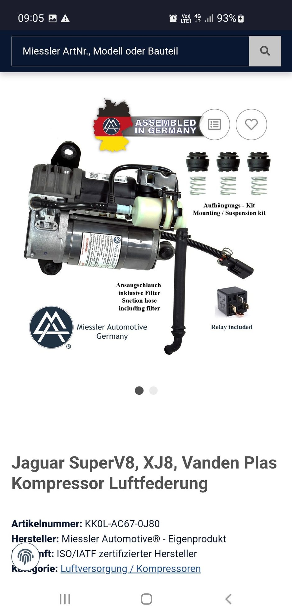

there are other brands . This is what they look like. Wabco is Oe. Should change the relay R1 in engine bay fuse box R1
