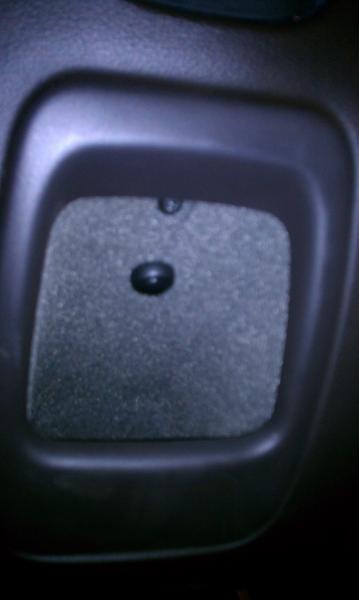

I stumbled upon a magic button installed inside the coin cubby on the left hand side of the steering wheel (of my left hand drive) car. This magic button cycles the rear entertainment through all its choices, ie AM, FM, Aux 1, Aux 2, DVD.
That's awesome.. I have the ACM but many users here without the ACM would love this feature. Can you shed any light on whether this is factory or a mod? Can this be added?

Here is a picture of said Magic Button...
And here is the aux-input in the centre cubby (with a 3.5mm lead plugged into it)
Here is a video of it in action...... you can hear me pushing the button each time, then the source changes. A point to note is the button doesn't have "on" and "off", or "in" and "out" positions.... it's just a momentary closed button that springs back out when you let go of it.
Magic button on 2006 Jaguar XJ - YouTube
I'm trying to think of how it could be working...... could it be as "simple" as wiring the button in parallel to the "Audio Select" button on the rear entertainment switch pack..... ? Then also wiring the aux input lead behind the RCA inputs ? I haven't actually tried feeding anything through the RCAs..... perhaps if I did that I would find that Aux 1 (left hand side) doesn't actually work from the rear of the car ?

Did you ever find out how this works??
I'd like to add the exact same thing! Am struggling to work out how to add this button....
