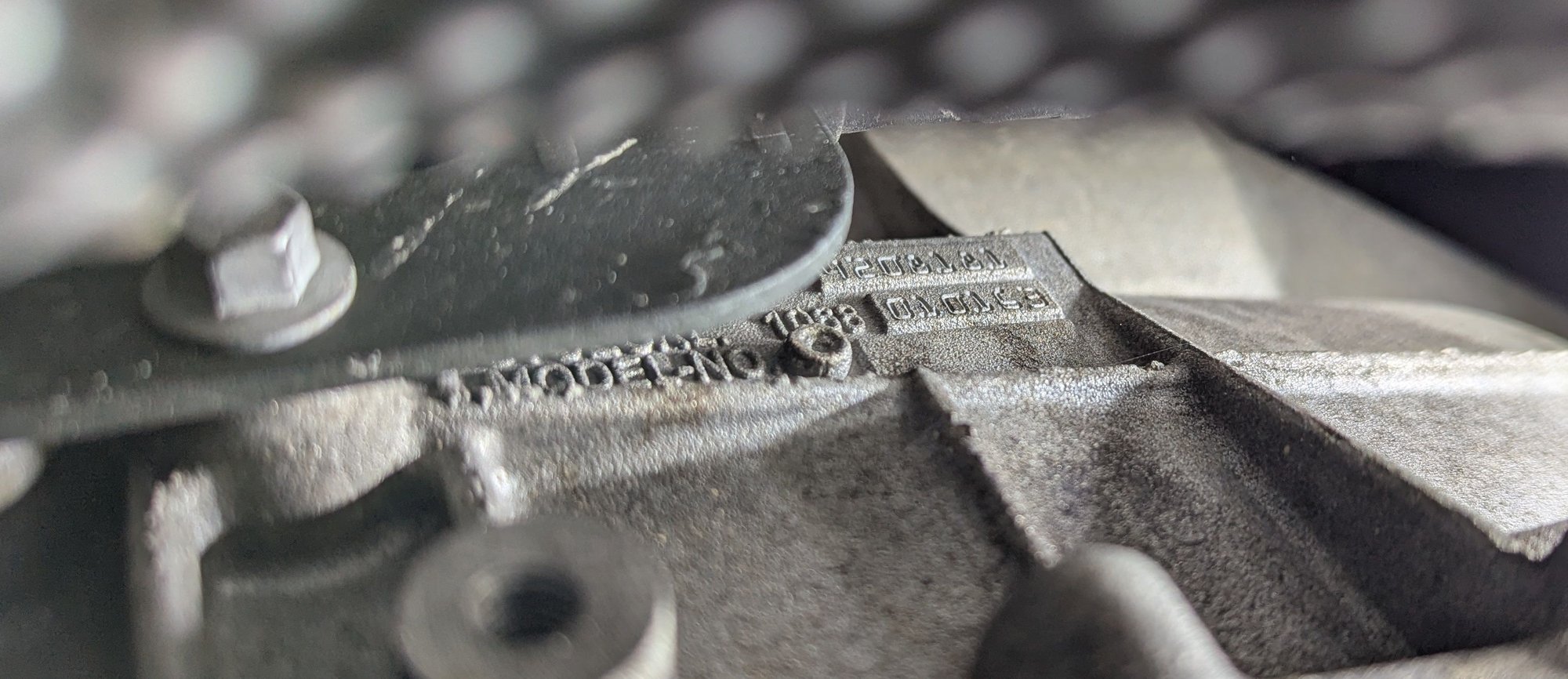

If you're trying to ID the separator plate between the halves of the valve body, you'll need to proceed with dropping the pan.
Here's what the tag on the separator plate will look like in-car:
And, here's a chart showing what separator plate you'll need to obtain, based on the ZF part number on the tag:
Hope this helps,
Paul
Ugh... the separator isn't identifiable from the external 1068 number? Damn. Thank you, I'm glad to know I'll have to plan for the car to be up on jackstands for a week or more. Maybe I can find a local trans supply place and just get the separator locally once I pull the valve body.

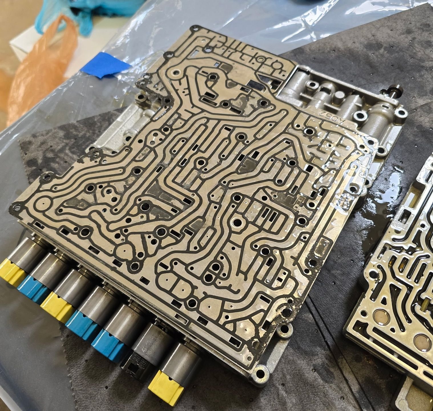

Got the transmission drained and the valve body out today. Unfortunately the new separator plate is the 051, I need the 052, so the case numbers didn't line up for whatever reason on that. I'll get that resolved next week.

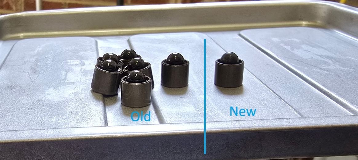

I was surprised the dampers are not flat at all. They sat maybe 1mm sub-flush from the top half of the body. The sealant on the separator plate was in really bad condition thoguh--I suspect this (and old solenoids) are the root of my issues more than anything else. Once I get the new separator I'll reassemble and post back with the results.

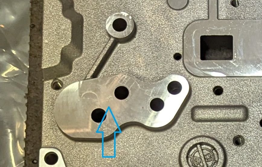

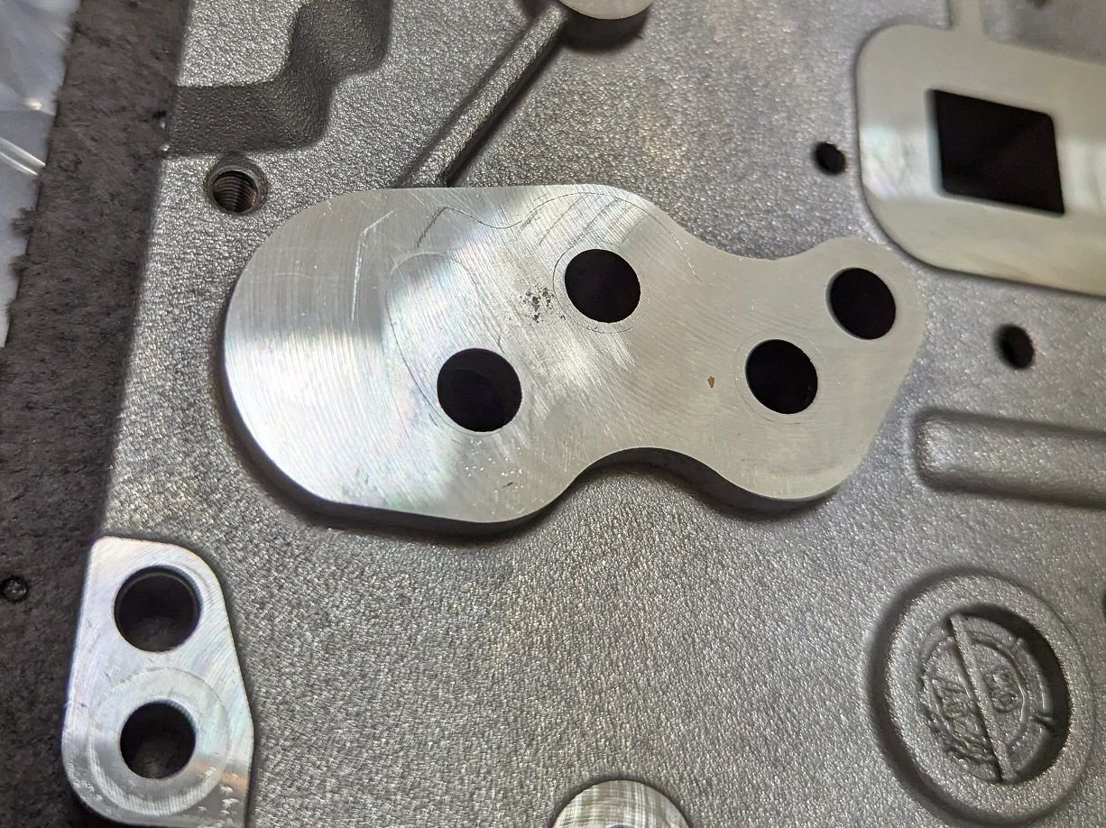

Was cleaning and re-assembling the valve body last night. Things looked fine until I noticed this horrible ding at the E clutch mating face. This is adjacent to the square pump ports with the bridge seal. These are metal-to-metal so no tube seals or anything to seal these. It looks like someone hit it with a punch or dropped it on gravel. That definitely did not happen when I removed it. It would only have happened if the TCM was removed at the time. Not a clue.
I did my best to polish off the high spots with 1000 grit. I will check the mating surface in the car before I put it back in. Now I feel like the whole job has been sabotaged.
Edit: this is not the E clutch port, I believe these are for the cooler? Still not ideal, but perhaps less critical than the other ports.

Good find! You must have went over the whole valve body in great detail as I doubt I would have even seen that!
Are you going to live with it? I probably would.

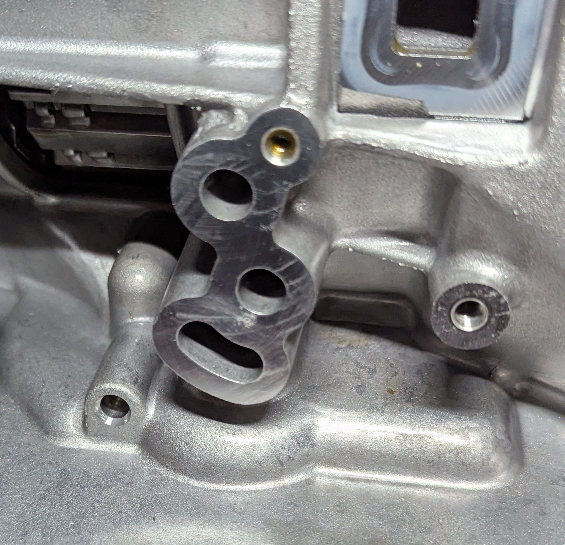

Short of replacing the whole valve body, I will live with it. I don't know how that even could have happened or how long it's been that way. The mating port on the transmission body shows the mirror mark, but has no edges I can catch with my finger. Hopefully the little bit of smoothing I did with 1000 grit will help it sit flat.
