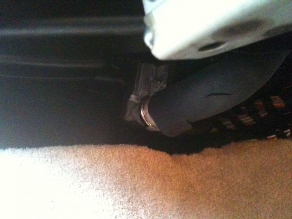

Here's the tube where the water is dripping from. It's basically coming from that connector part. Quite a lot of it...
Anyone know what that is?

I have been looking but unable to identify the hose and the relationship to the leak. If I were to guess I would say the condensation is accumulating and leaking out of that what should be sealed area. I would first clean the A/C drain pipe on the outside of the car and see what takes place.
See attachment.
