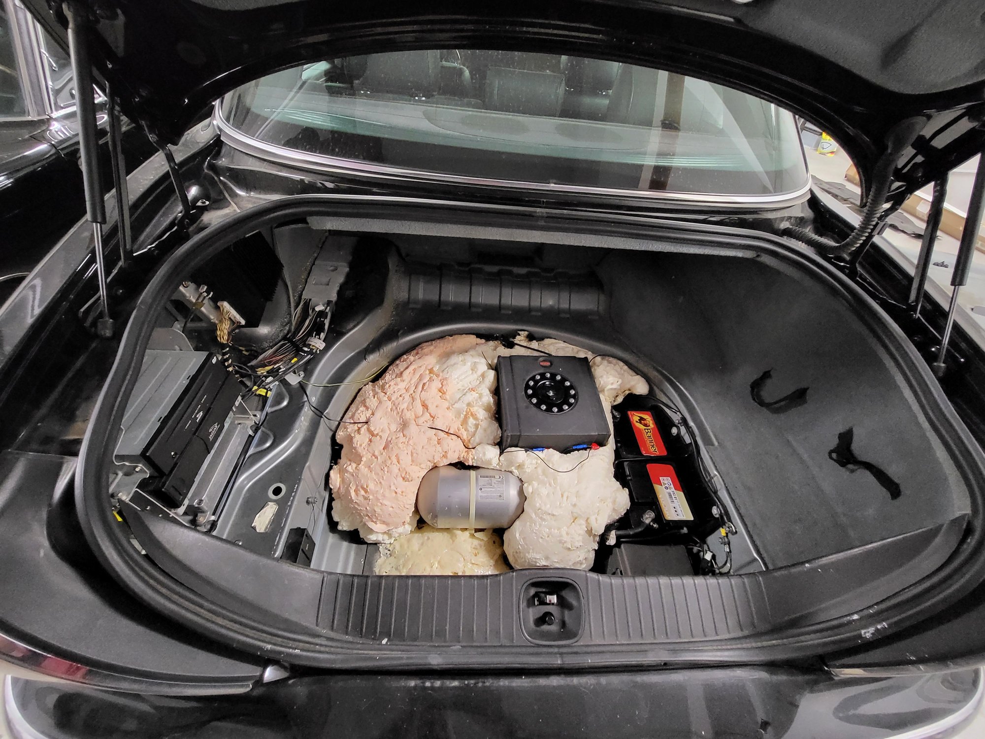

My project got derailed because of bad front upper control arms which I had to replace, and also the rebuilt fransmission began to once more give me trouble. But today I decided to also do something fun on the car, so here it is, my Snow Stage 2 MAF system, with a very... original trunk mount system.

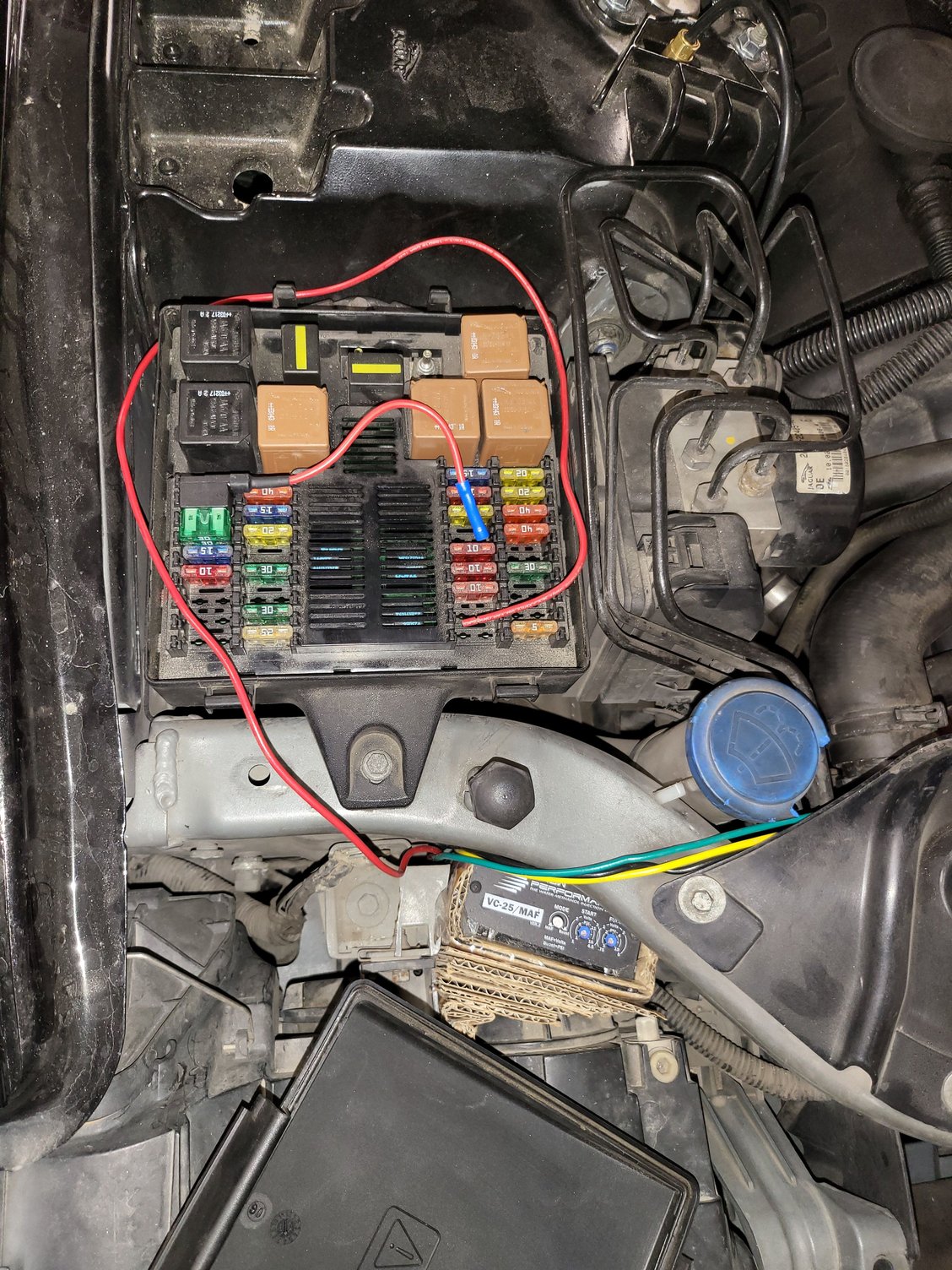

Little tap-a-fuse I found. Also found a snug location for the controller. Cardboard sure ain't pretty, but it sure does the job.

I know, I know, looks like some killer blob from an old B movie, but it does the job wonderfully. 9.5L tank with mounting points for the pump & low level switch.
Black cable takes power from the controller to the pump. yellow/green to the low level switch. Water/meth goes through the black line to the check valve, then through the clear line. I installed both a solenoid, and a check valve because there will always be only liquid for the entire length between the front and rear, no need to wait till all 5 meters will fill up at every start.

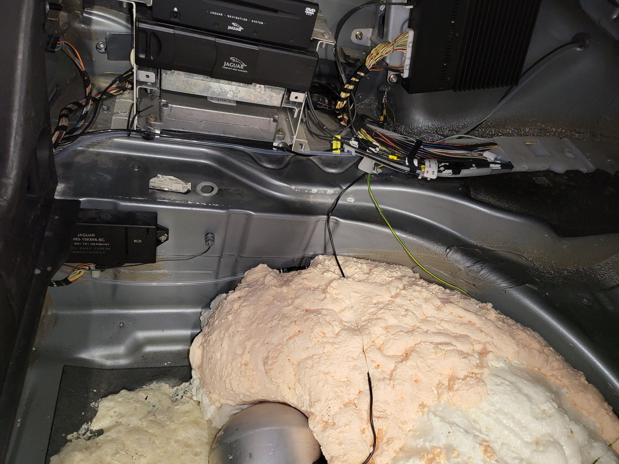

To the top right you can see where i drilled into the wheel arch. I used a grommet taken from the hole near the sticker (center left). I arranged everything so there would not be any pressure on the line after the trunk trim is put into place.
The blob can be taken out at will, because I first lined the spare wheel area with plastic, then put insulating foam. Same for the tank.

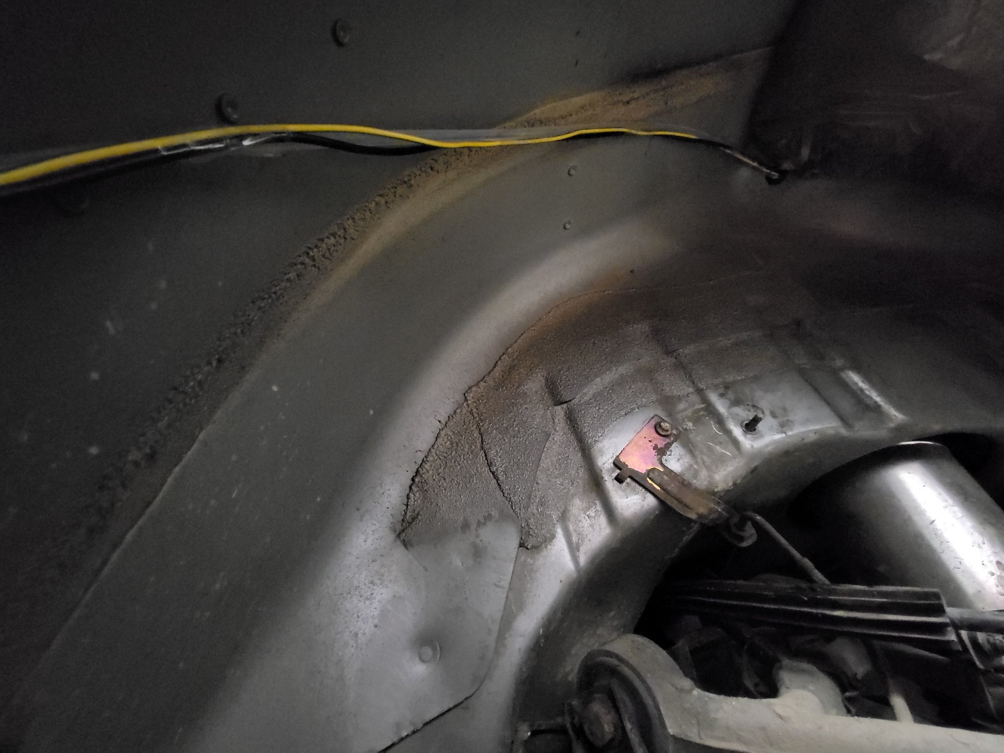

water/meth line + cables enter the wheel well through the top, arch nicely downward

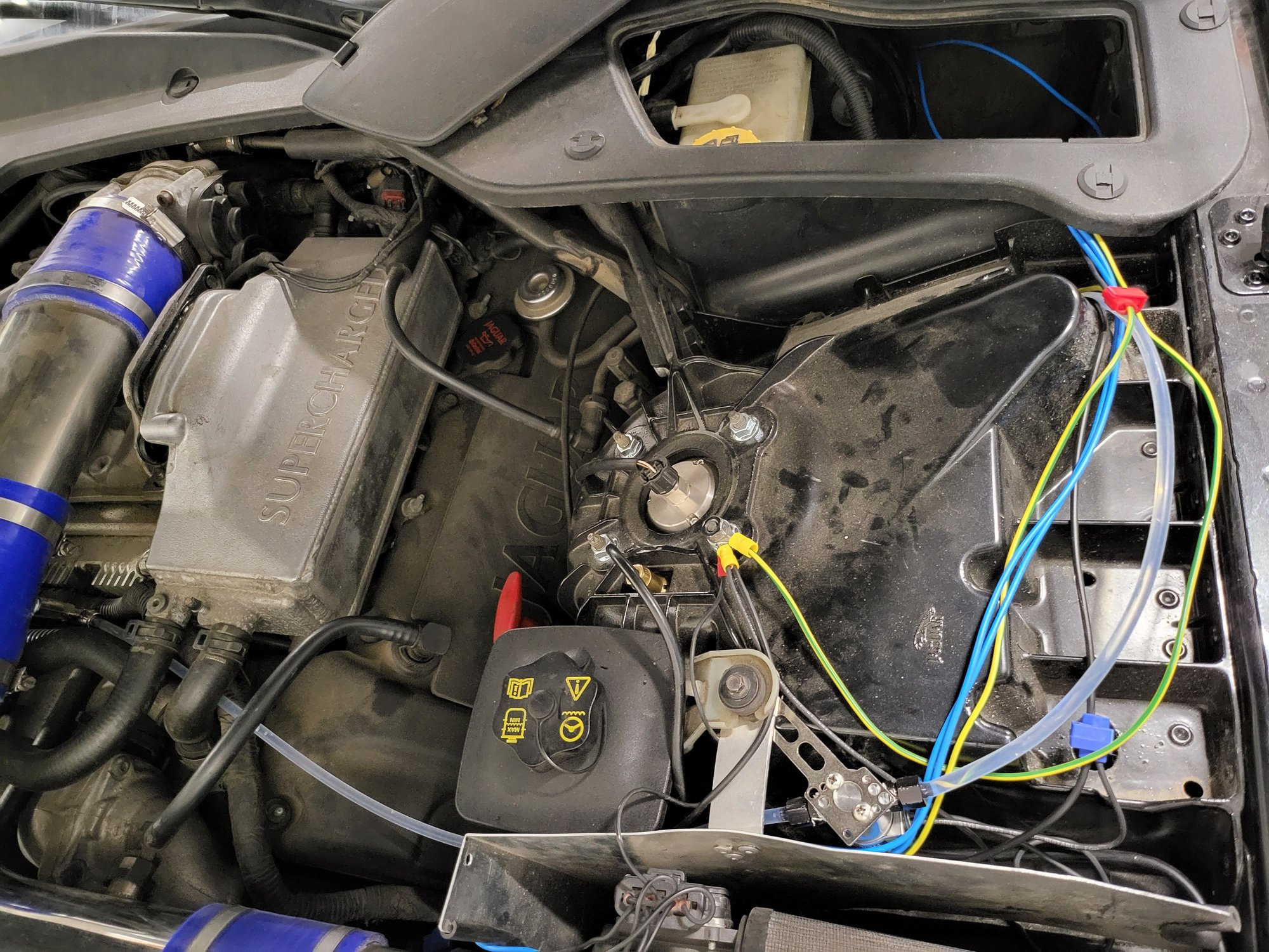

found a tight space to under the front wheel liner, then through one of the holes near the front strut, and voila!, you are in the envine compartment.
At this point I have to screw in the nozzle, and I am done, except for the on/off switch... Please help me with getting a cable to the passenger compartment.

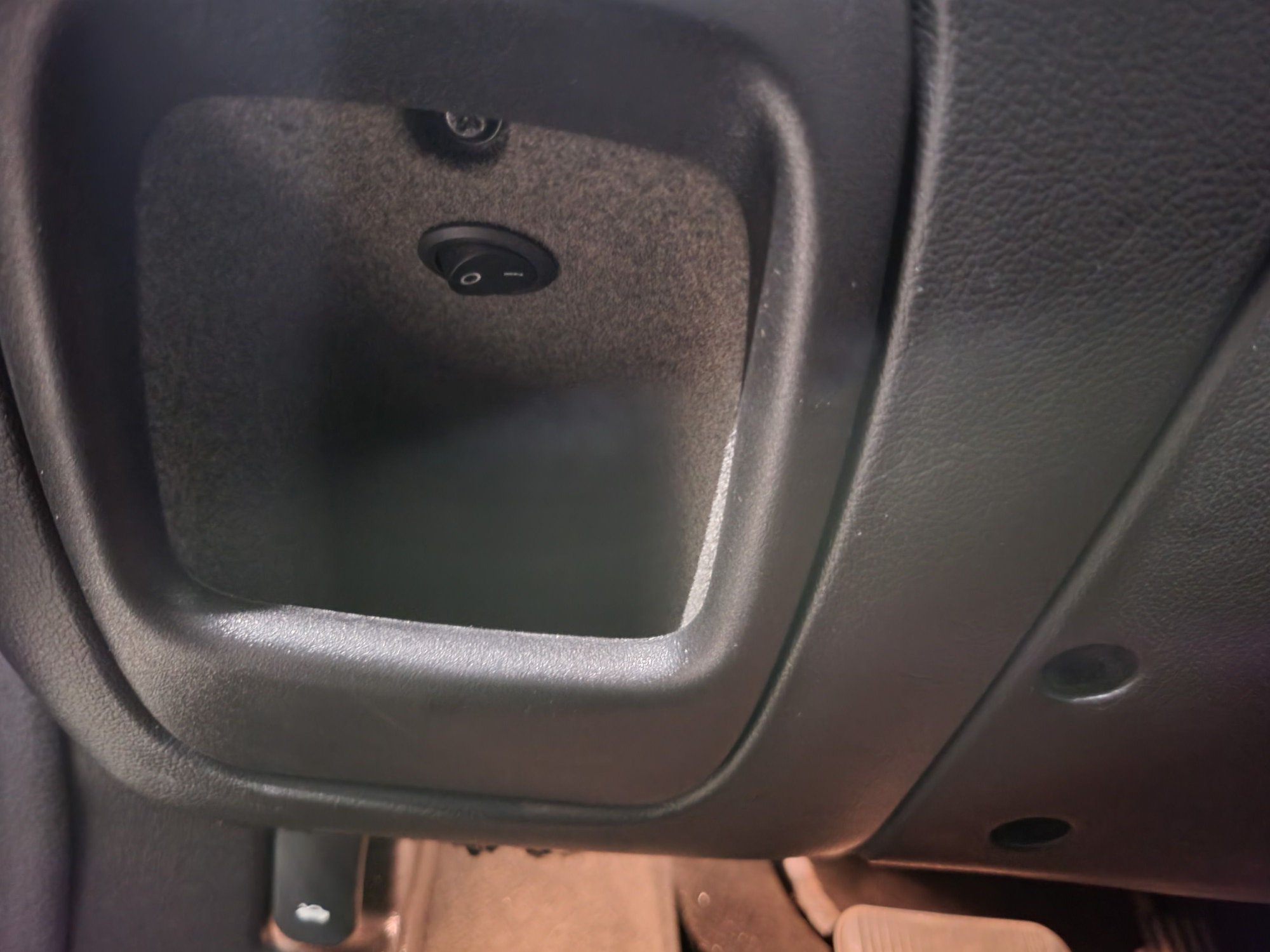

Finished the install.
blue wires go through a hole I drilled in the firewall to an on/off switch, black & grounded yellow go to the low level led (which is seemingly broken so I took it off). I am planning to have the low level light on the cowl, under the hood, a nod to 60s & 70s outside gauges
Nice & subtle. Now one can have the system on or off at will. Good to have when e.g. tank runs out of water/meth, and you are on the highway with no intention of stopping for topping - just turn it off till you can add the w/m into the tank.
625ml nozzle in place, tucked nicely underneath. Black line handles 100 Celsius, clear one 200. Good idea for the engine compartment.
