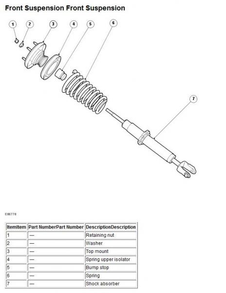

FWIW, it looks like the units for the non-air suspension on the armoured X350 had some sort of bump stop incorporated in to them as well.
Attached Thumbnails Who has installed the Arnott Coilover conversion?-armouredsuspension.jpg
