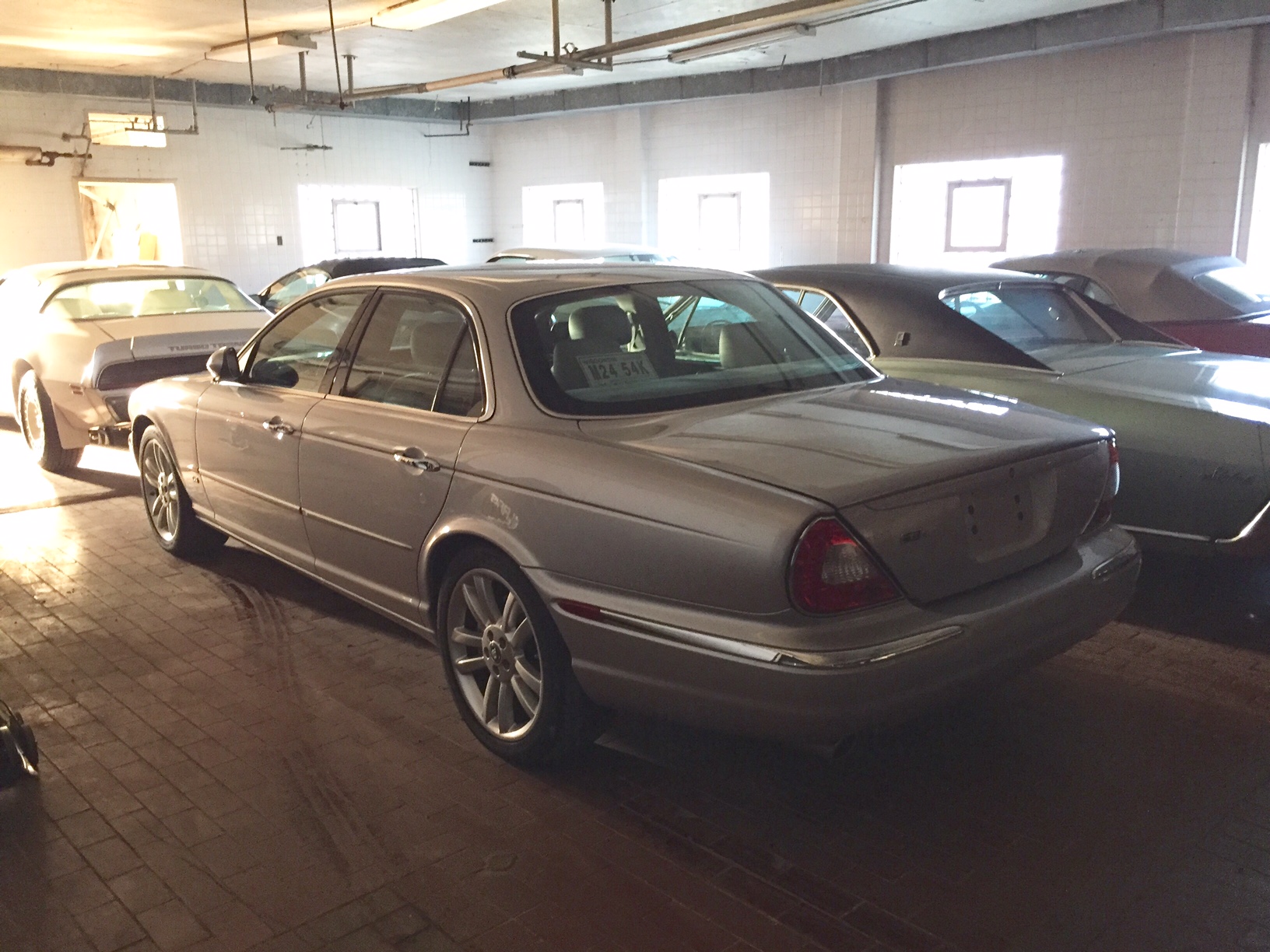

As a recent new XJR owner I have a concern with storing my car for the next 4 months. First let me say that my storage area is heated (50F) with a concrete floor and I have stored my other cars for up to a year at a time with out issues. But none of them have been a Jaguar. So I have changed the oil, topped the gas tank with stabilizer added and disconnected the battery. That said, should I be concerned with the parking brake being engaged for the duration? Will it effect the disc? Should I start the car every month and idle to operating temp? Do the tires need to be spun to prevent flat spots. I have Michelin Pilot Super Sports inflated to 50psi for the time being. Any other items that I should have thought of? The forum member's suggestions are much appreciated.
Attached Thumbnails Winter Storage Concern-morgansxjr-04-instorage.jpg   Winter Storage Concern-morgansxjr-04-stored.jpg

What a nice spacious garage is this home or storage facility? Lovely Jag too.

This is a private site of my friend just a few minutes from my house. I can only store a couple cars at my place before it becomes a hassle.
