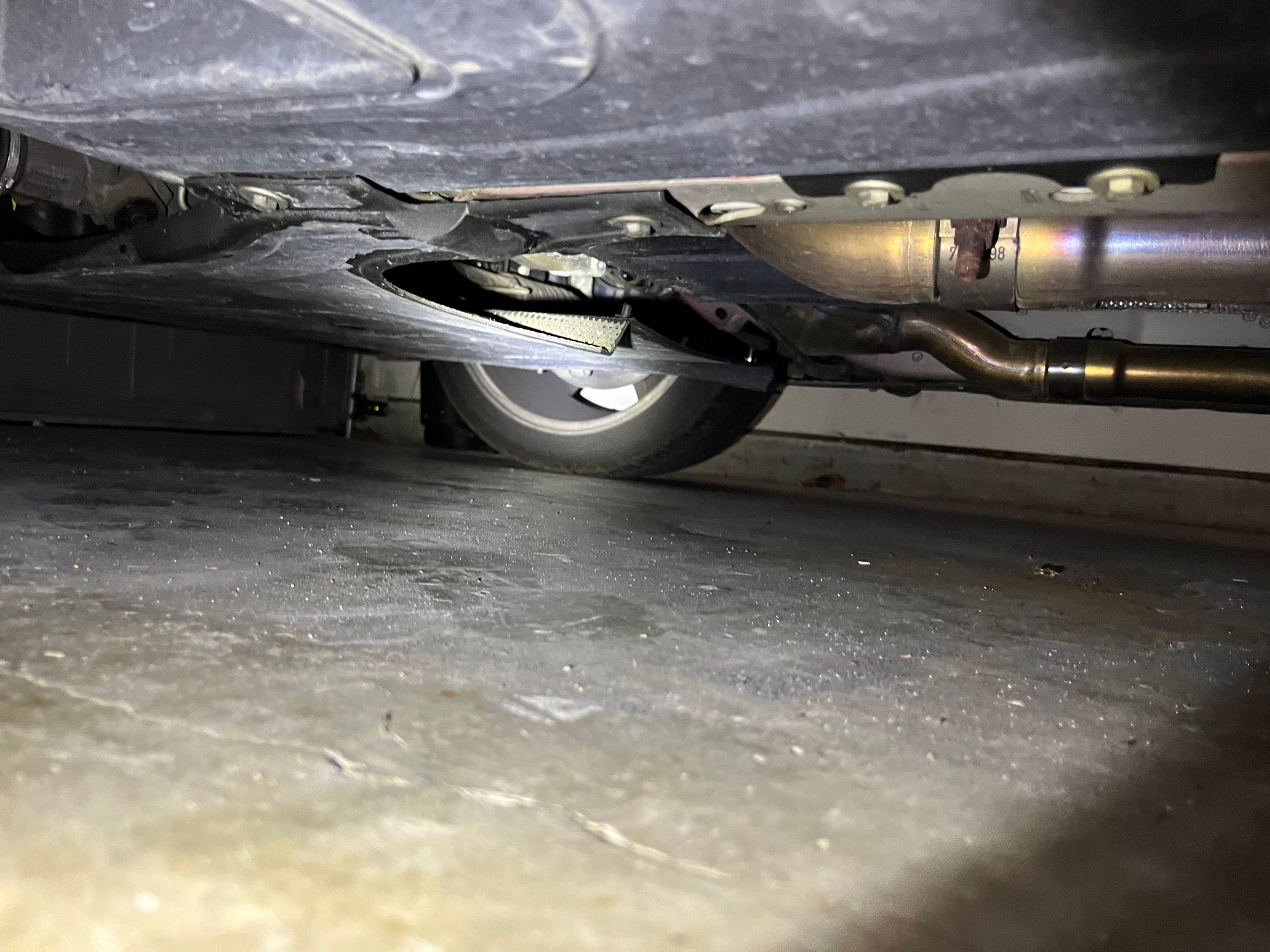

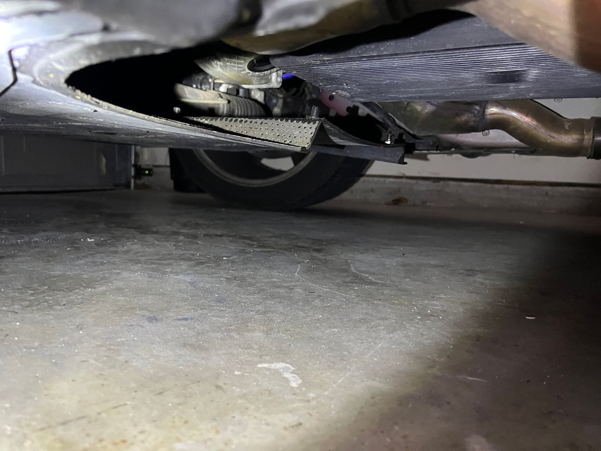

Hi,
Does this look correct to you? It looks like something has become loose.

Hi hdqq,
Your under-tray is very well secured. A piece of the oil and sound absorbing mat has come loose.
You could reach under the car an pull it out. Alternatively you could remove the under-tray and clean the piece of mat and re-secure it.
