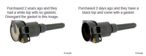

I purchased the Prenco ignition coils with the white tops shown on the image on the left 2 years ago from the date of this post. I started to feel slight rough idles on my 1995 JAG and caught a 1 second glimps of an check engine light and knew immediatly it is an ignition coil over issue.
Due to the knowledge base on this forum I learned I can remove my ignition coil cover and start my 95 JAG and watch for a lighting show ontop of the ignition coils. Sure enough I saw cylindar #6 giving me a light show. I then removed the coil and swapped it with cylindar #5 and the light show moved with the coil.
As the image shows below I purchased the Prenco ignition coils on the left with the white tops. Two days ago I went to purchase one more to fix my cylindar #6 ignition coil light show and found the tops are now black and come with gaskets.
I am not sure what the gaskets are meant to do. I have run my ignition coils without one and also when it was given to me it had no gaskets.

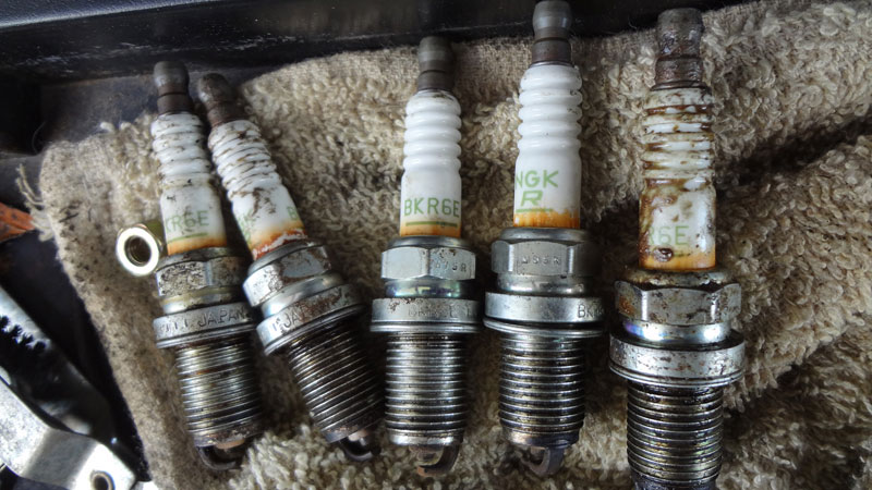

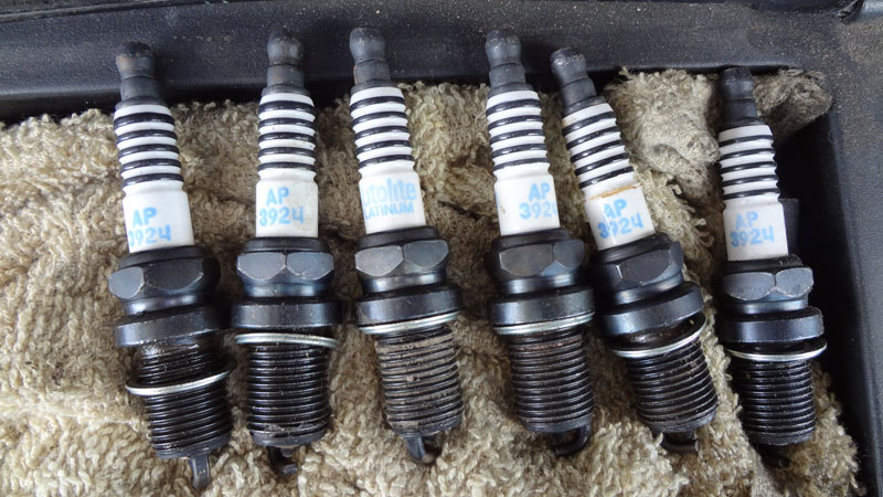

I have used the following plugs and have had hit or miss performance ranging from rough idles to poor hesitation.
I have used these with poor performance:
Autolite-AP3924
I later changed to these with poor performance:
NGK_V-Power_Copper_Spark_Plugs_BKR6EK
In the end the ones working best with no performance issues were the Champion RC9YCC

This is no doubt a dumb question but why have the NGK's got that brown staining at the bottom of the ceramic?

That's known as "corona stain". It's the result of the corona spark ... the gap between the insulator and "nut" and a spark traveling up the plug.
??? The "other brown stuff" on the far right plug could be from the person's oily finger or possibly oil leaking into that spark plug bore???

I would definitely use gaskets. If you don't get them with the coils you can make them from the back of a tablet. I did that for a while and it worked fine. I also believe in insulates the coils from the magnesium cove somewhat which is important in keeping down the electrolysis effect. In fact you should also put electrolite grease on the gaskets. That can't hurt and may help preserve your cover a little longer. Those covers are now $750.

My jag is running fairly smooth and began to notice a slight rough idle when coming to a stop light this week.
I decided I would check the ignition coils at night to see if I saw flashing arc on the top of the ignition coils and sure enough I saw it happening on Cylindar #1. It is only happening on rare occasions and had to sit there and watch my engine run for about 10 minutes and noticed the light show for a second or two then it stopped.
Something is killing my ignition coils. Not sure if the engine heat is hotter than usual. I'm still paying close attention to this to see if I can figure out what is going on.
I will follow your advice to see if my ignition coils last longer.

Let us know if you discover anything. You're not the first to have problems with aftermarket coils. Either there's a quality problem or some sort of specification/design issue with the aftermarket coils where the coils and the car don't tolerate each other very well.
If you buy any more coils I suggest going with the true OEM type. SNG Barratt is selling them.
