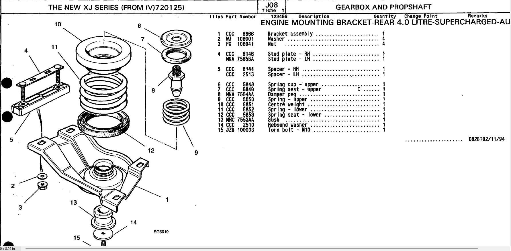

So will this work for the 4L80e in my XJR? I am so new to these cars lol.

G'day Federico,
Yes that should be the one and unless there are bits missing on your mount you will probably only need part number 13 , the bush, on the diagram.
Google the part number MMC7553AA and you will find many suppliers.

Hello
By accident I ordered a new upper spring for an XJR (part number CCC5850, probably shown as Part No. 9 in the parts book).
If you want it, I'll mail it to you for the postage.
