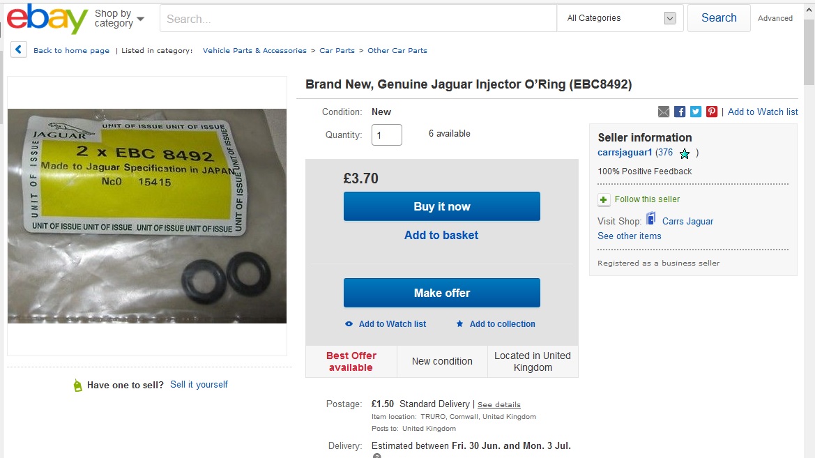

JEPC shows P/N EBC8492 for the injector O-ring.
A quick search on ebay UK ......:
Brand New, Genuine Jaguar Injector O?Ring (EBC8492) | eBay

on that eBay ad, it says it fits 'XJ6 & XJ12 1987-1994', but mine is a 1997. Do you think this is simply a mistake on their part?

Most likely just too lazy to fill in all possibilities
it is the same part also for x300
https://www.jaguarclassicparts.com/uk/part/EBC8492
