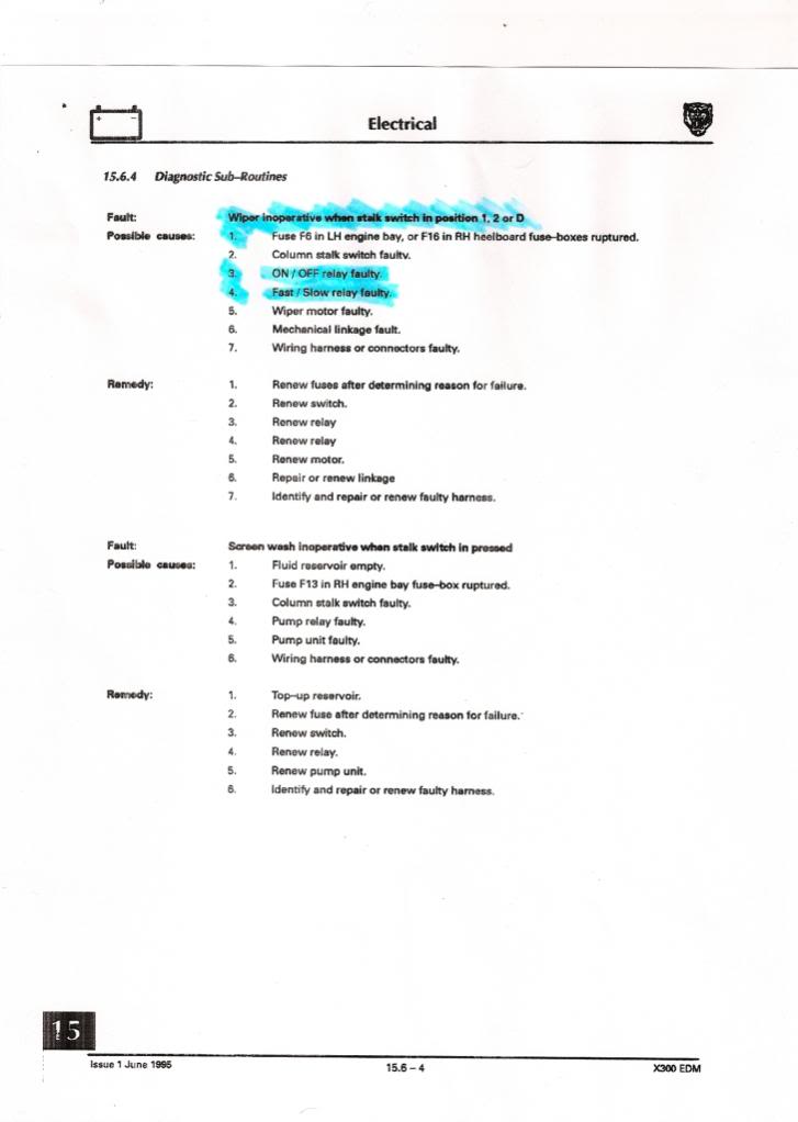

I can almost guarantee that's a relay problem. There are two relays in the front of the engine bay that can affect the operation of the wiper. I'll dig up my diagram and see if I can't tell you exactly which one.

here we go. a few years back I had an issue where my wipers went crazy. I'd move the switch into each and every position and it wouldn't to anything, and then sometimes when it would work, it would only work on the slow constant speed, and when it did that, you couldn't make it stop, it would just quit when it felt like it. ridiculous intermittent operation.
though in your case, there's not even intermittent function. sounds to me like whatever relay is responsible is thoroughly toasted.
& I had to print and scan pages out of my shop manual, but this should be what you need.
Attached Thumbnails 96 xj6 windshield wiper won't work!  help!-techpage3.jpg   96 xj6 windshield wiper won't work!  help!-techpage2.jpg   96 xj6 windshield wiper won't work!  help!-techpage1.jpg

try switching the relays with others that you know are good and see if that doesn't cure the symptom. then you'll know you just need relays

Thanks. I'll poke around under the dash this evening and see what I can see. I tried to view your diagrams of the relays from your earlier post, but I wasn't allowed permission to see them. Guess I'm too new on the forum. I'll let you know how it goes.

Thanks for the diagrams. Those were a big help. Unfortunately, all the fuses and relays checked out OK, so it looks like it's time for a new wiper motor.

update: turns out it wasn't the motor after all. It was the wiper/washer switch. magaged to get a used one from Coventry West and everything works great now.

secondmost common fault according to diagnostic sub-routines!
glad you won :]
