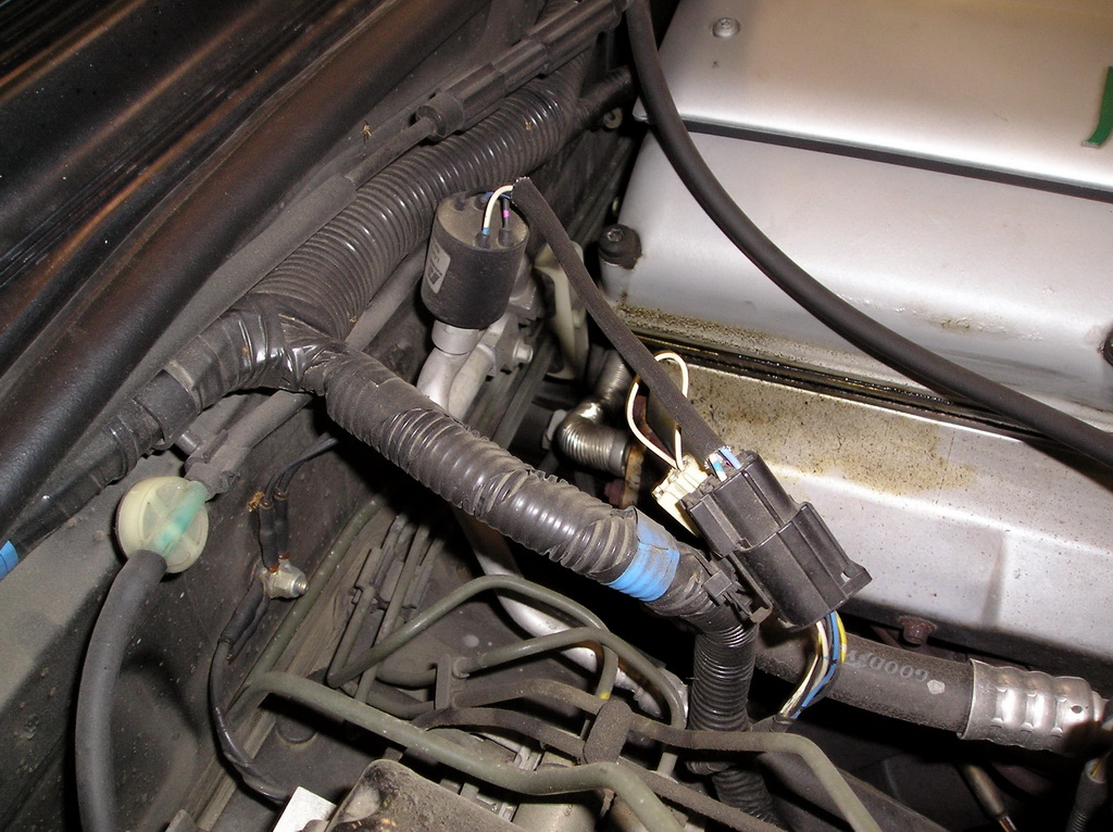

Originally Posted by etaent
Ok so the fans come on eventually and the car after sitting for a bit does begin to cool the ac quite well but it takes a bit. COuld this be because it is low on gas?
etaent,
Check your pressure switches like in the picture. See if you have the white looped wire or not. The fans were modified during the X300 run to help with poor cooling like you mention. The white connector, when looped, makes the cooling fans run on low speed at all times, unless the eng temp or A/C head pressure go up. Another problem this stops is blowing the fan fuse that sometimes happened if the fans jumped from a stop straight to high speed. If yours isn't looped, just cut the wires off the switch and connect them together.
There was a kit to add the loop connector and cap off the switch port after we removed it altogether. But I'm not sure they still supply the kit.
Cheers,
