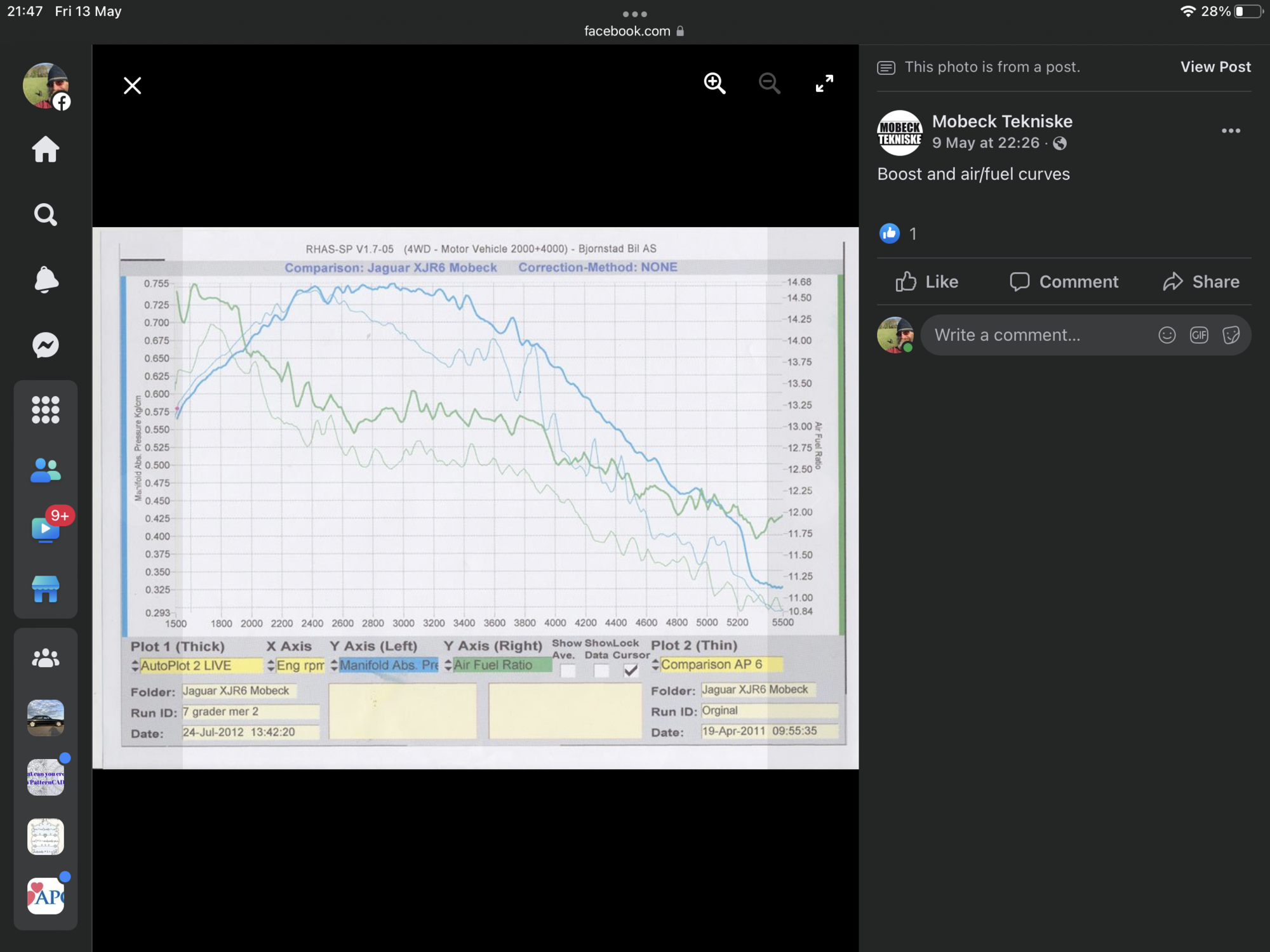

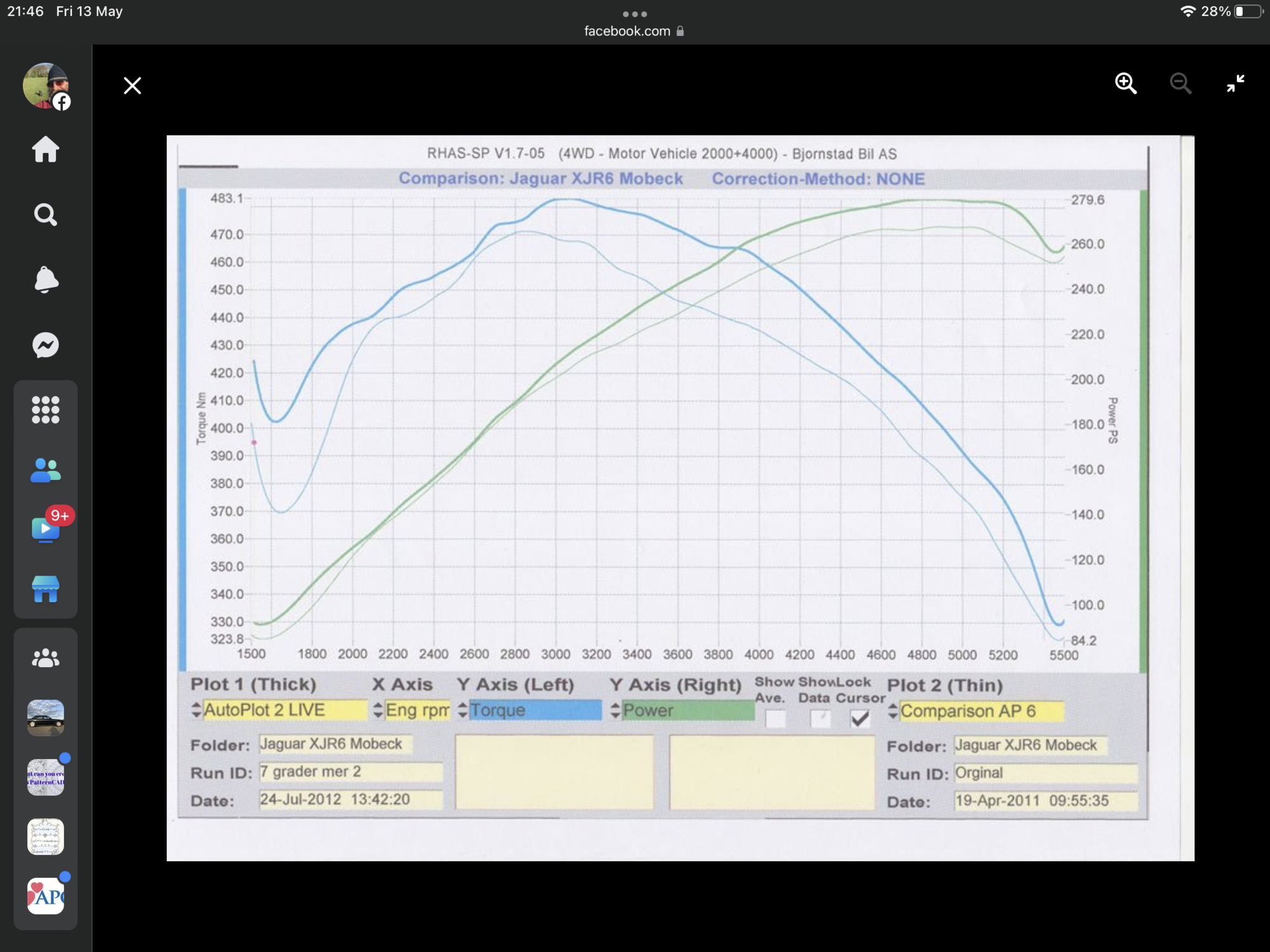

Yes it’s great on the XJR6, I have one fitted on mine, very happy.
Also for those who like these things there are dyno readings which I have stolen from Facebook post (NOT mine). These show improvement with Andy bracket also did a run with/without air filter (?)

Thanks for the dyno plots. It's great to be able to provide potential customers with evidence of the improvement from fitting my bracket, if used in conjunction with no air filter.
