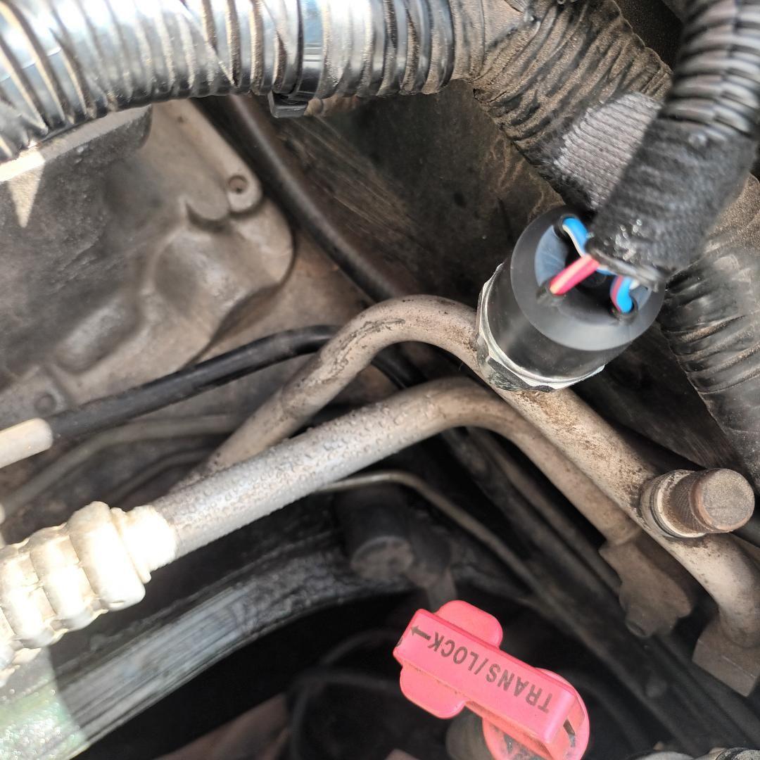

Please see attached photo of Air Con Pressure Sensor. Before fitting the new sensor, the fans ran slow all the time.
After fitting we charged with gas at 40 psi. But it was not cold enough. So upped the gas to 50 psi (normal for 90 degree heat here in Thailand).
After charging to 50 psi the air is cold ok but the fans run fast all the time and refuse to switch off.
Is the sensor so hypersensitive? What psi should we have?

Old May 20, 2026 | 01:25 PM
Parker 7's Avatar
Joined: Aug 2021
Posts: 4,682
Likes: 1,325
From: Kansas City
With lent on the cabin temp sensor it will bias the climate control , might clean it without using solvent ( there is a mini fan that draws air into sensor , bearings that can dry out )
This may " balance " your system and get your pressures in range to operate the fans in what you would expect
In general terms if the radiator fans do not dissipate the wanted to expel heat energy ( Q ) the freon pressure will build until the over pressure switch as the 4 wire switch will drop out your compressor clutch , this 4 wire switch does remain after TSB jumpering the 2 wire switch )
There is also the outside air temp sensor with the connector exposed to the elements in the front left wheel brake cooling duct from your front bumper
The cabin temp sensor is the small square louvered opening below the steering column that I'm afraid the whole lower kick panel has to be removed to get to car's front side of the panel
There is a control panel self test on the climate control that you can do seeing other things but does not " see " lent or marginal connectors , this will give you codes against a list
A common thing from reading causing performance issues is the thumbwheel on the center vent , this item was negated on the same Denso climate control system on the later X308
I try to find the codes list as the same as the X308
