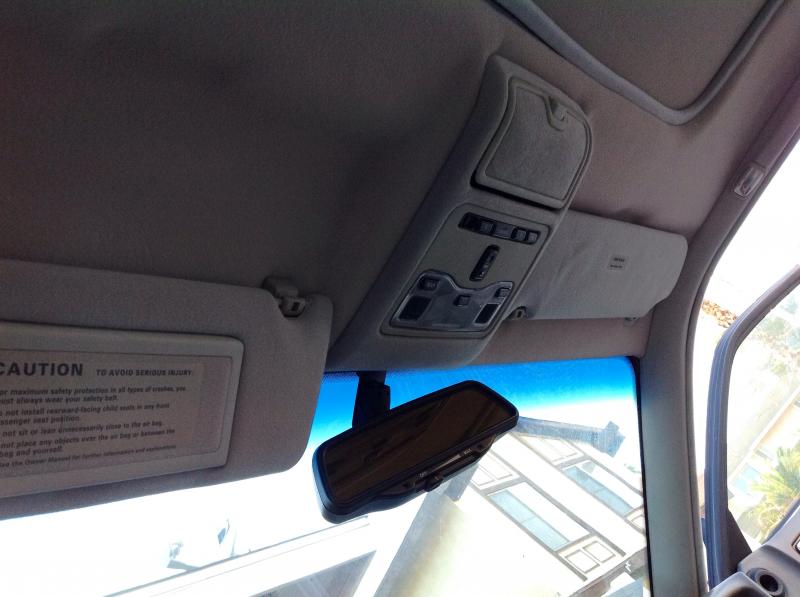

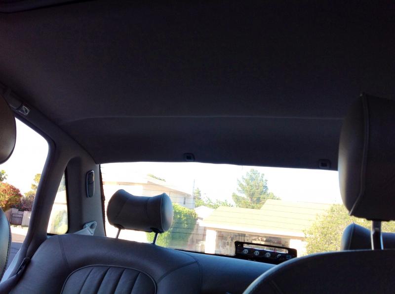

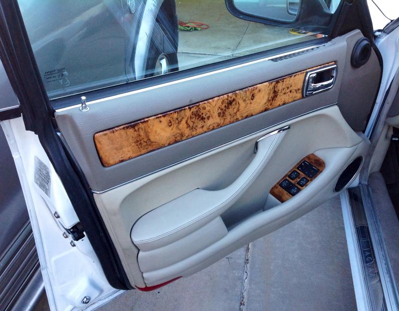

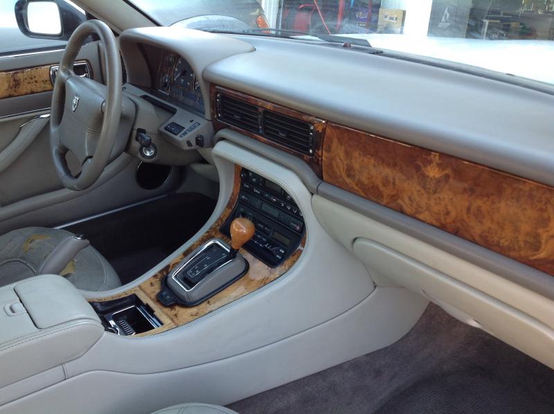

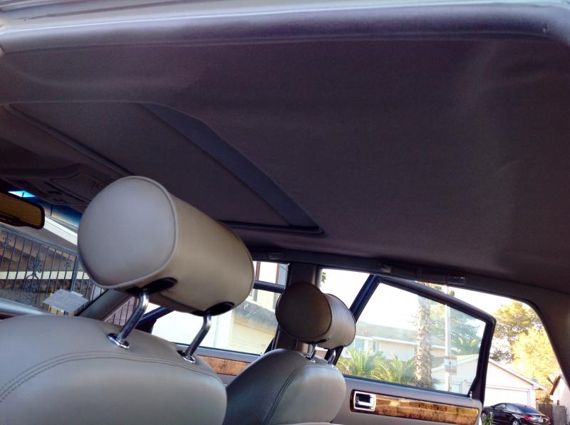

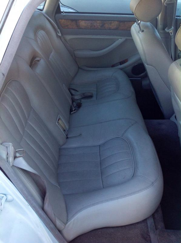

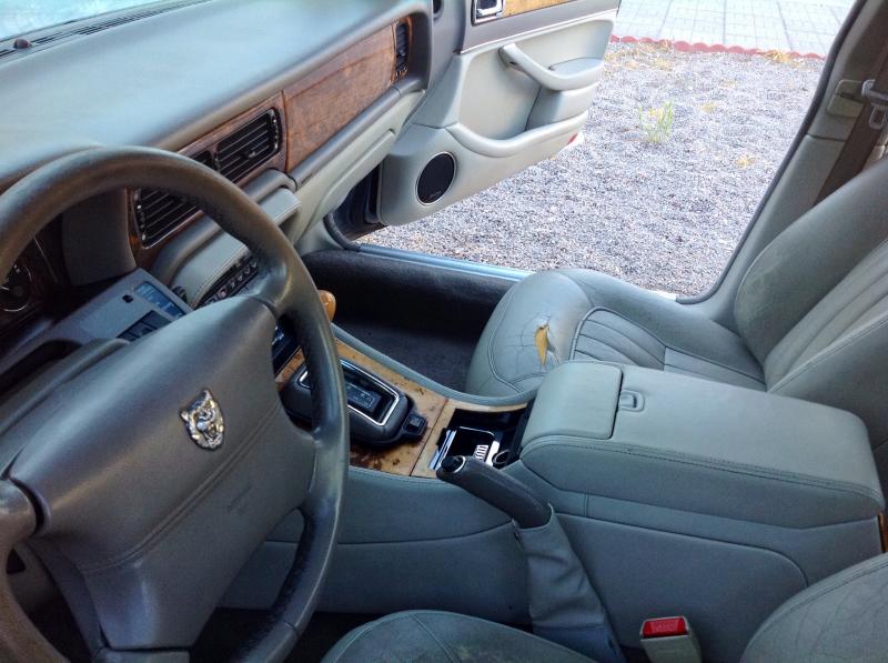

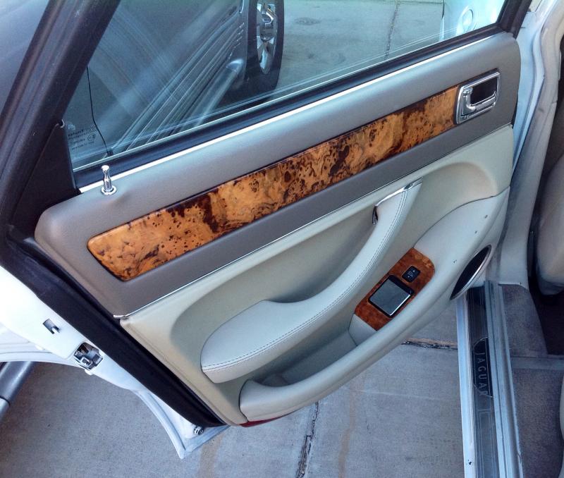

I did promise pics so here they are!
A couple of things about what you are seeing.
The front seats are going to be completely redone. I haven't done it yet because its going to cost a chunk of change and I don't want to make that investment until I am sure that the car runs solid continuously.
The headliner turned out OK. The problem that happened was that they did not leave the material hanging around the sunroof. This material is supposed to wrap around the metalwork of the sunroof frame and they wrapped it back on the headliner. Its ok for now but the headliner has a few distortions in it anyway so again, if the car proves a solid runner, I will buy a better headliner and have it redone.
There is NOTHING in these pics that I have not stripped down, redone, tweeked, repaired, glued, you name it. Almost the entire interior has been redone. The carpets are cleaner than they look in the pics. I will also be putting in a nice set of mats for the car as well as tinting all the glass and having the wheels powder-coated or replaced.
Right now, I need to finish off the mechanical and also get some other things fixed like the radio which only produces sound from one speaker. Thanks to everyone for the help so far but even when the car is plated and on the road (next 2 weeks) I will still have a host of things I want to do. Figured it would be better to have it on the road showing me where she needs help.
Bernie

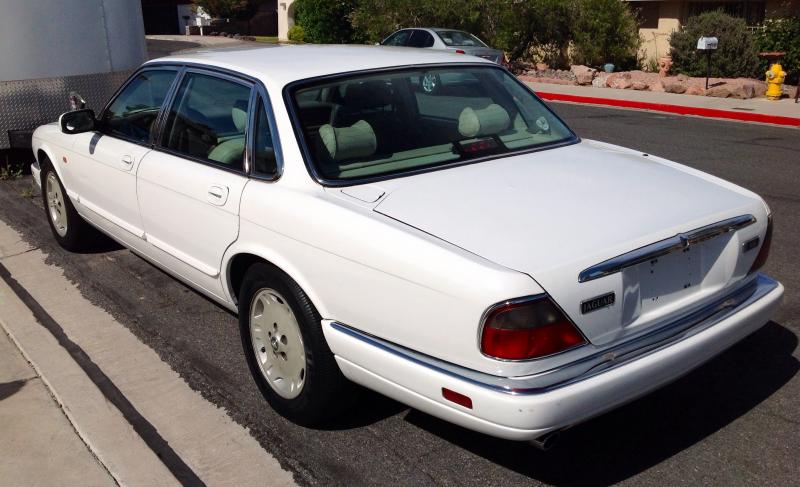

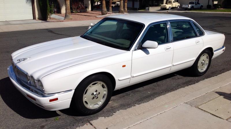

Took a few more pics of the Jag post carwash.
It was nice to see the months of dirt and grime come off the car after sitting in the driveway. Couple of more mechanical things to resolve and then its off to the window tinter.
Living in Vegas, its imperative for the interior and the passengers to have tinted windows. With temps of 120 F coming, that leather (whats left) needs all the help it can get!
