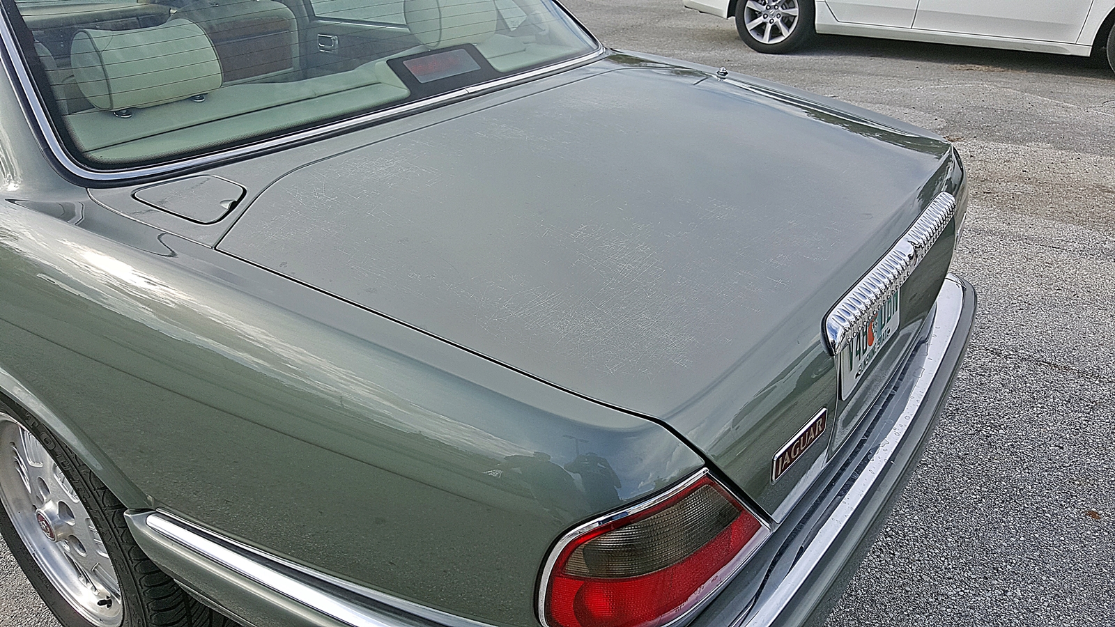

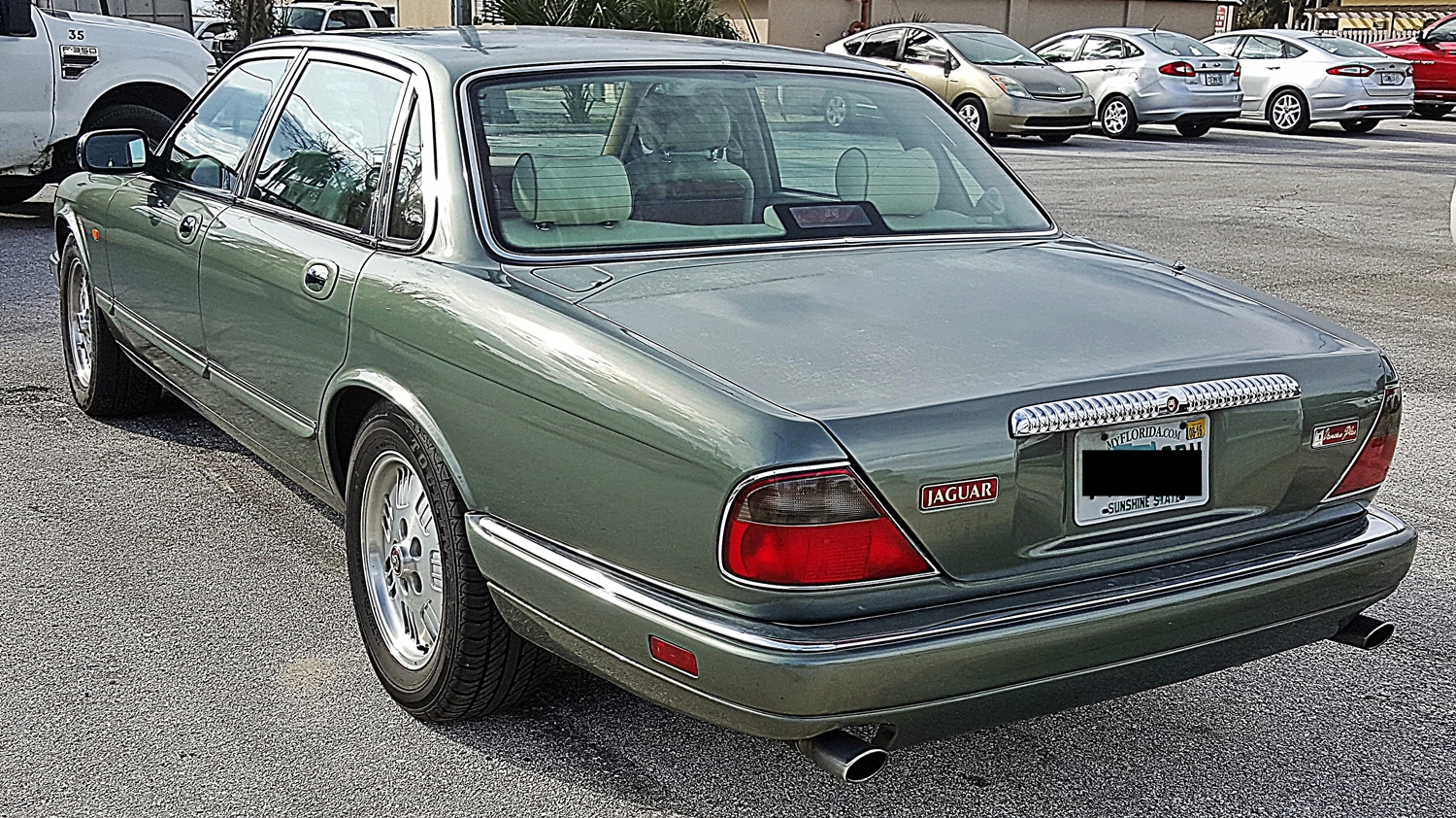

Sooo, here's the 1st pics of it. The roof and boot really need a respray. Some wear overall, cracked wheel wood finish etc. He never got the radio working and then the rear shock bushes that we know about. Maybe it's time to pony up and start out with less of a project. Thoughts? Note the checking on the trunk and roof.
