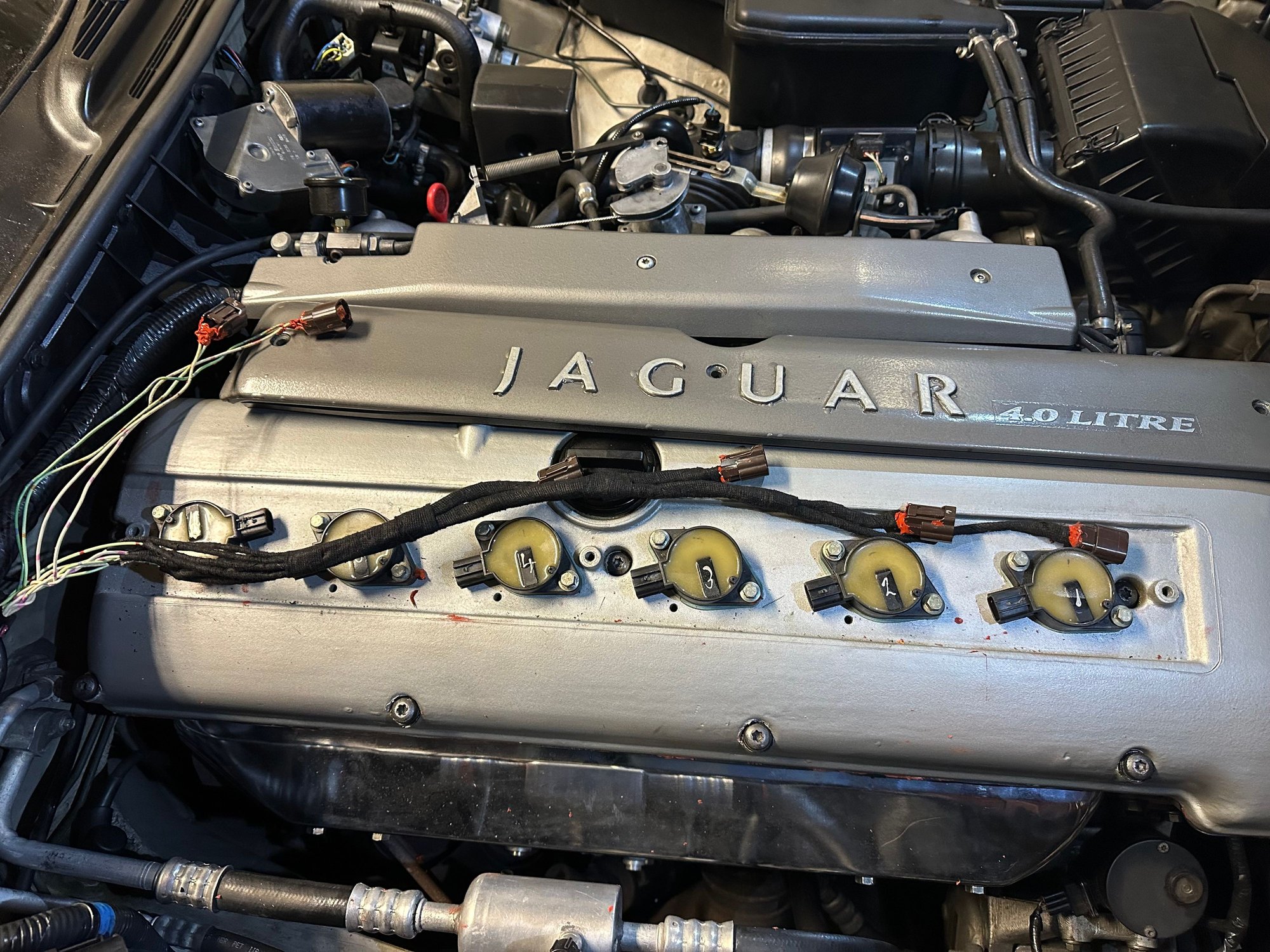

on the note of wiring. i know that there is broken insulation on my ignition coil wiring. (which i have reinsulated) how would i go about re-making this section of the harness with fresh wire as opposed to just insulating tape?
anyone know what the plug type on the coils is so i can get new plugs?
i assume the best bet would be to cut the harness near the back of the engine and run new wiring from there?
**just checked. clip is gone. wiring is seemingly insulated. maybe at some point it might be worth removing the outer electrical tape and checking the wires. but not when its cold and dark night outside.

Originally Posted by Spud Maat
always worth a look.
This is how I would do it...and I've done this for my TPS...and EGR, just because they share some wires.
1. I would buy correctly colored SXL wire. eBay can sell it to you in the color and lengths you want.
2. I would recommend Corsa Technic to buy wire harness parts.
3. I would order six of the connectors for the coil heads, Sumitomo 6195-0003 is the part you want....I believe.
4. Buy the OTHER end that connects into your Econoseal III 344111-1 ECU harness. Order the pin, and the seals. Make sure you have a crimper for this.
5. I think the other wire at this harness is ground. Check that before you do any of this.
I'm not recommending that this will solve your problem, but if you're looking for spend some quality time with the Jag...
Replace each wire one at a time. You can pull all of them through together, but just take your time and connect one wire at a time.
yeah the doing of wiring is not an issue. I know all that.
thanks for letting me know what the plugs are.
for now i will just strip it down and reinsulate all to make sure all is good.
i was thinking tho to cut harness behind engine and install an easy to access connector for if and when ever needed.
using of course waterproof connectors.
but yeah thats a bigger job for another day.

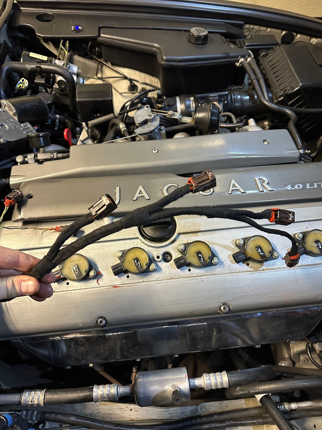

Been busy on the weekend and it’s dark when i get home in the afternoon so its tough trying to do anything but i have been working on repairing the wiring for
my ignition coils.
so i stripped back all the crusty dried electrical tape on them, and exposed all the cracked insulation some small sections of fully exposed wire with no insulation.
so i have put some silicone around the plug connections to insulate all there and am using some soft cloth heatproof electrical tape to reinsulate all the wiring.
little bit time consuming but worth it.
none of the actual wires are damaged, only the insulation.
currently done cyl 1,2,3,4.

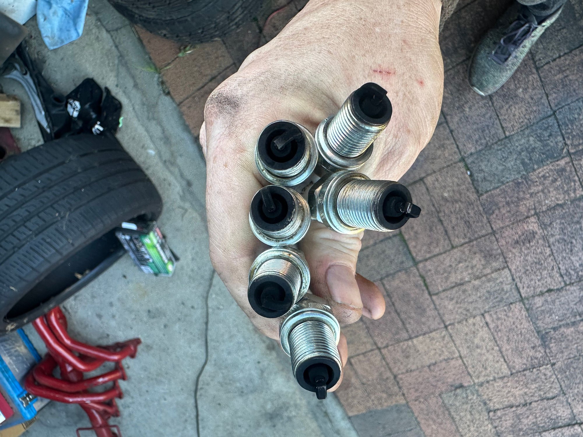

Took the plugs out and cleaned them yesterday.
Ran the car for less than one hour and have taken them out again.
my god they are black as.
shows just how rich it is running.

Those spark plugs you have pictured are extremely black & sooty, your car is never going run well with spark plugs in that state.
I have had plugs in that state when excess oil has leaked through from the plug/coil tubes and yes, the engine performed terribly, luckily the first thing I did was check the state of the plugs.
Your efforts appear all about solving air/fuel mix, have you considered a good compression test etc.
you perhaps have oil entering up past the piston rings.

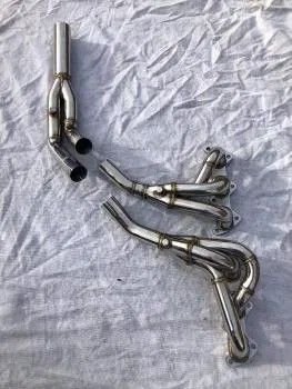

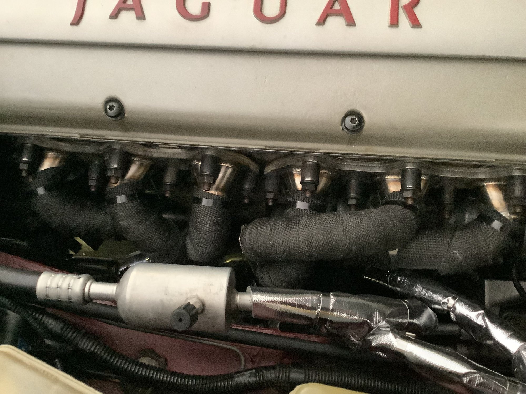

Just as a matter of interest, I recently fitted extractors on my XJR and was very pleased with the results, the engine appears much more responsive.
I also took the opportunity to install an extra 02 sensor which connected to an air/fuel ratio gauge.
I was also pleased with the results, my engine consistently running at 14.5 to 15 air/fuel ratio.

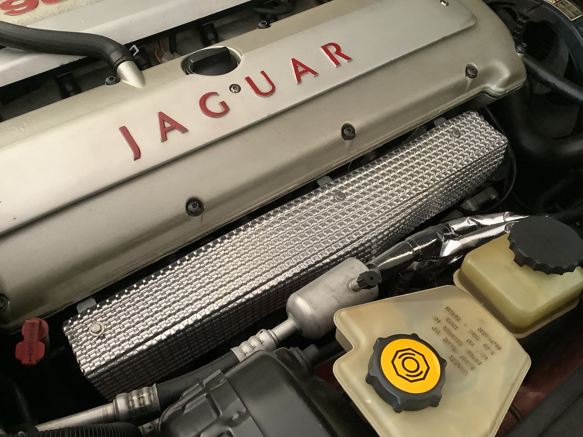

Pictures of the extractors are attached including one with heat shield I fabricated to suit.
The extractors were sourced from David Austin in the UK, he was a delight to deal with and I am pleased with the product.

oh yeah of course.
did you read how i said they were that black after only running the car for one hour after cleaning them!!!!!.
how they get that black that quick is big big concern.
I hope i am slowly making progress on this.
I had big problems with plugs swimming in oil back when i got the car but i since restored my valve cover and that issue is no longer there.
I need to get my hands on a compression tester to do it again.
I can't remember the exact results but i did a compression test early in 2023 (approx 15000 km ago) and all was very good at that point.
I am only speculation of course but do have thoughts of potential internal engine damage. the car does have almost 380000km on it.
getting increasingly concerned that internal damage is where i am at as i keep coming up fruitless with all other avenues.
