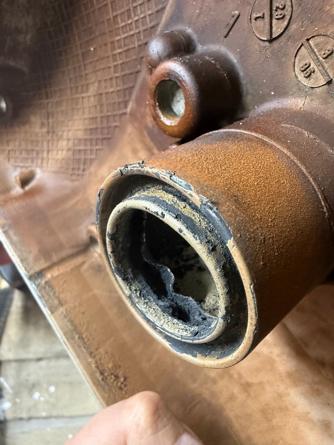

Oh i've forgot to write up. While my car seats headless (some bolts snapped so had to order a set) i've met that guy again as he wanted to connect my IDS just for routine check and marry the spare fob. So we've got a time to swap his coils with mine used 94 factory set and see how it runs. It runs absolutely same smooth hot or cold with no misfire. His coils are Lucas with small green stickers with Jaguar p/n and no black "made in Japan" labels with date codes of 20ish weeks of 2002. And i've checked the resistance on them. All 6 are like 0.9 ohm primary and infinite on secondary both ways just as all 10 Jaguar coils of 4 different types i have. So most likely original coils do have some suppressor schematics inside which cuts the secondary and brings the resistance test useless. Also i've found some old threads on Jag-Lovers forum where people discussed the smaller 0.030 spark gap as a measure to extend the coils life with some positive results achieved.
Still thinking about how come the Jaguar coils are that weak? Many over plug coils on other cars run for years even being a duplicates. Might be a really the spark gap choice is wrong? When i took off my cam cover i've found one interesting thing - cylinder 1 and 6 coil wells are not round inside and and inner and outer rims are not flat.
At the first sight i thought it's a paint peel but no. It looks like a sleeve pressed or welded into the well and it is badly distorted plus there are some carbon or oxidation deposits seats there. And it is exactly where the contact rod spring in the plug boot meets the coil. For me it looks like the spark damage. Good thing i've planned to replace the cover as mine is very ugly outside so i've bought the replacement in near perfect condition.
So might be the whole engineering on coil is a fail. I might be a beginner in an aged Jaguar world but i've seen pretty much a lot of other COP systems and most of them either keep the coil outside the cover reaching the plug with a long reliable isolated boot or done with much smaller diameter and also well isolated. Like this
BTW it's a UF553 coil for Ford/Mazda 3.7 V6 engine. It has very similar length of 133mm and also a 2-pin. They are cheap even being an OEM Motorcraft so probably i'll try to test one or two of them as a substitute...
did it read infinite resistance when set to mega ohms?
also keen to hear of any suitable substitutes.
ah yes valve cover issues.
i resurfaced my valve cover when i did repairs and flattened it out. they were out of round and wavy not flat.
Yes it did.
