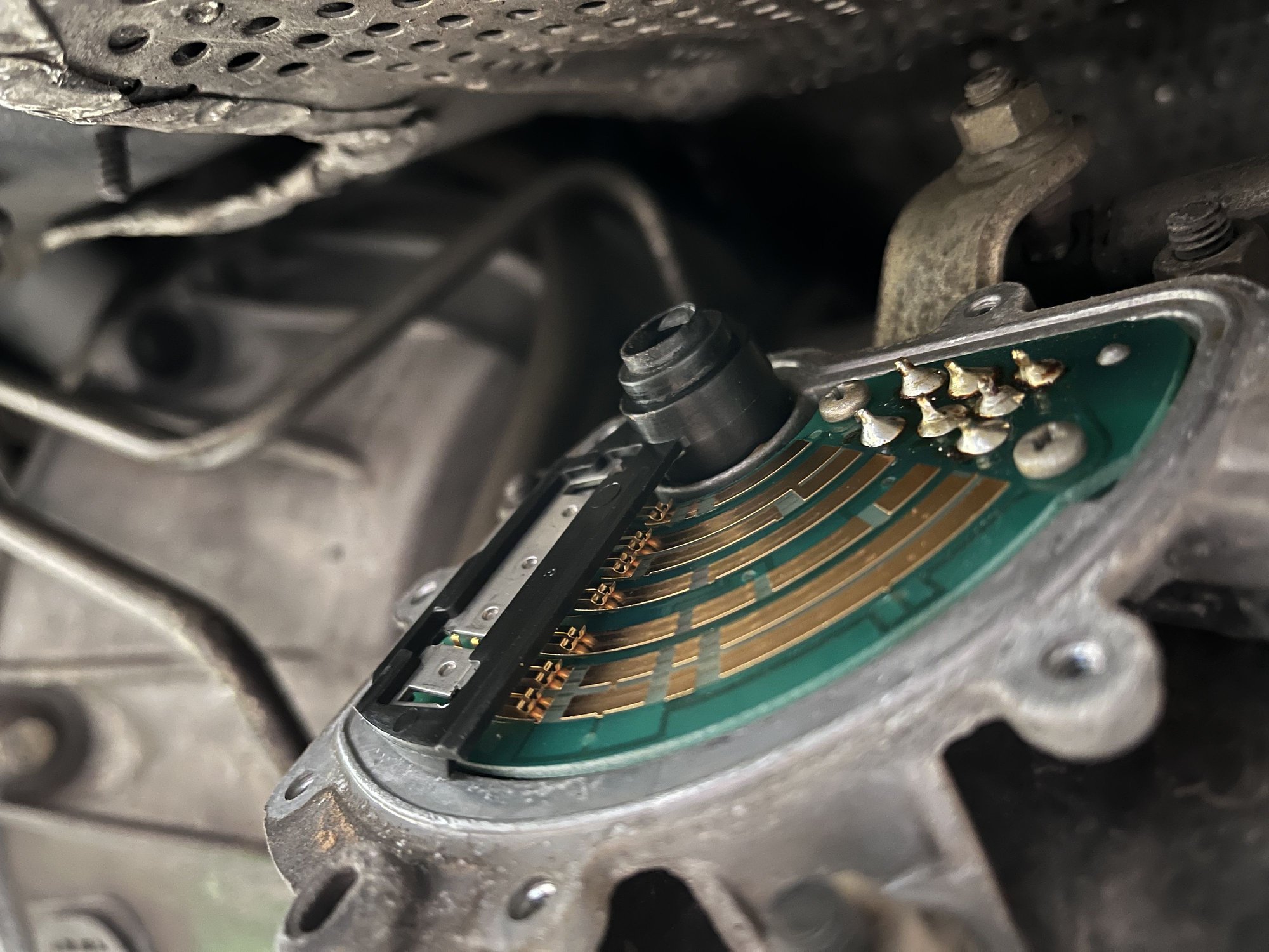

Right! The trunk light connector. One of mine is not working anyway so a detached inspection out of the cold is necessary anyways.
From what it felt like at the time, the solenoids did not seem to functioning correctly. On one of the many flushes I did after the aggressive driving (using the J gate as it was intended with moderate acceleration and cornering for no more than 30 seconds which threw the transmission into a fit) there were some distinctive metal shavings on my drain plug. I did not like that, and figured there was some misalignment with what the gear selector is indicating and what is actually being selected - or not selected; maybe it was selecting in-between a gear.
This lead me to the swiper I was talking about connected to the physical J gate selector you move with your hand. I can't find it on the colorful ZF4H image you provided.
I believe I have a picture though...
So this little guy I worked with cafeflyer to make sure visually everything lined up and that all the contacts were rubbing against each other and nothing was loose.
Oh, I do remember tugging on that plug and making sure it was tight and snug, and of course clean. No leaks on this car (beside the power steering rack... problem for another day)
I'm really not sure how beat on this car was before my step-grandfather got it and drove it, then giving it to us once it was on its deathbed needing, well, everything these cars need. I think at this point the transmission since the issue came has had 5 or 6 cycles of draining and refilling.
Old fluid and shavings being dislodged, mixed with the newer slurry, cycling around, and getting stuck in a solenoid?
Sigh*

Your pic should be the rotary position switch , this next to the torque converter in your pic
There are elongated holes on the attachment bolts to keep track of before removing
The transmission itself is bullet proof
Do I see a kinked line in the middle of your pic
PS fluid leak , the old hose material ( resivour fittings ( squishes out of shape over the years , cut about 1 inch off and reclanp , the leak makes fluid go everywhere
Your transmission to car linkage should be in the broken into 6 parts on post # 4
