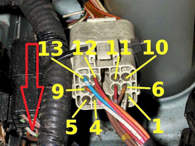

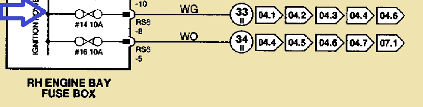

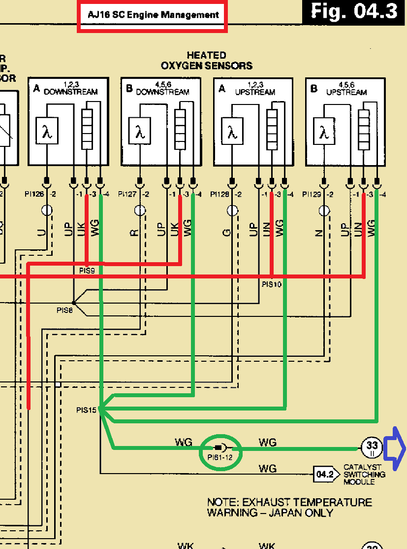

Black 4 for ground inside ECU for downstream sensors
Black 30 for ground inside ECU for upstream sensors
Power being sucked down by the Japan wire ?
Check the Papa Indy 61 connector for common corrosion located below washer filler cap
Attached Thumbnails Closed loop lambda control-x300-o2-heaters.png   Closed loop lambda control-x300-heater-fuse-untitled.png

Old Aug 29, 2017 | 09:23 AM
  #70
Lady Penelope's Avatar
Joined: Apr 2017
Posts: 4,039
Likes: 1,397
From: Kansas City USA
You can swap the king relays in the left and right engine fuse boxes for they may show voltage but have a pitted contact not allowing enough current . Clean the ECU case ground as well as the grounds on the upper left and right on the rear engine firewall . The O2 sensor is very sensitive intelligence carrying signal so it's shielding ground is important . The large ground right by the starter gives the engine problems although it looks OK it's whats under the hardware . All the power to the heaters go through the Papa Indy 61 connector so don't neglect looking at it . I cut mine out and threw it away replacing with splices it looked so bad and not wanting to see it give future problems . This is someone else pics of the Papa Indy 1 connector next to the 61 as the black one . I put a red arrow on the White/Green stripe wire that is your heater . You can jumper wire around the connector for that wire . The one below that is your smog pump . # 4 is your all 6 coils power source wire through the coils to the timed 6 grounds in the ECU .
Attached Thumbnails Closed loop lambda control-jaguar-8ecmplug1.jpg   Closed loop lambda control-jaguar-8ecmplugpins.jpg
