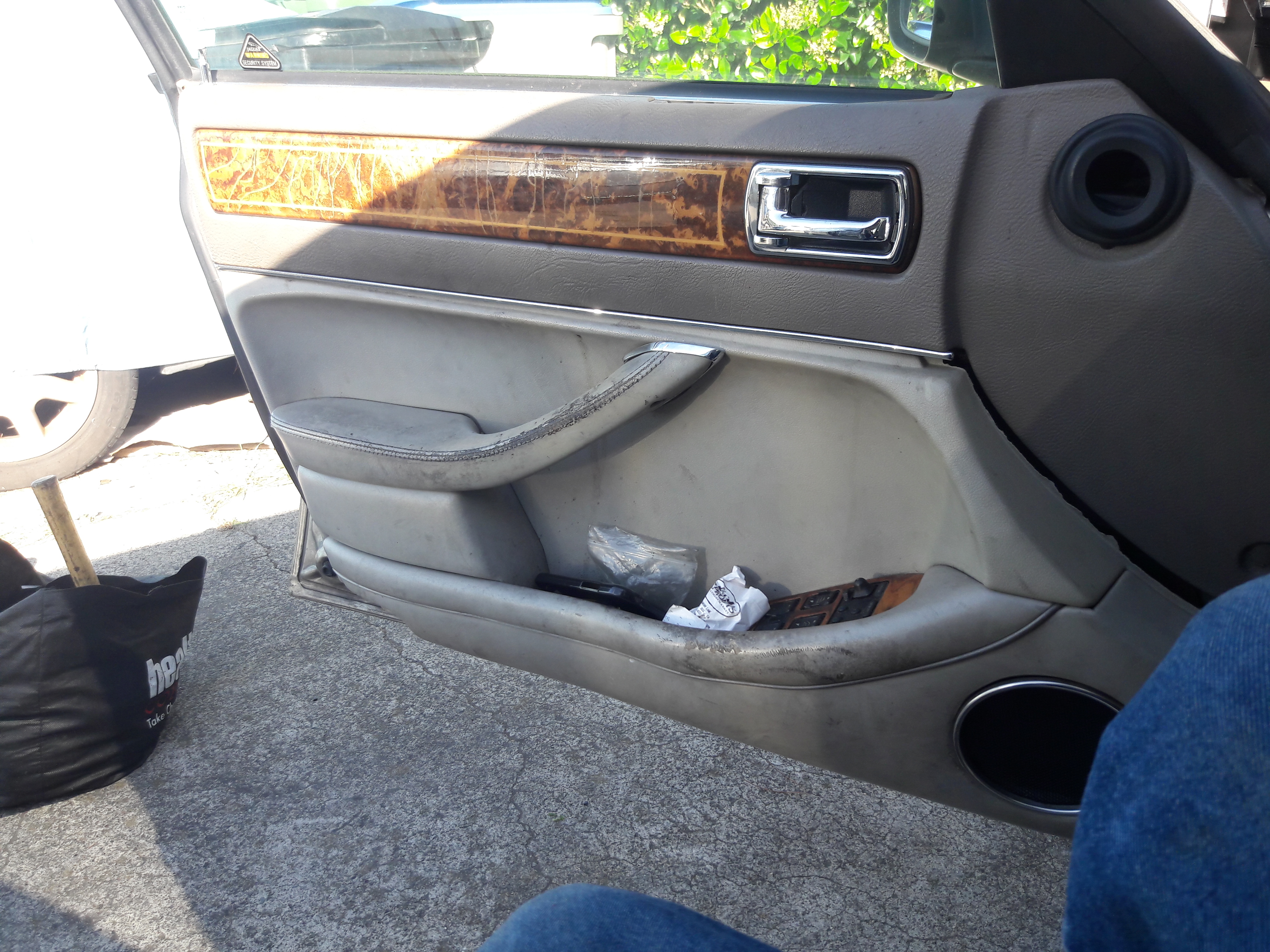

Problems i had that made me do the repair
A) Driver Door Would Not Lock With Fob Or Key
B) All Locks Would Cycle (go up and down a bunch of times)
C) Could Not Open The Door From The Inside
Parts I Installed to Fix the Problem
A) Used Micro Switch
B) Door Cable
Tips :
Roll the window down half way
Leave battery connected until you roll the window down
Where gloves and keep towels and some cleaner near by
Keep some cardboard to lay the window on
Note where every cable / wire is leading to and make sure not to cross them
Go Ahead and open the Front Driver Door

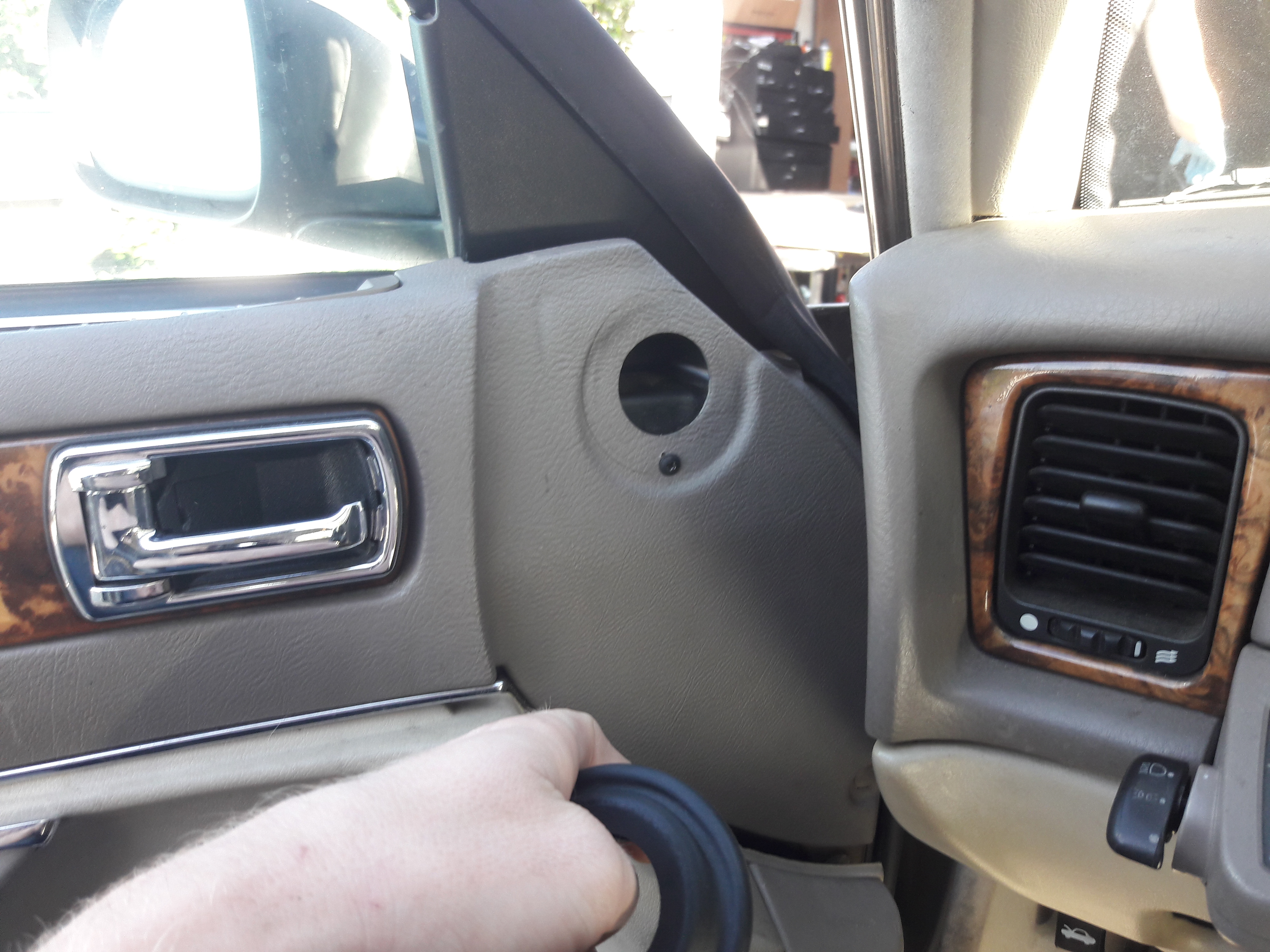

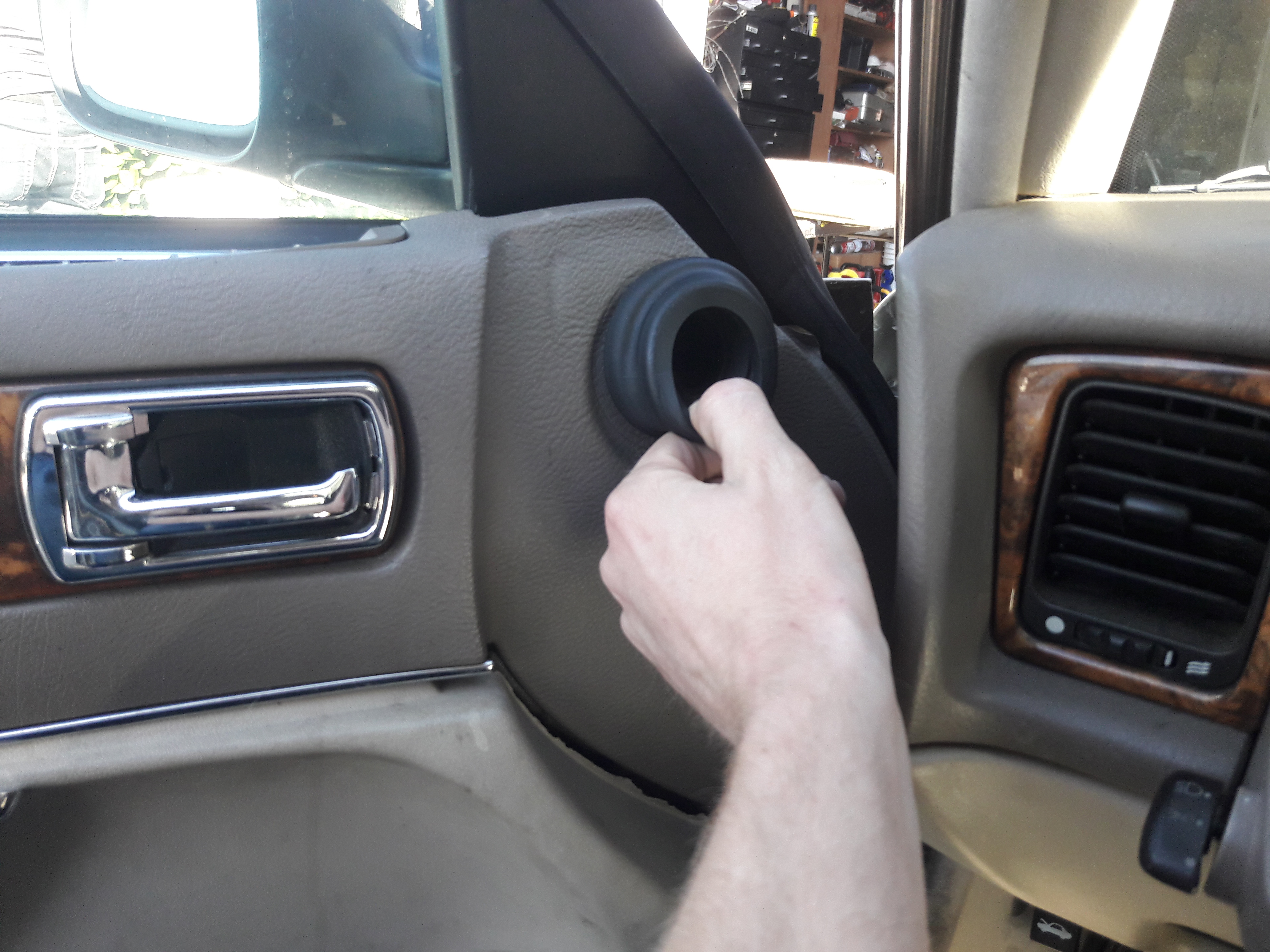

Go Ahead An Pull Off the rubber boot on the side
Attached Thumbnails D.I.Y Front Driver Door Micro Switch And Door Cable Repair!-20170428_172714.jpg   D.I.Y Front Driver Door Micro Switch And Door Cable Repair!-20170428_172725.jpg

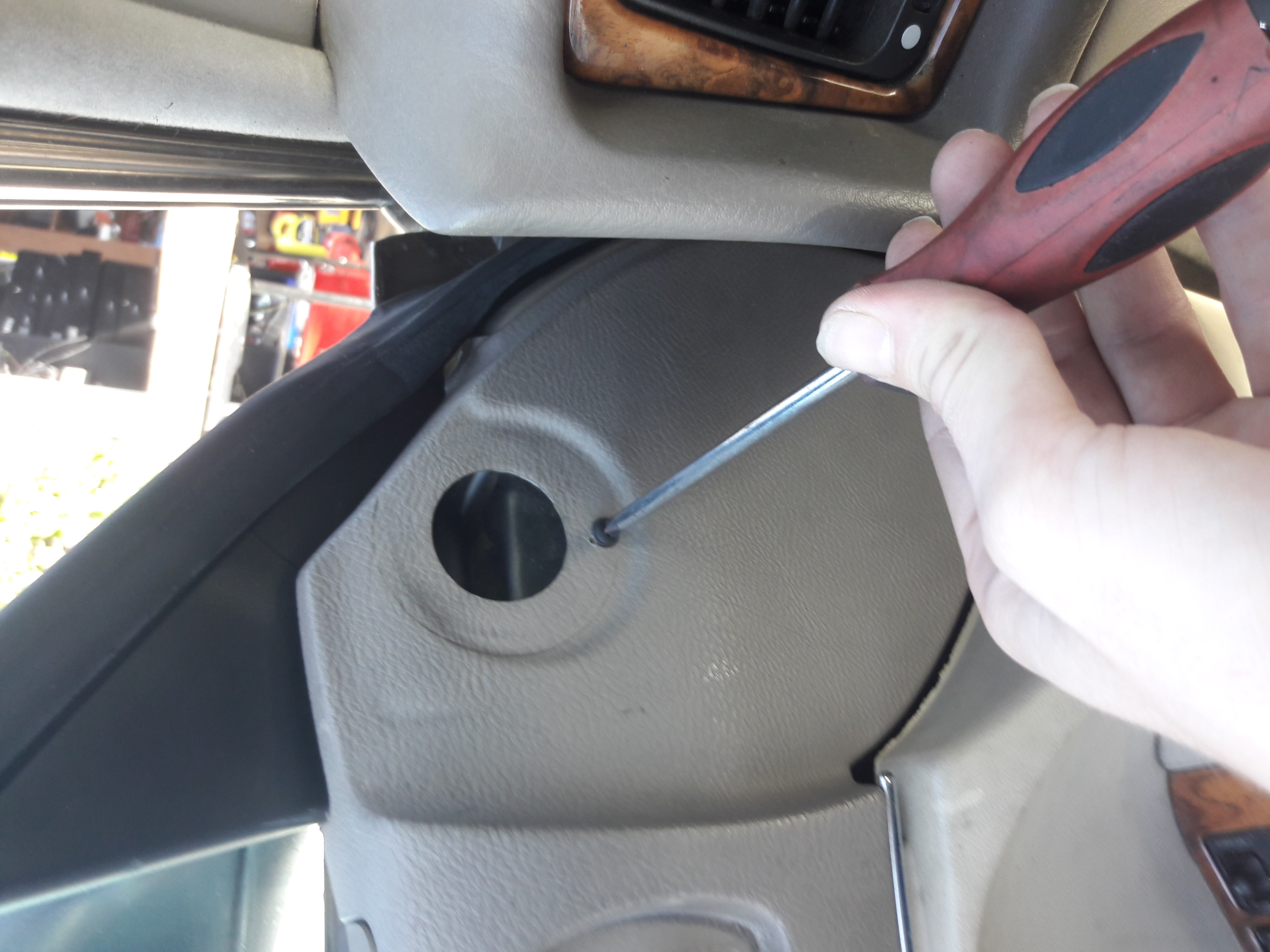

From: san jose

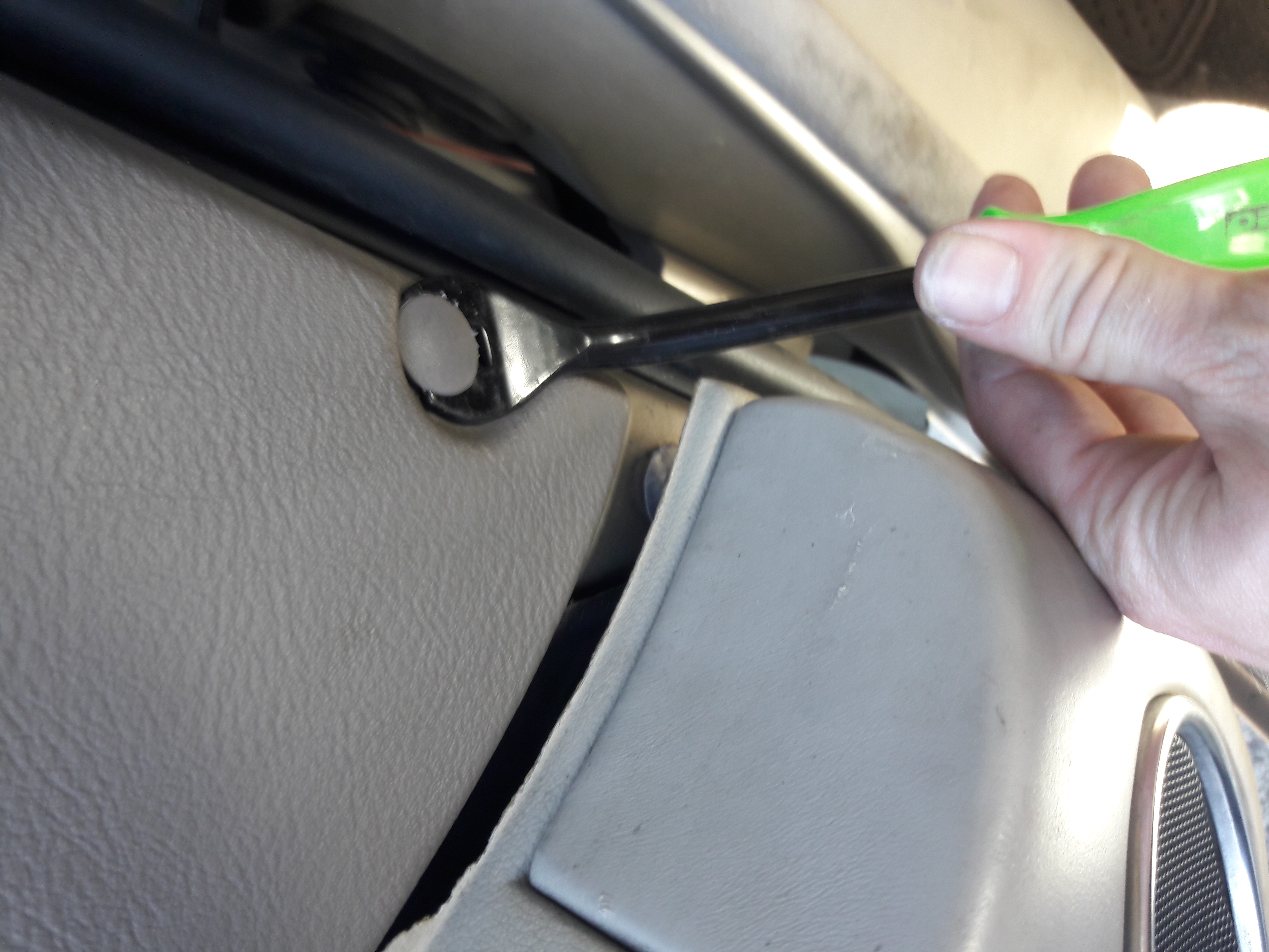

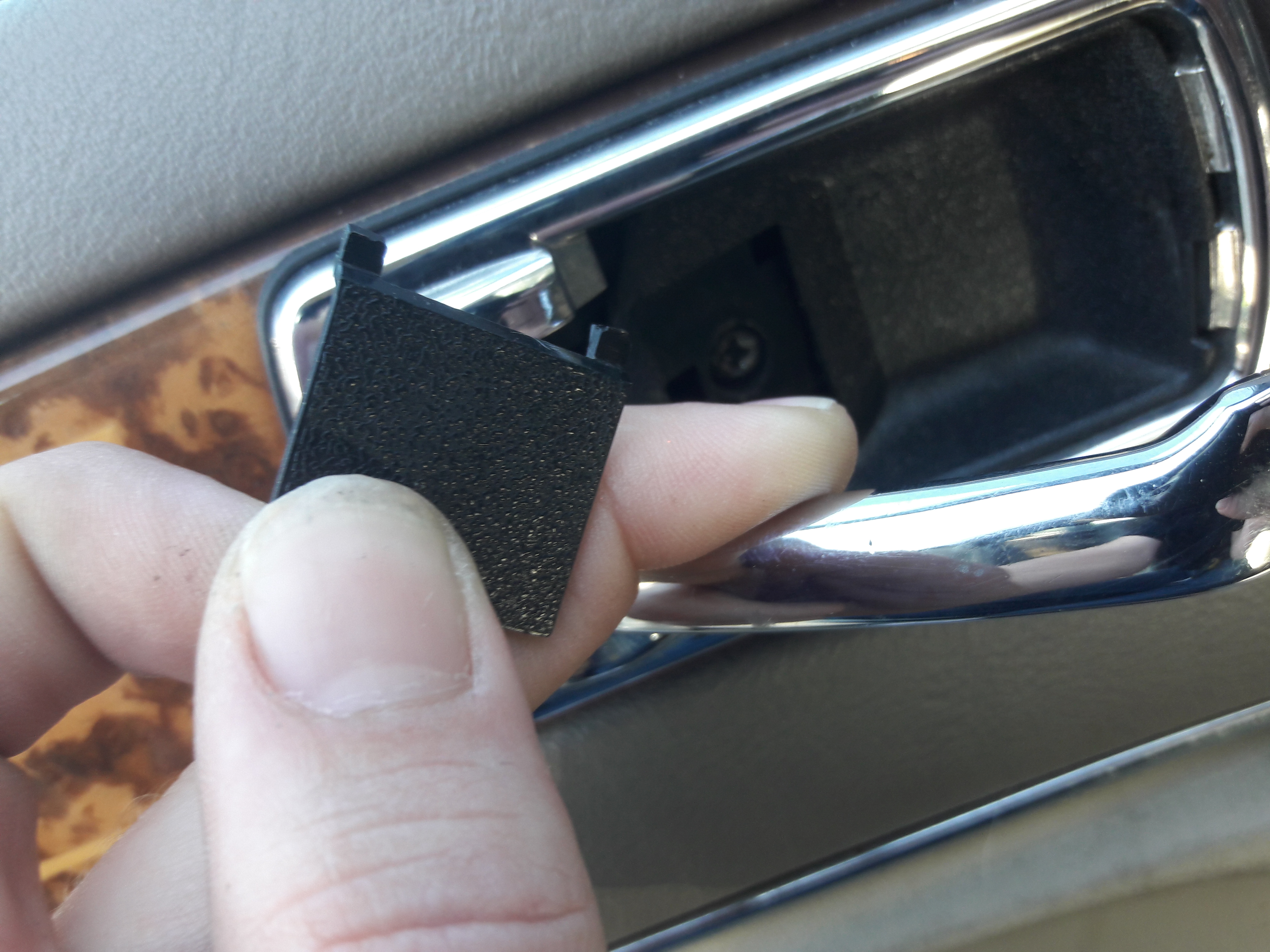

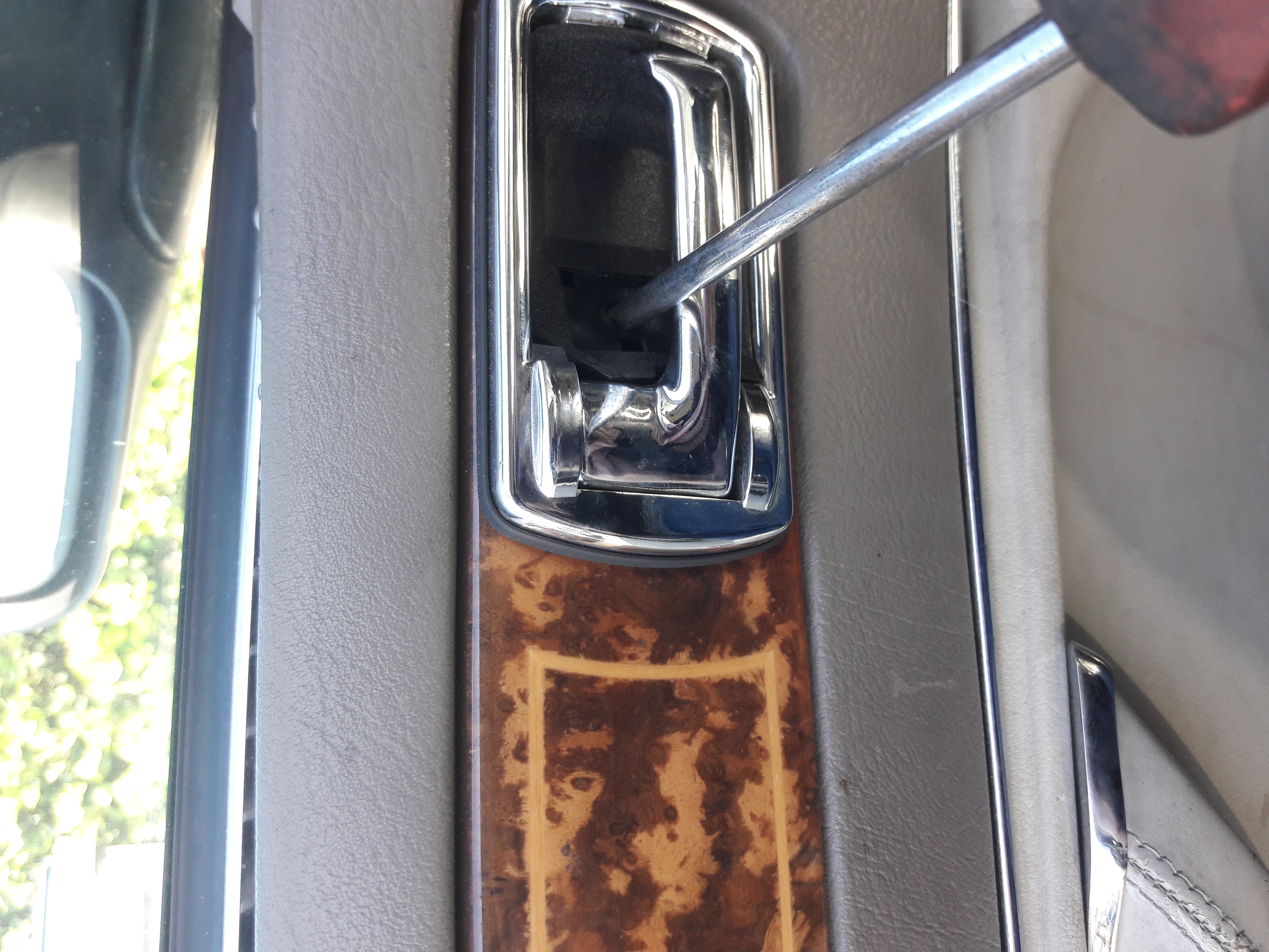

Take a Pick (i used a screwdriver) And remove the cover behind the inside driver handle
Attached Thumbnails D.I.Y Front Driver Door Micro Switch And Door Cable Repair!-20170428_172751.jpg   D.I.Y Front Driver Door Micro Switch And Door Cable Repair!-20170428_172815.jpg
Old May 5, 2017 | 10:52 PM
vandenplas408's Avatar
Posts: 313
Likes: 84
From: san jose

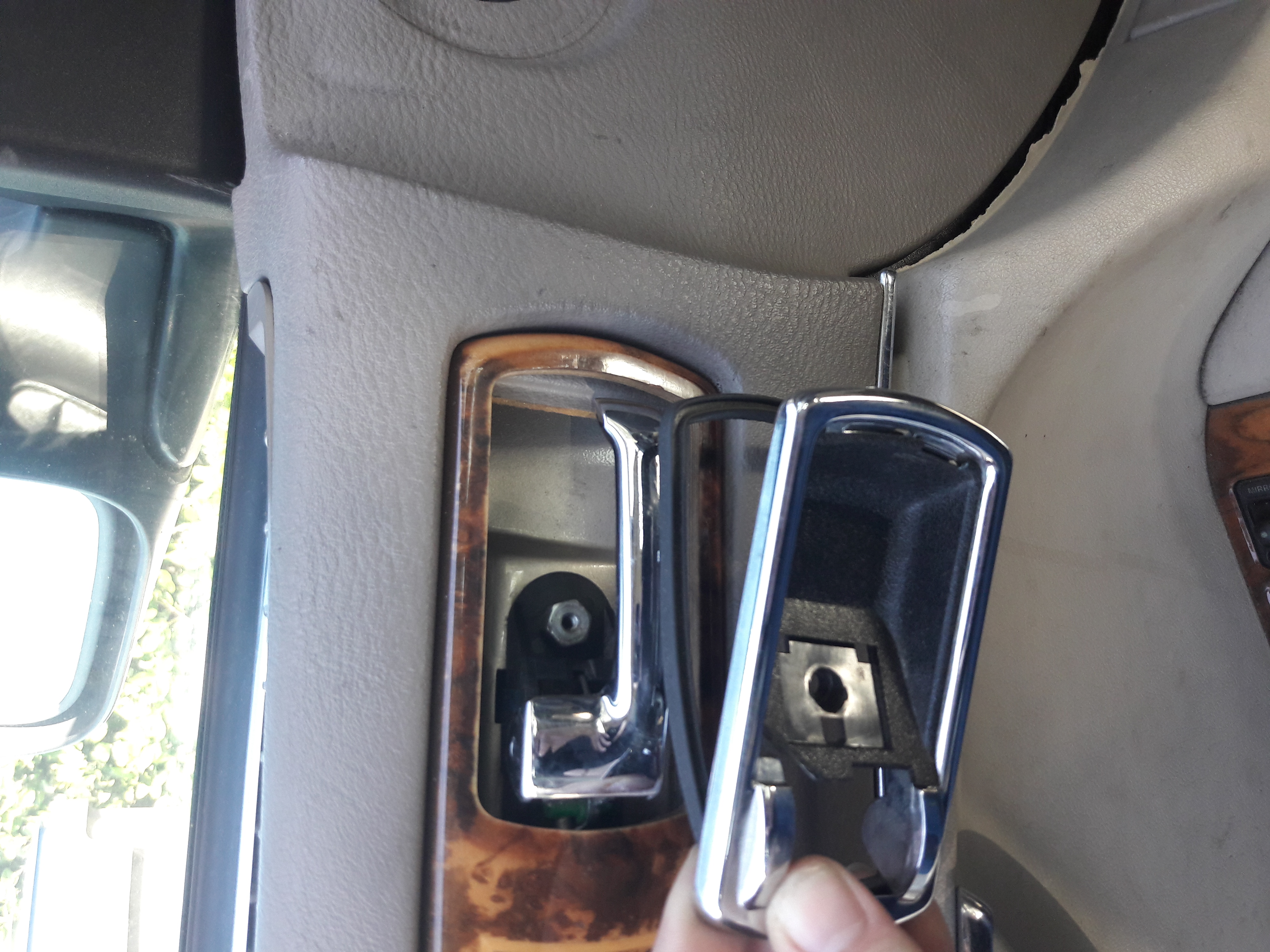

Take A Phillips Screwdriver and remove the Hidden screw behind the cover
Pull off the Gasket and Door handle Cover

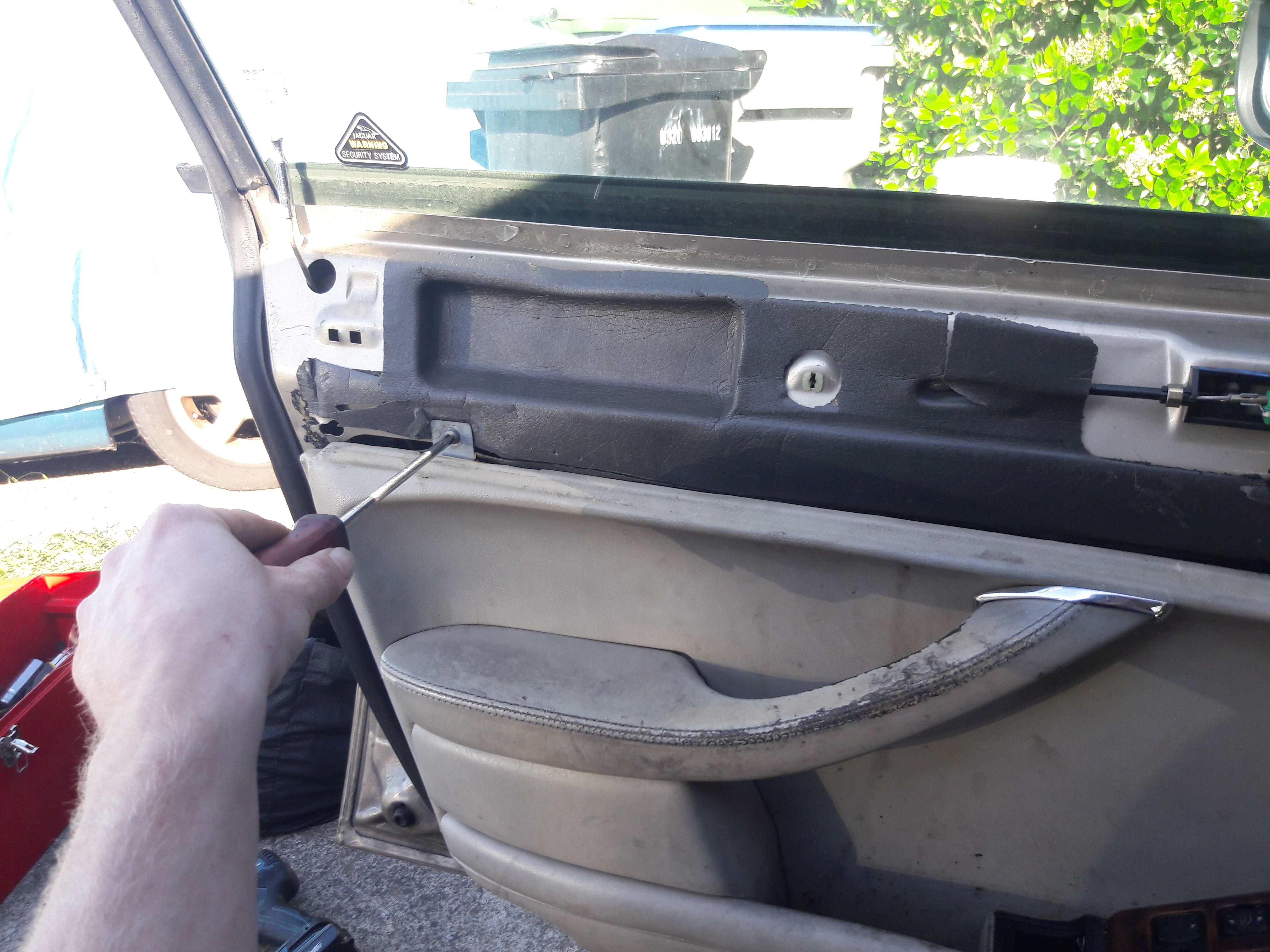

On the Bottom Right (below the rubber boot)
Remove the Door Panel Locking Tab with a Trim Removal tool
Attached Thumbnails D.I.Y Front Driver Door Micro Switch And Door Cable Repair!-20170428_173253.jpg   D.I.Y Front Driver Door Micro Switch And Door Cable Repair!-20170428_173310.jpg

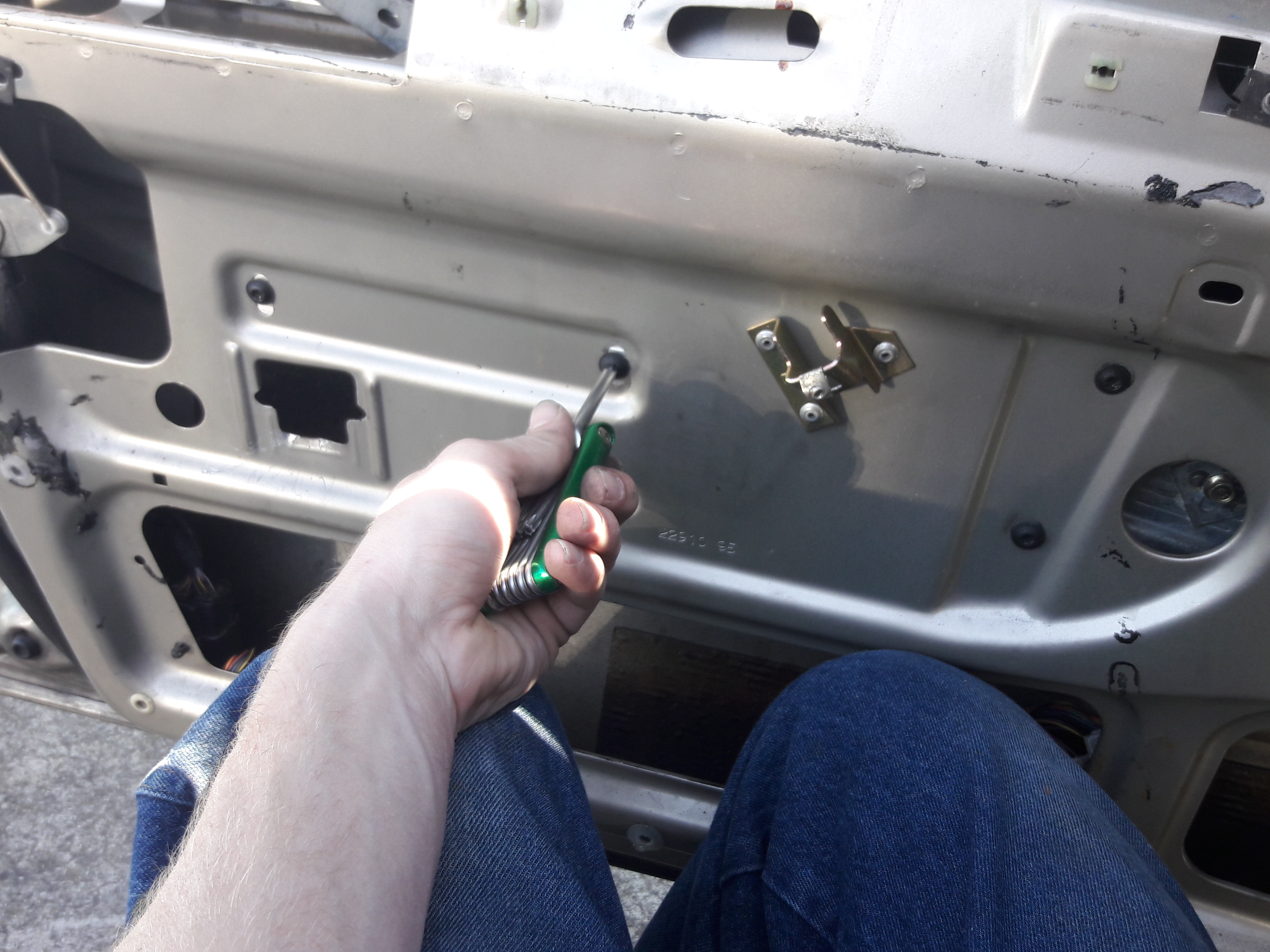

Remove this Phillips Screw that was hidden by the door panel
Attached Thumbnails D.I.Y Front Driver Door Micro Switch And Door Cable Repair!-20170428_173356.jpg

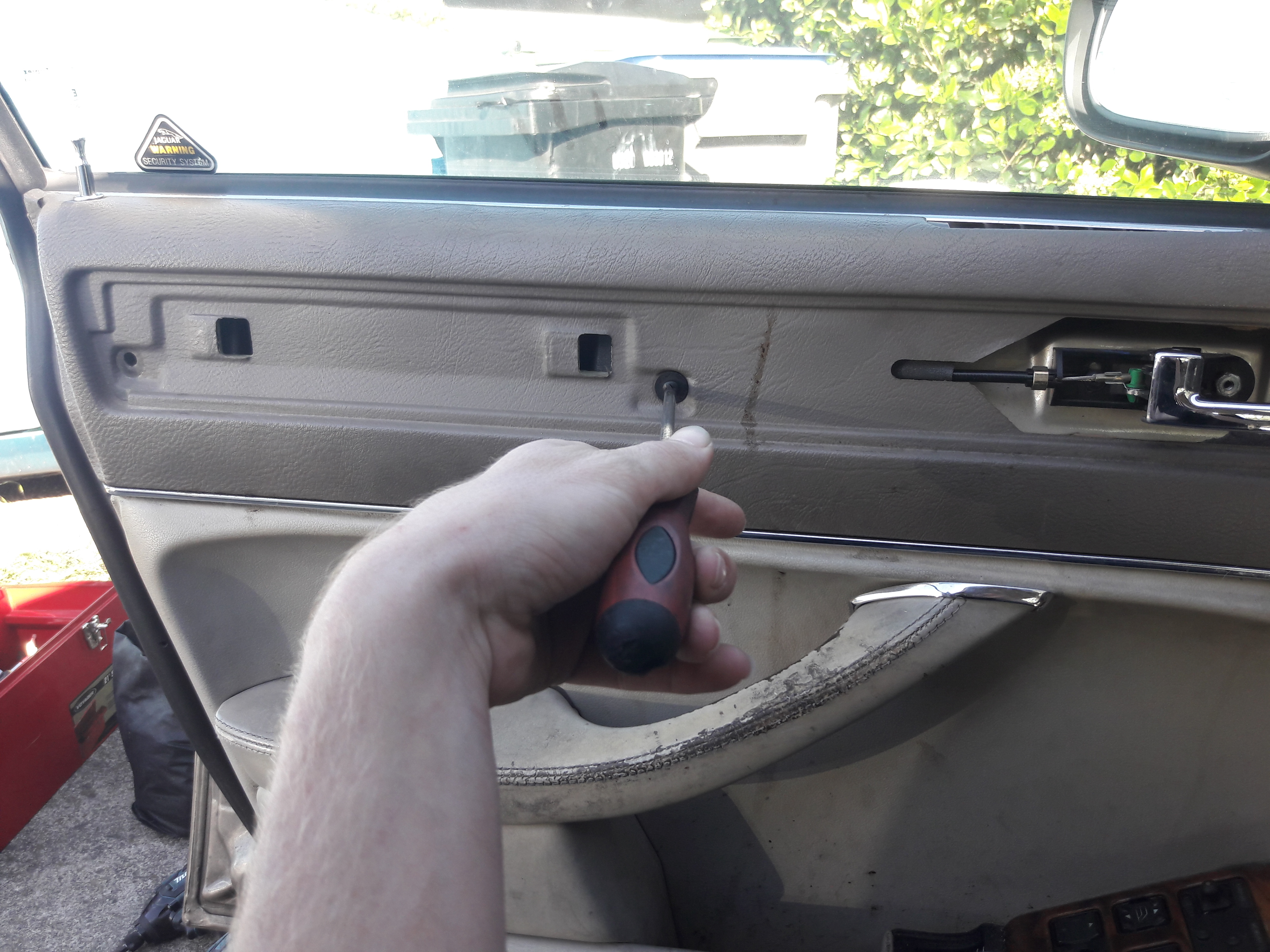

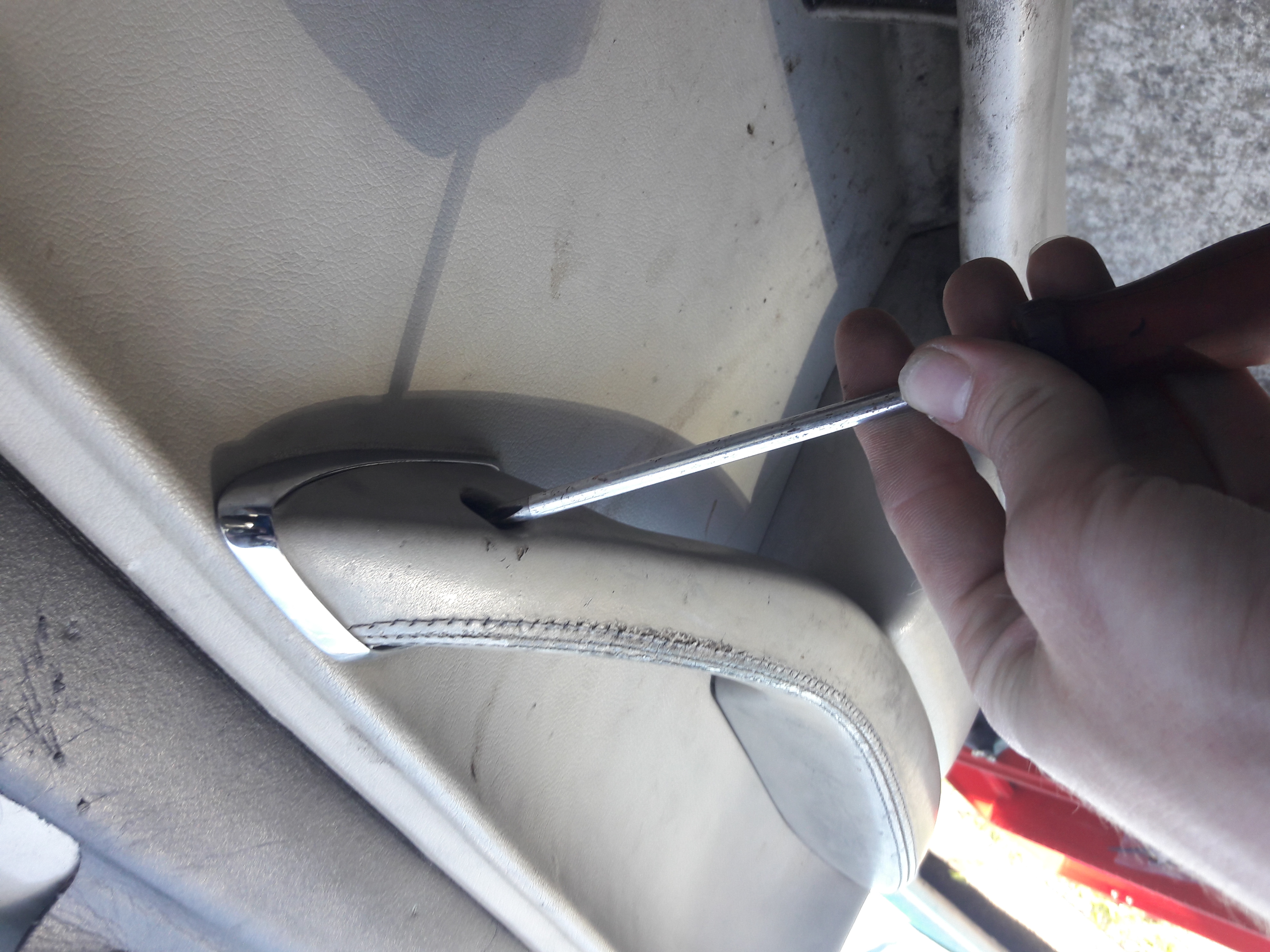

remove the cap under the arm bar on the door panel
use a screw driver to remove

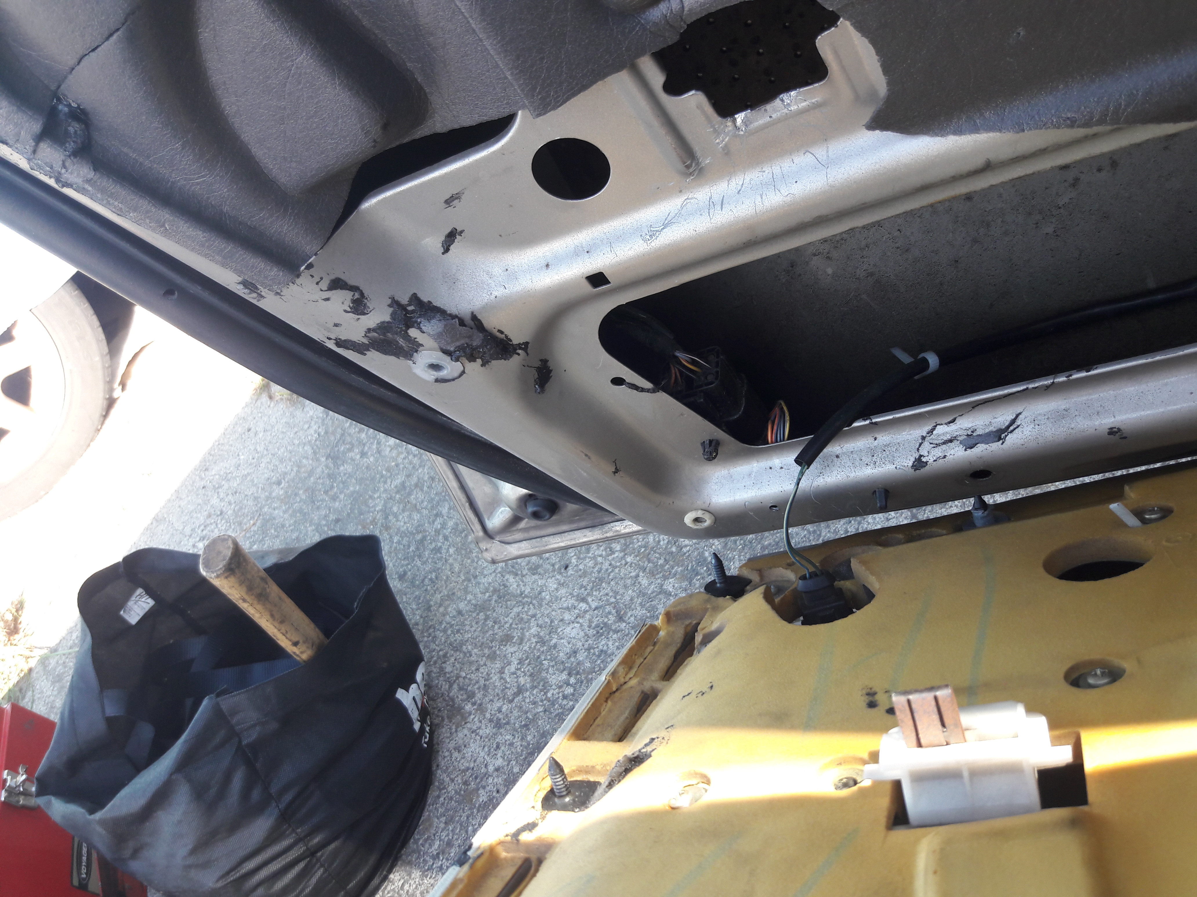

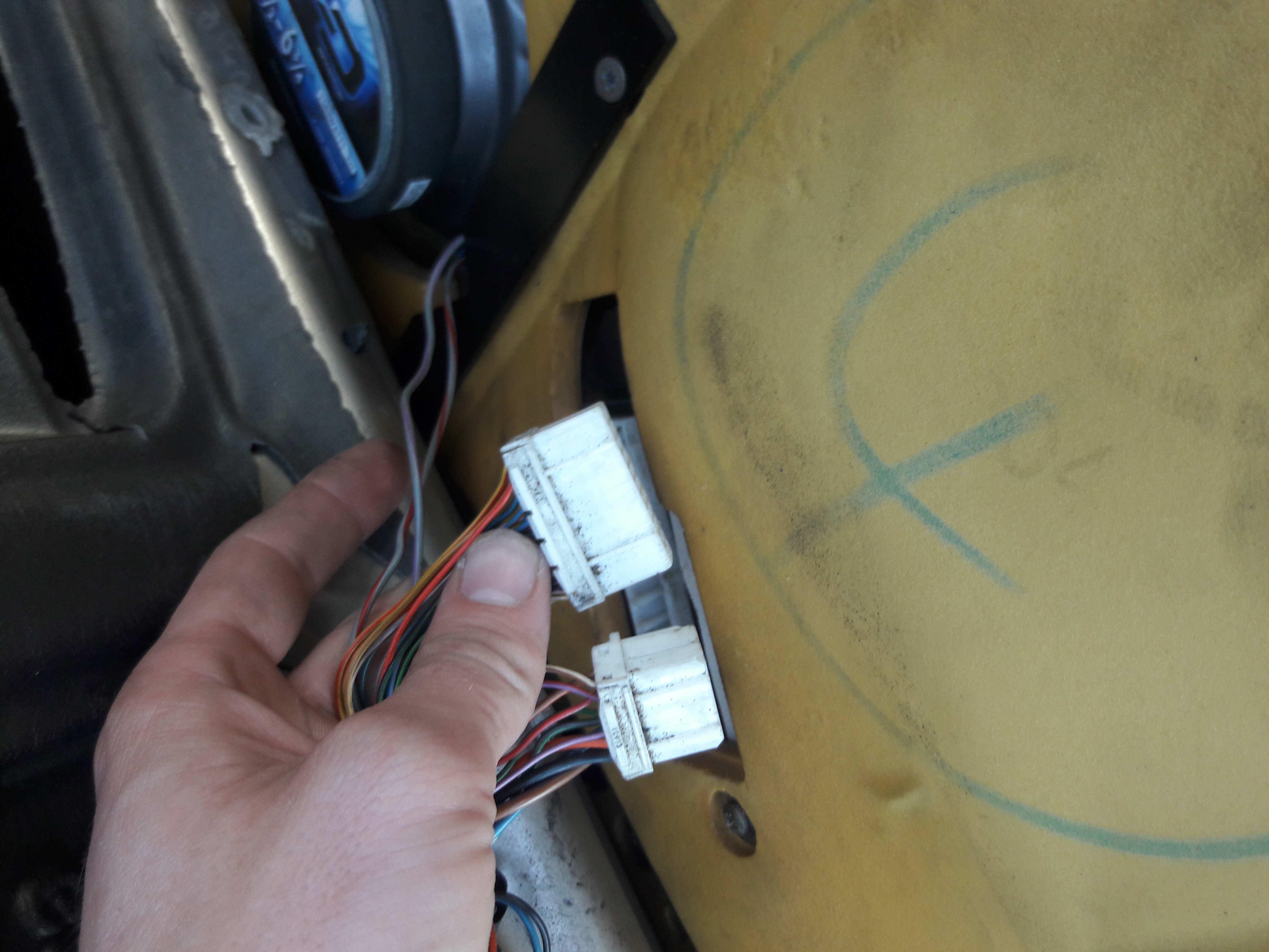

Start to remove the electric connectors
( Make sure the window is half way rolled down)
(disconnect the battery before removing the connectors)
That is for the door panel light
Attached Thumbnails D.I.Y Front Driver Door Micro Switch And Door Cable Repair!-20170428_173513.jpg   D.I.Y Front Driver Door Micro Switch And Door Cable Repair!-20170428_173531.jpg

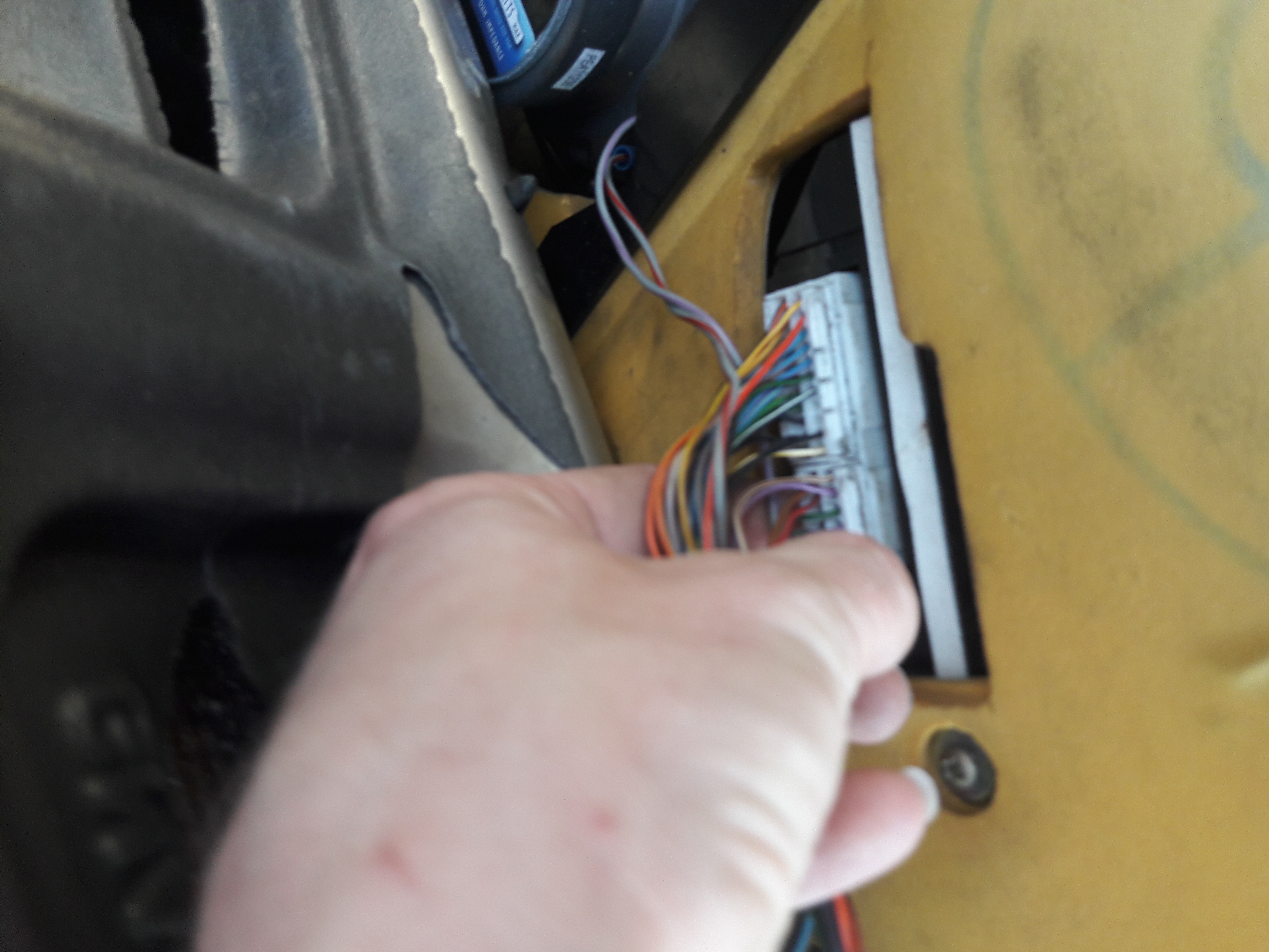

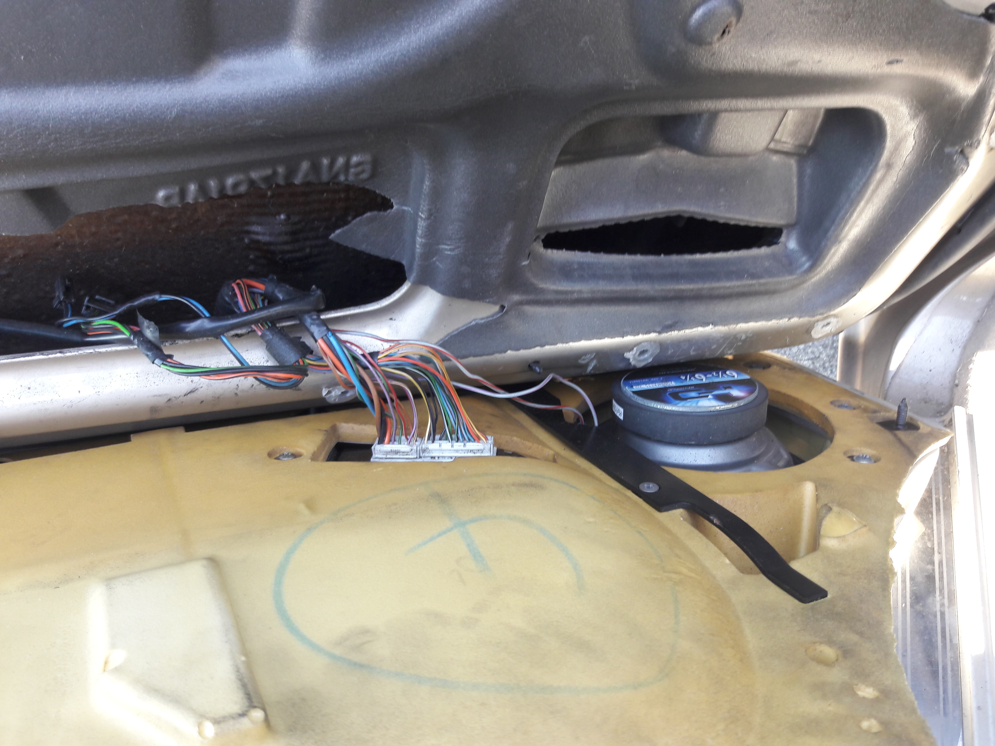

Continue to remove all the connectors
Attached Thumbnails D.I.Y Front Driver Door Micro Switch And Door Cable Repair!-20170428_173539.jpg   D.I.Y Front Driver Door Micro Switch And Door Cable Repair!-20170428_173544.jpg   D.I.Y Front Driver Door Micro Switch And Door Cable Repair!-20170428_173549.jpg   D.I.Y Front Driver Door Micro Switch And Door Cable Repair!-20170428_173555.jpg
Old May 5, 2017 | 11:48 PM
Posts: 313
Likes: 84
From: san jose
I have aftermarket speakers so connector may look differ from yours!
Attached Thumbnails D.I.Y Front Driver Door Micro Switch And Door Cable Repair!-20170428_173600.jpg   D.I.Y Front Driver Door Micro Switch And Door Cable Repair!-20170428_173607.jpg

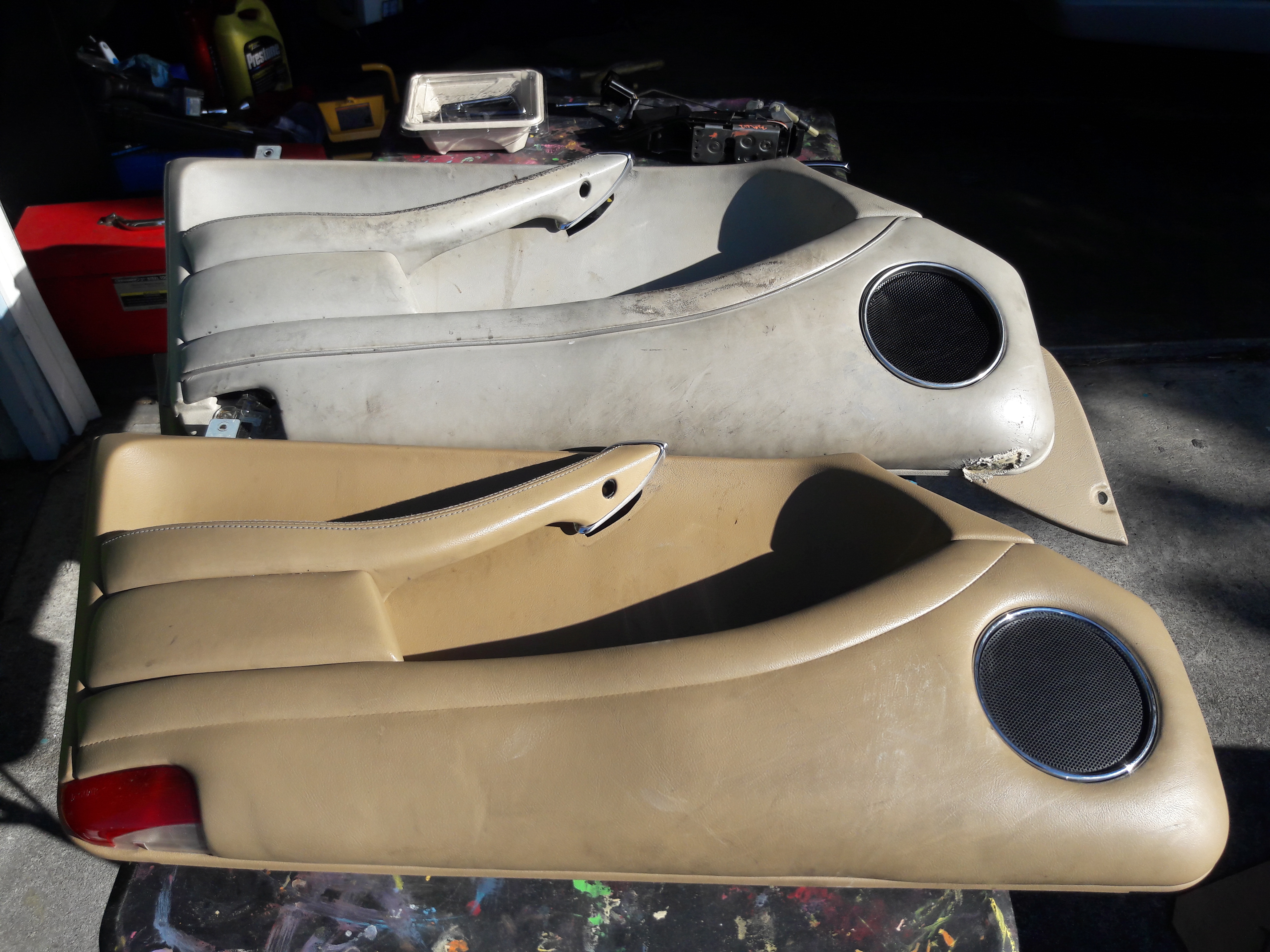

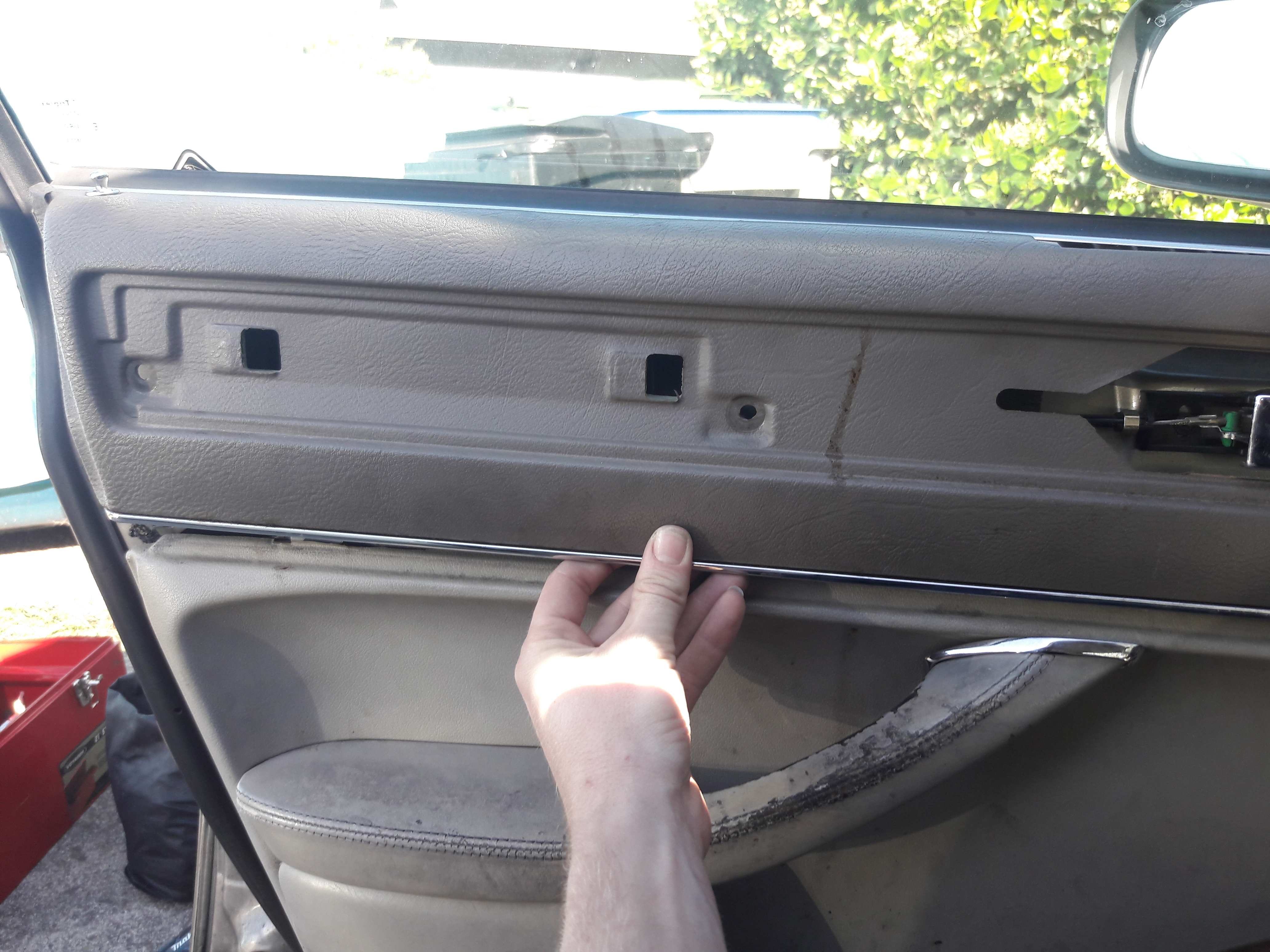

I grabbed used door panel because mine was super messed up
They are completely differ colors but i do not mind
i already have my driver seat replaced with one from a xj6 ( missing the wood tray)
Attached Thumbnails D.I.Y Front Driver Door Micro Switch And Door Cable Repair!-20170428_173636.jpg

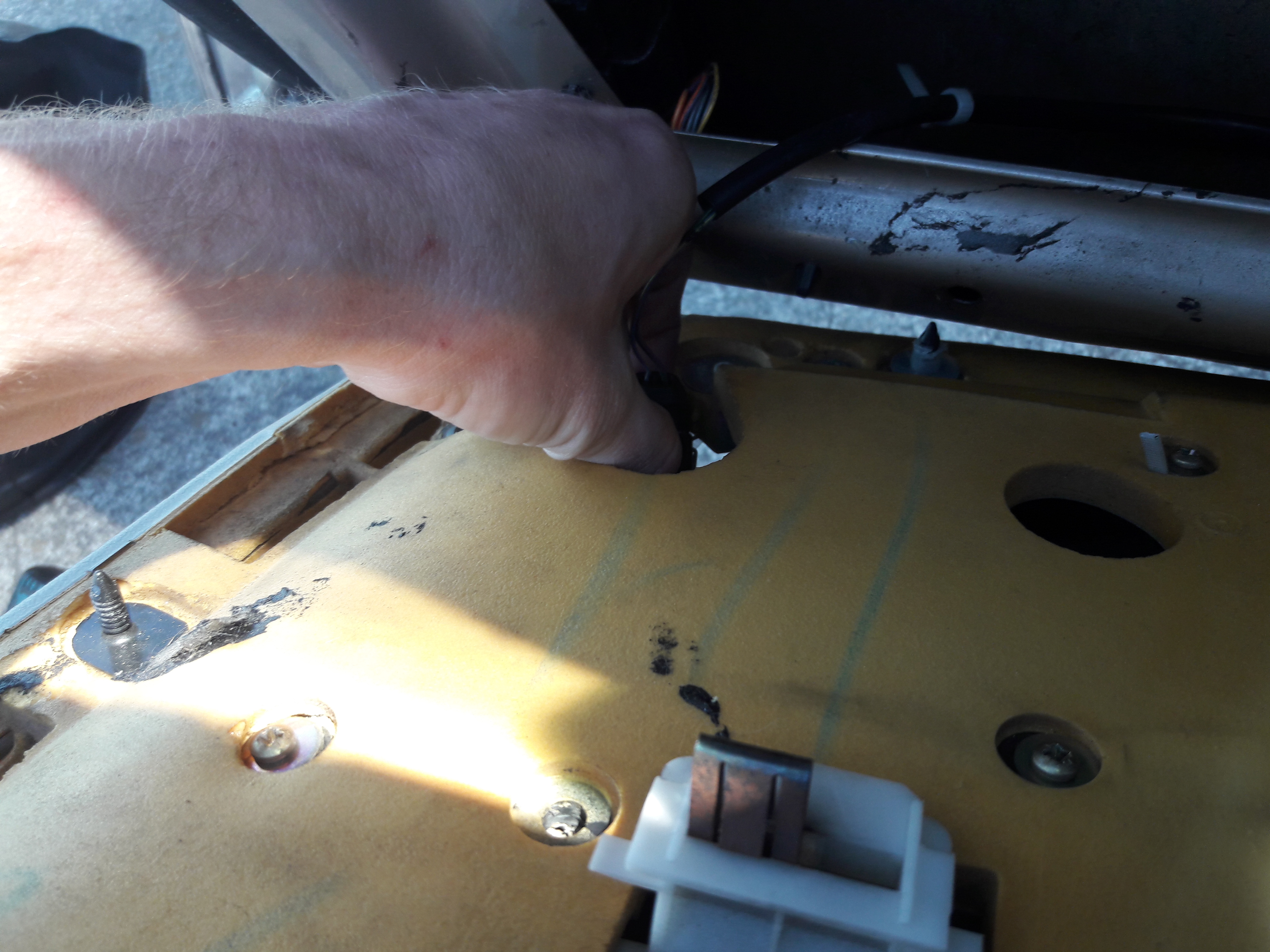

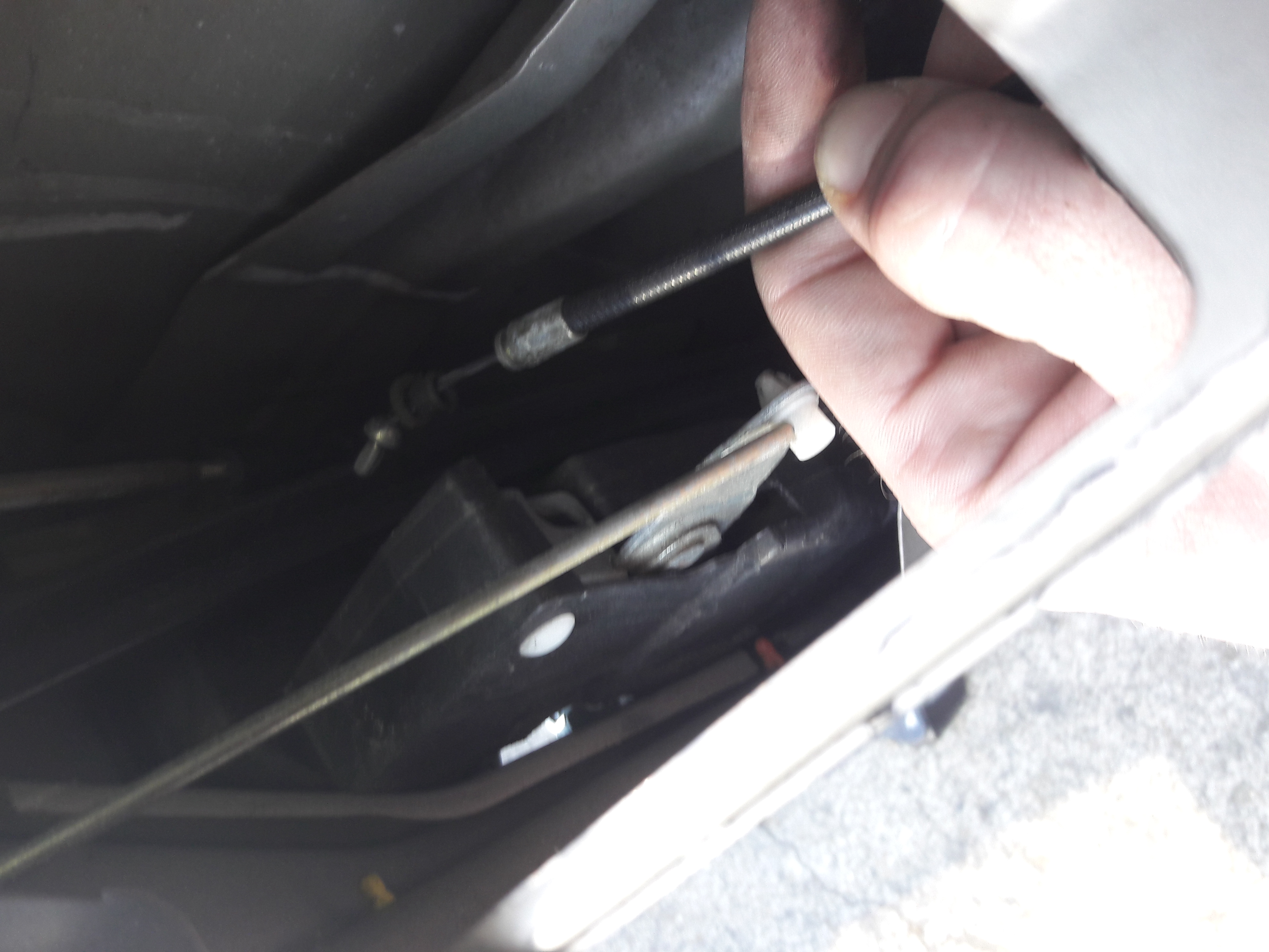

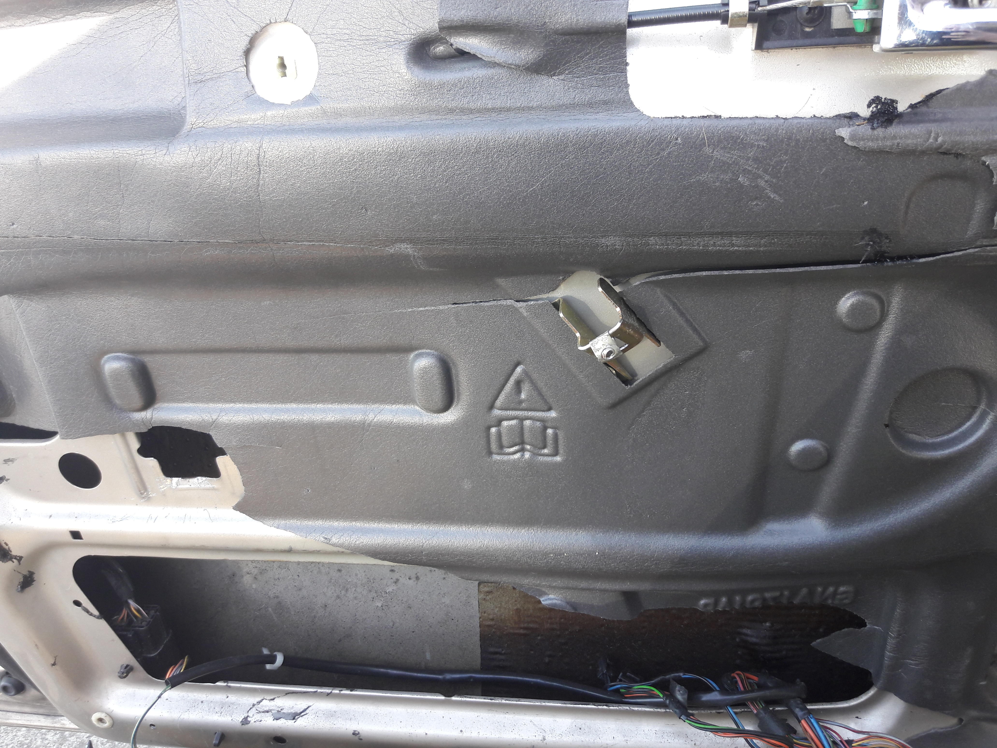

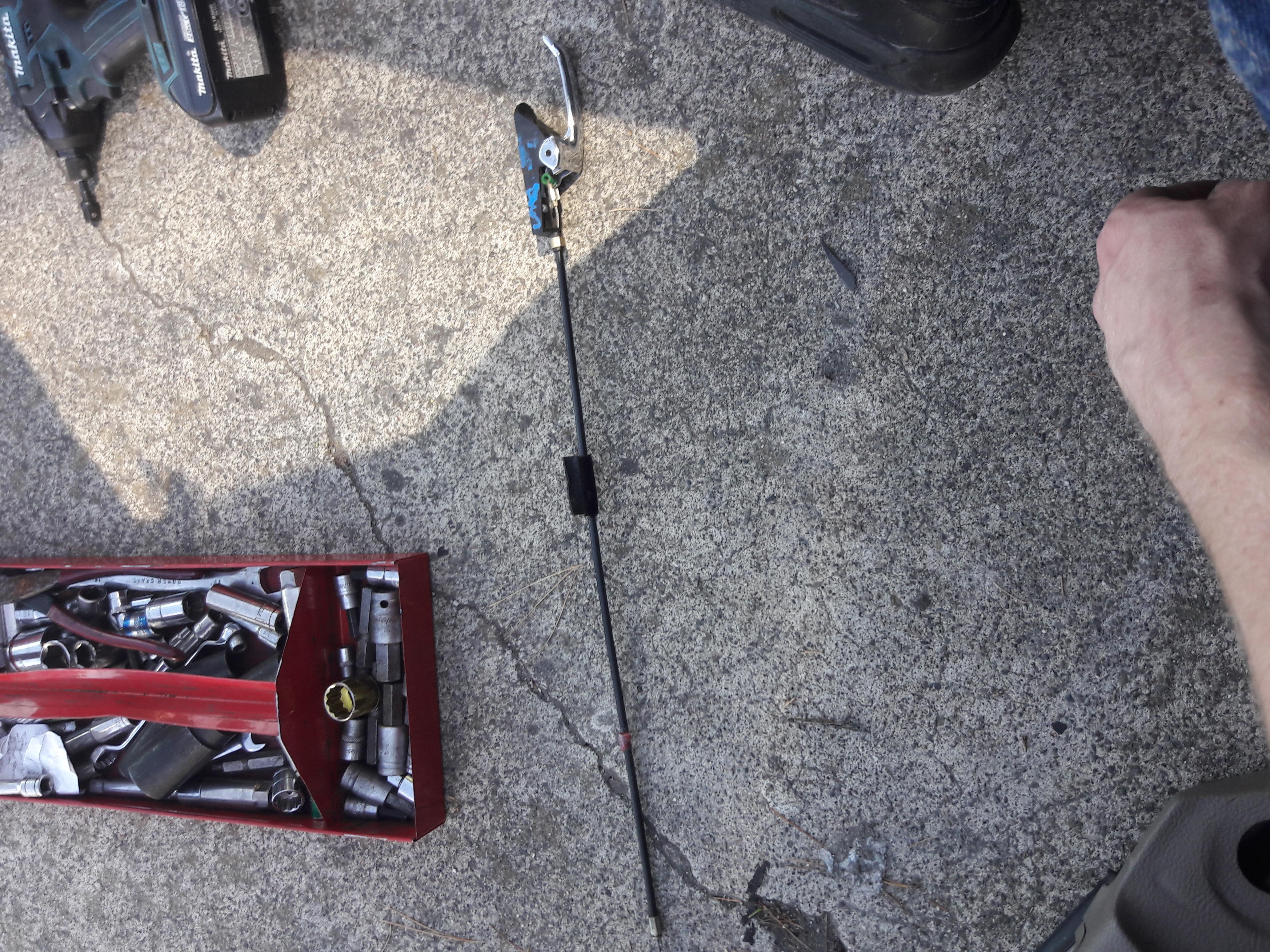

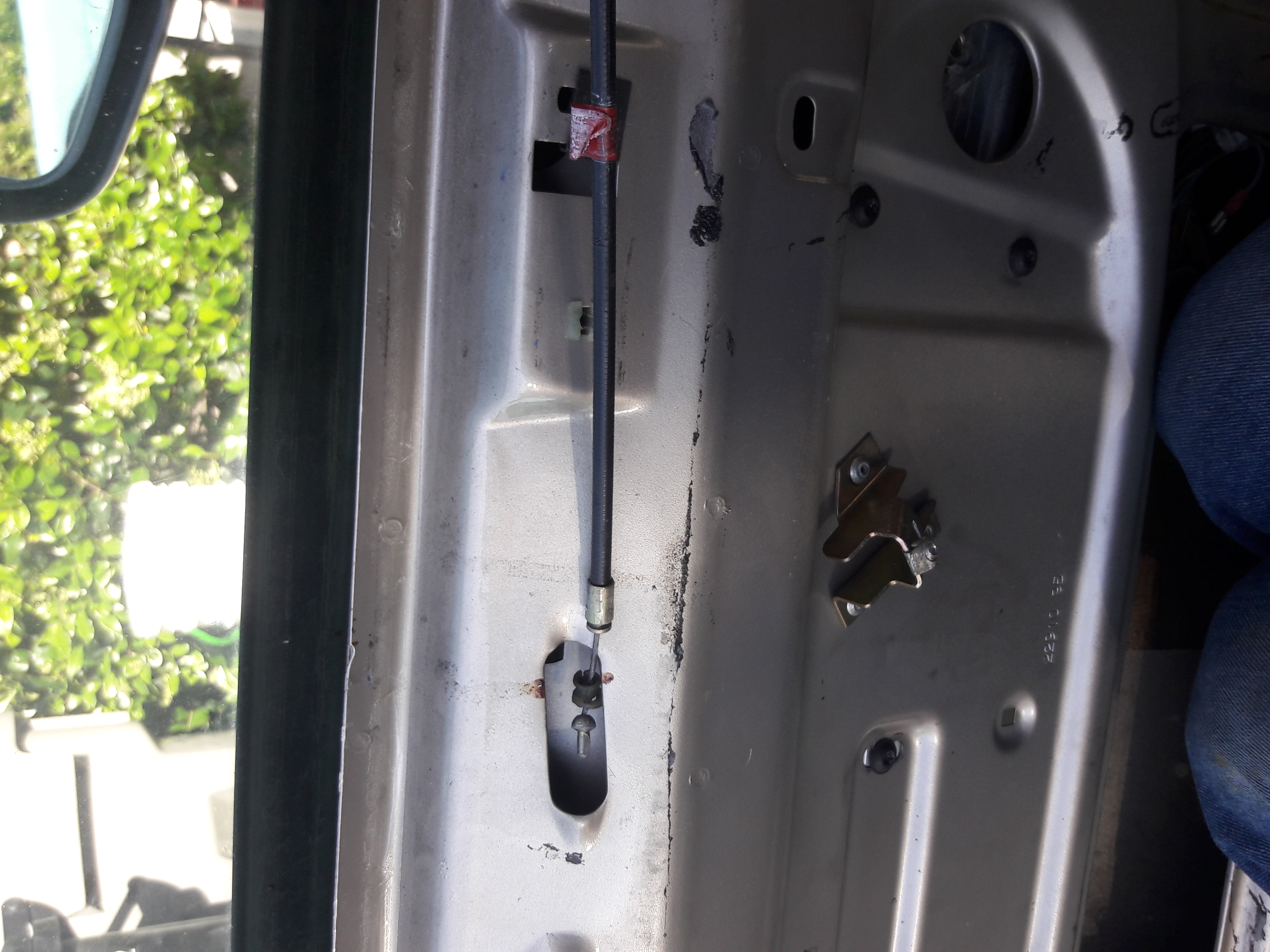

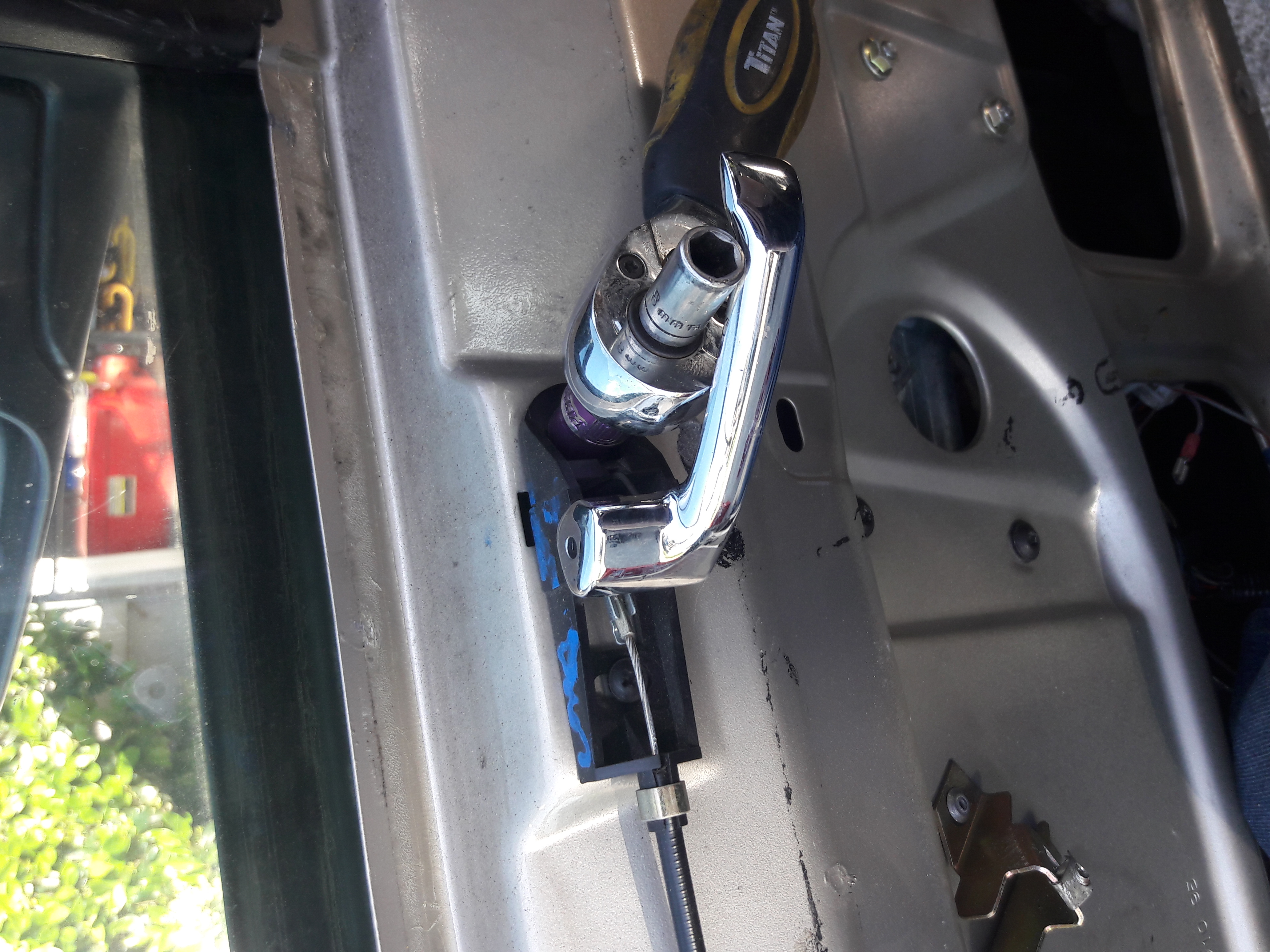

Time to remove the door cable
Reach in the and Unlock the metal tab by lifting up on it ( many times these are missing like mine is in the pic)
once the tab is unlocked wiggle the cable Up and out
Attached Thumbnails D.I.Y Front Driver Door Micro Switch And Door Cable Repair!-20170428_173942.jpg
Old May 5, 2017 | 11:56 PM
Posts: 313
Likes: 84
From: san jose
Use a 10mm socket to remove the bolt holding the door handle
Attached Thumbnails D.I.Y Front Driver Door Micro Switch And Door Cable Repair!-20170428_174028.jpg   D.I.Y Front Driver Door Micro Switch And Door Cable Repair!-20170428_174102.jpg
Old May 5, 2017 | 11:57 PM
Posts: 313
Likes: 84
From: san jose

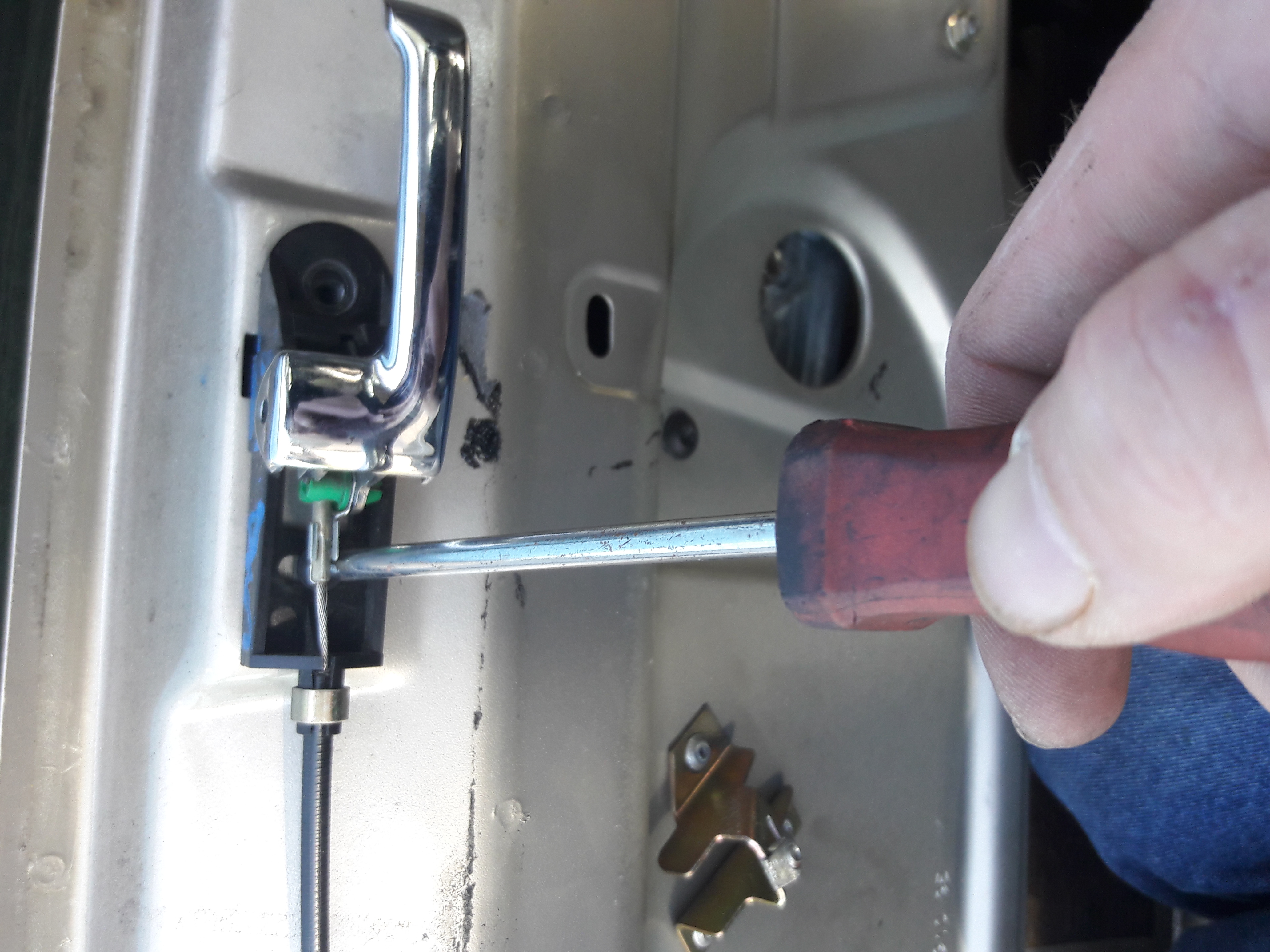

now remove the Phillips screw behind the cable
once the last screw is remove u can pull the cable out
Attached Thumbnails D.I.Y Front Driver Door Micro Switch And Door Cable Repair!-20170428_174114.jpg   D.I.Y Front Driver Door Micro Switch And Door Cable Repair!-20170428_174137.jpg   D.I.Y Front Driver Door Micro Switch And Door Cable Repair!-20170428_174144.jpg

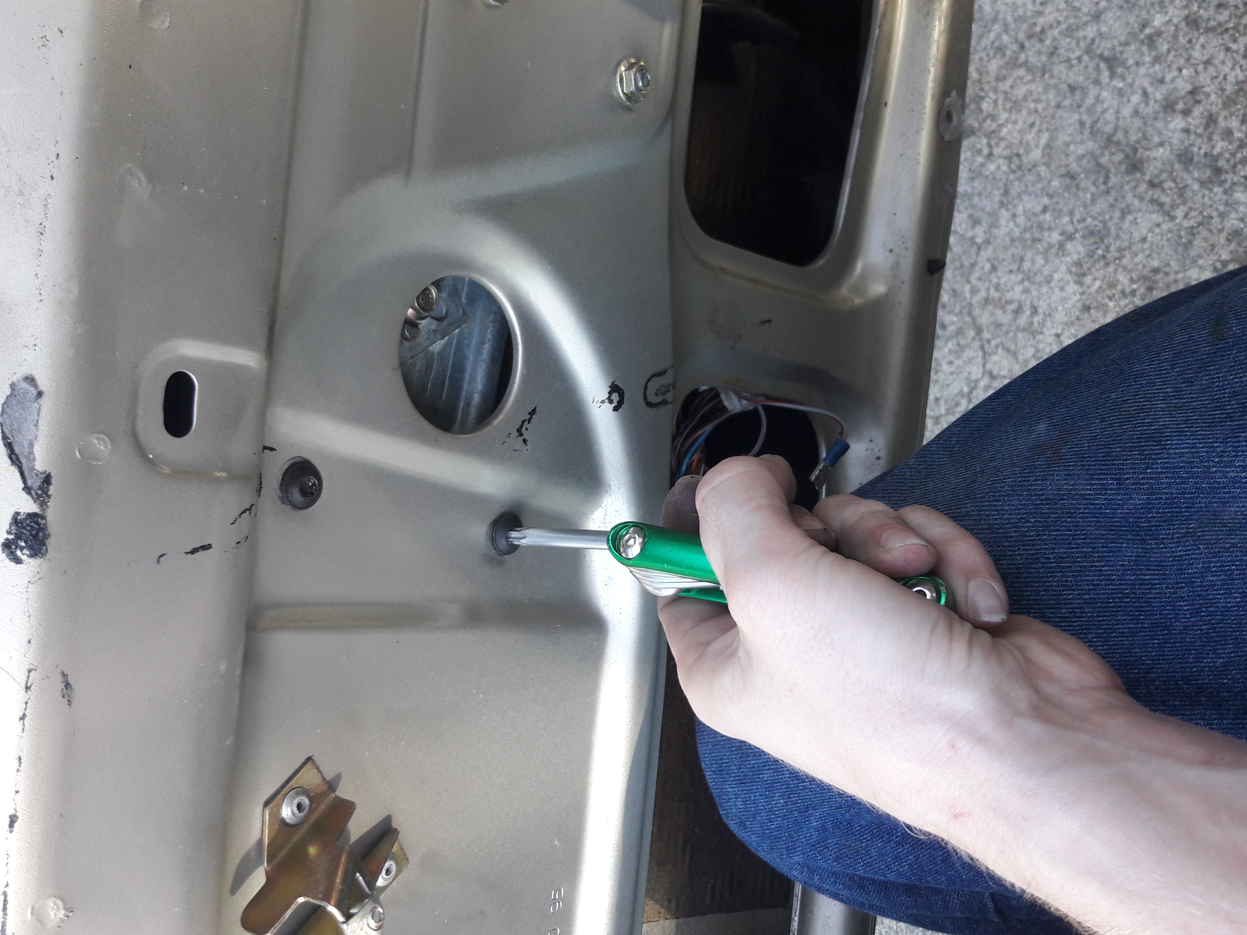

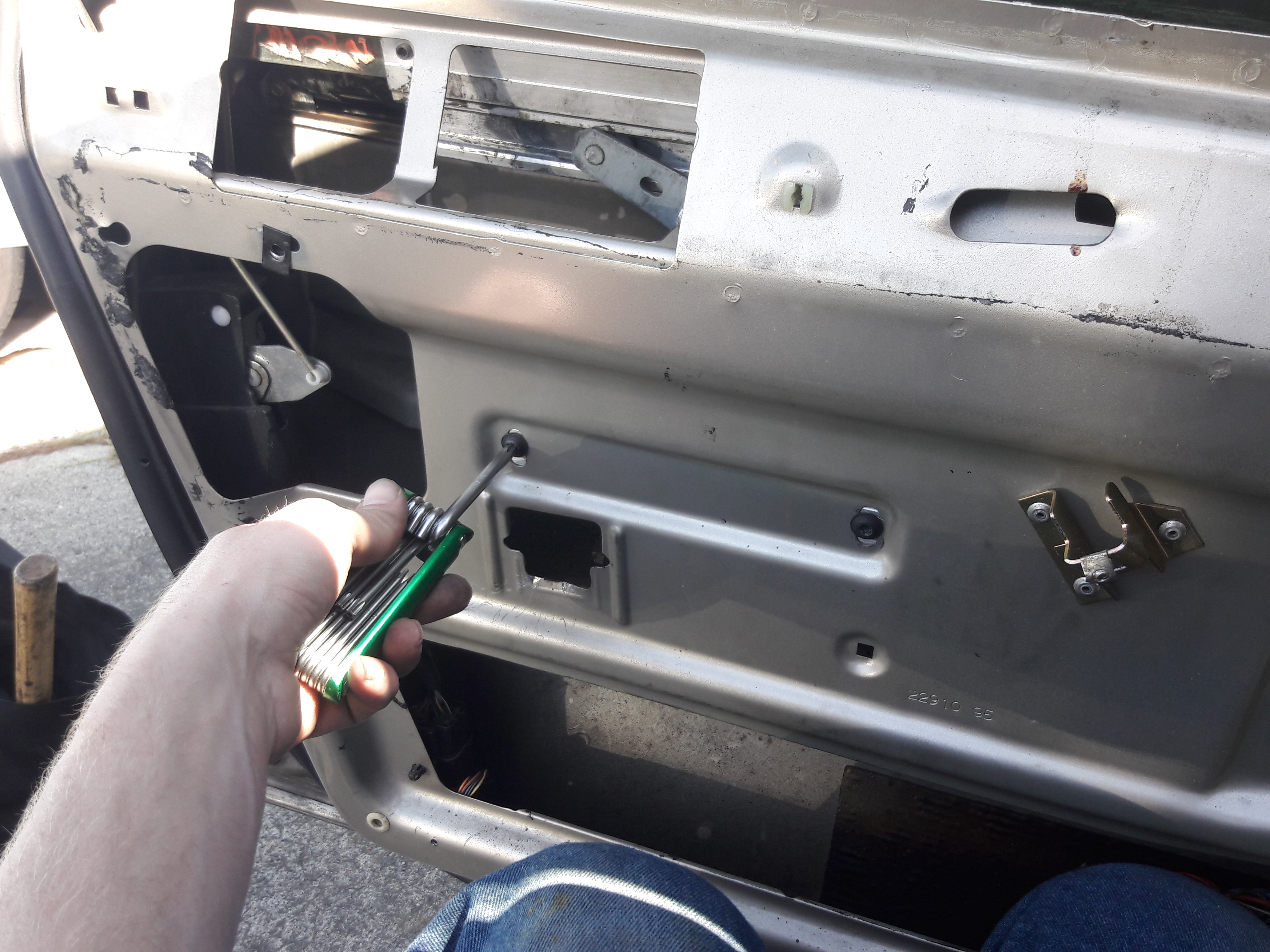

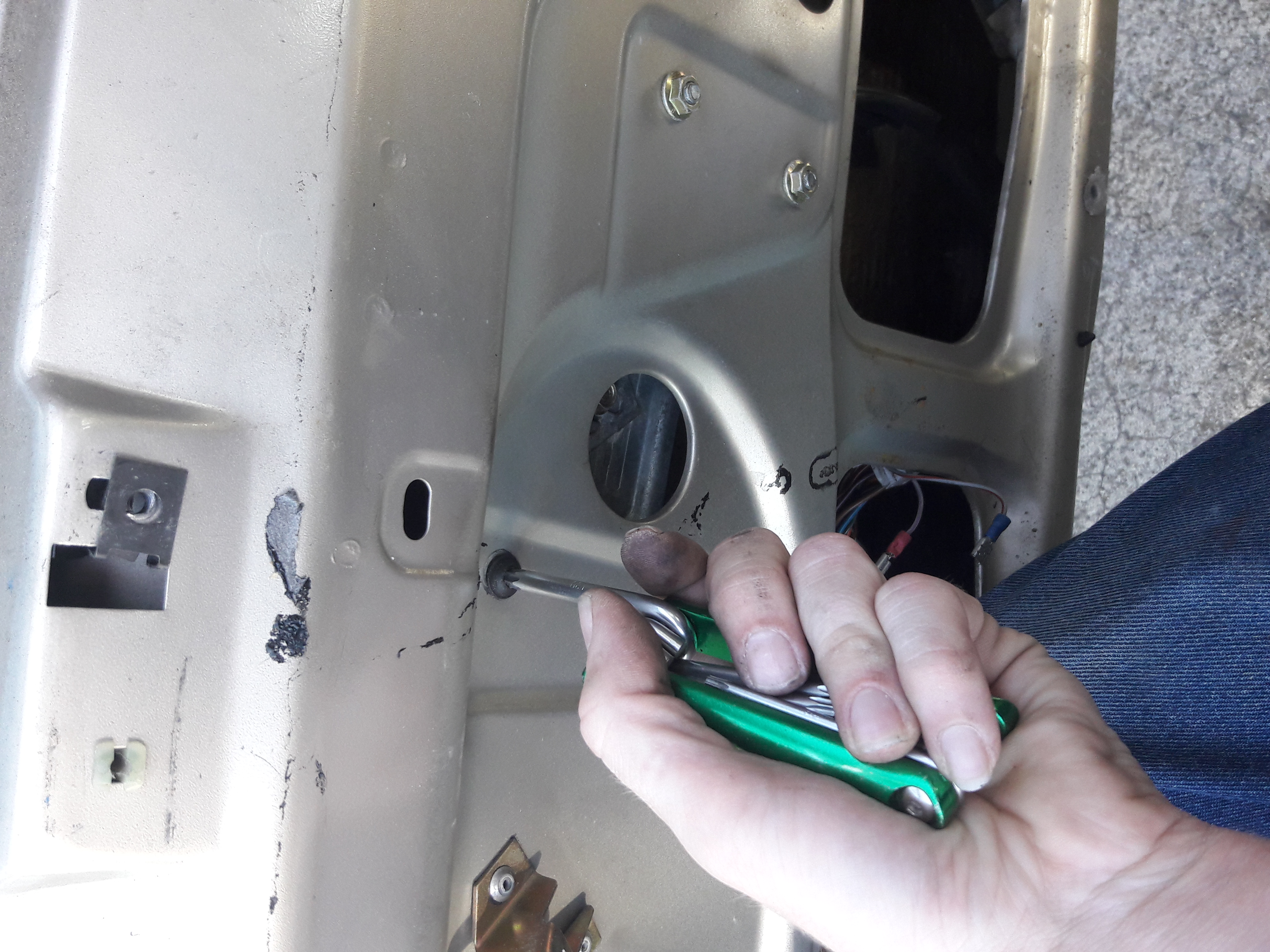

Old May 6, 2017 | 12:02 AM
Posts: 313
Likes: 84
From: san jose
Time to Remove the window regulator and window
Tips
A) make sure the window is half way rolled down
B) Where Gloves for the whole process
C) Have cardboard or soft are to lay glass on
Lets start removing these T 30 Torx screws
Attached Thumbnails D.I.Y Front Driver Door Micro Switch And Door Cable Repair!-20170428_174334.jpg   D.I.Y Front Driver Door Micro Switch And Door Cable Repair!-20170428_174340.jpg   D.I.Y Front Driver Door Micro Switch And Door Cable Repair!-20170428_174319.jpg   D.I.Y Front Driver Door Micro Switch And Door Cable Repair!-20170428_174323.jpg
