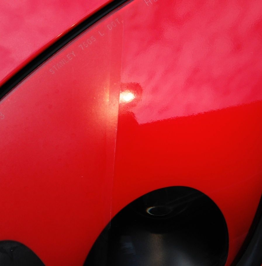

Here are some pics of a friend's 96 Mitsubishi 3000GT that I worked on. The paint was horribly oxidized and dull and there were lots of swirl marks.
As you can see, oxidized, dull paint
Even after washing and claying, look what the paint cleaner pulled off!!
After a polish, I removed the tape and you can clearly see the difference
The finished car, looking way better than it did (even for a mitsu )
