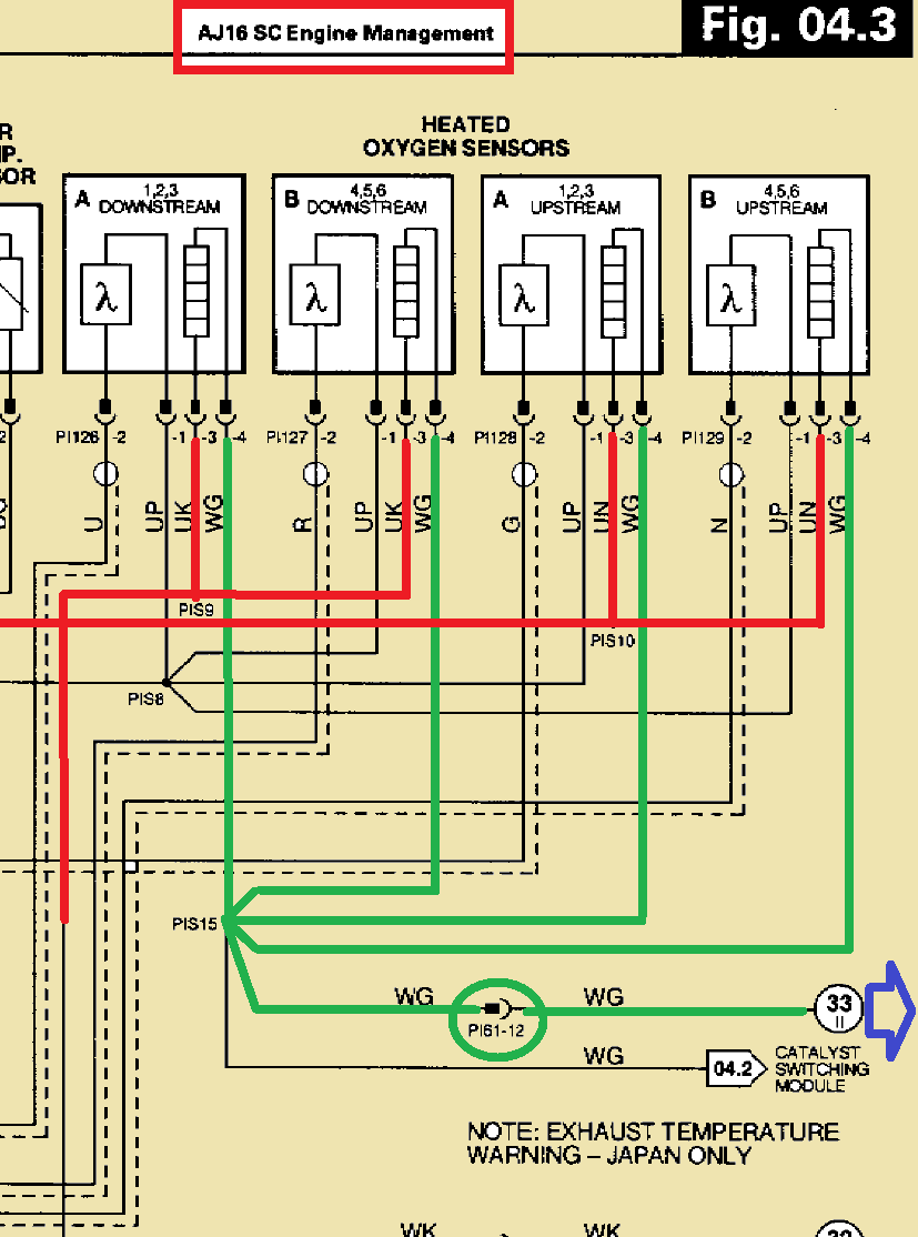

The common denominators to all 4 codes are the one fuse that all power comes from ( Green Wire ) and the Papa Indy 61 connector that gets corroded .
